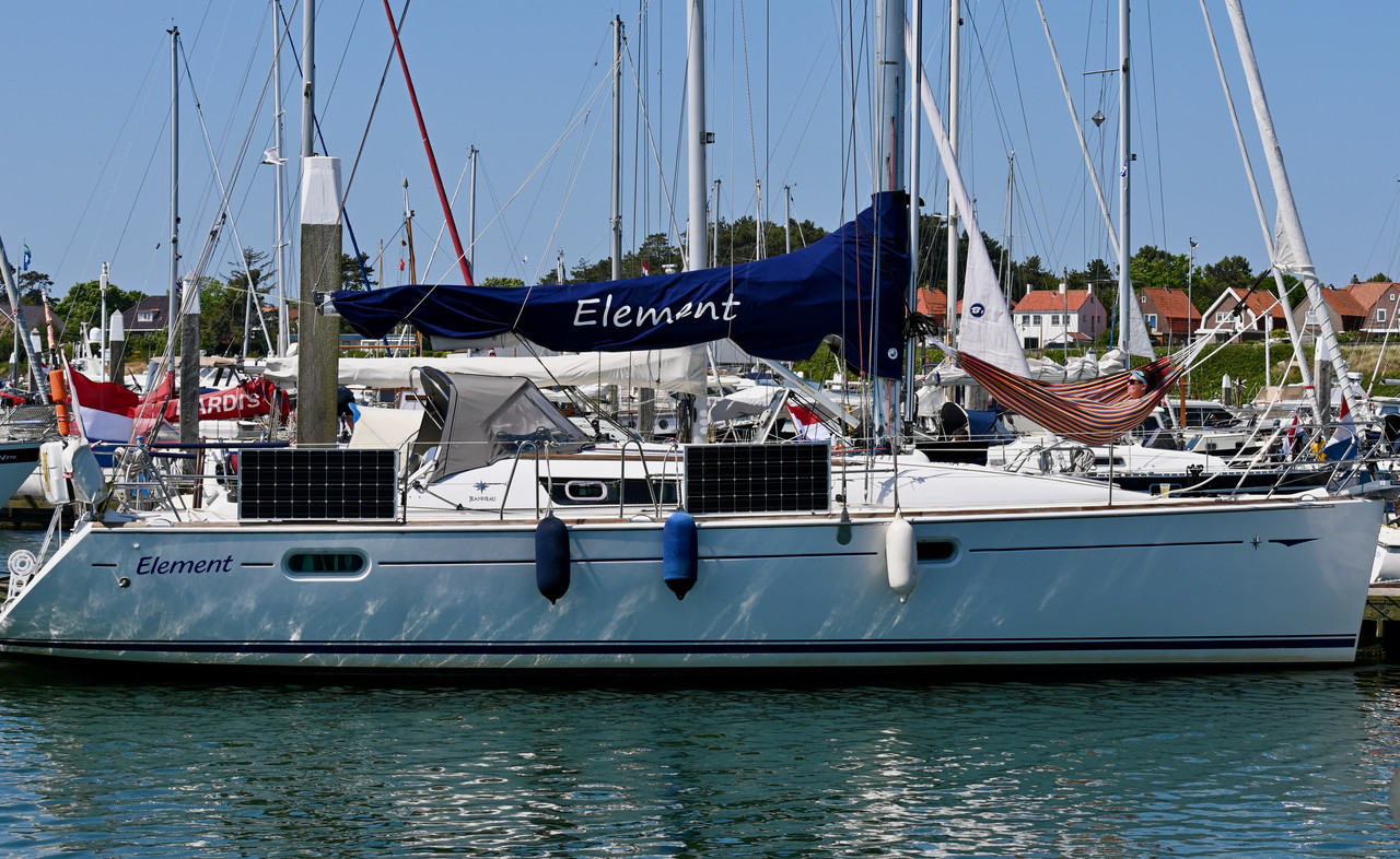

Post by element on Jun 9, 2020 17:22:16 GMT
We own since a few months a 39i Performance and I am in the process of upgrading her/preparing for an Atlantic Crossing over a few years. I may generate a separate thread about the work I have done so far. A 39i is a bit older design and bigger than a 379 but roughly comparable with a 379. So very nice and interesting to share experiences! By the way, I noticed that a 39i completed last year's ARC. Regarding power management, I have installed now 500 watt solar. 60 watts on the sprayhood and 4x110 watts on panels at the side. This can be rotated to catch the most sun. I think this should be enough, but I might install some flexible panels on the bimini as soon as this one is installed. Especially because there is a big chance that some panels will be in the shade. I think more important will be more battery capacity. I have also 3x110Ah. Stil doubting to add more lead acids or bite the bullit and migrate to lithium. On my to-do list is definitely to mount some handholds inside. But I'd like to sail first a few times in choppy water to figure out the right location. Some of the other thing I already have done is upgrading the anchor equipment and installed a removable inner forestay with a heavy weather working jib and storm jib.

Post by element on Jun 11, 2020 17:37:49 GMT
We own since a few month a 39i Performance and I am in the process of upgrading her/preparing for an Atlantic Crossing over a few years. I may generate a separate thread about the work I have done so far..... The extra inner forestay seems like a must-do in order to add a storm jib solution. Was it difficult to install? Have you added any water making solutions to your yacht? This is something I keep thinking about. I must say, I'm quite taken with the Rainman portable solution... Thank you again! PJ Hi PJ, In this tread you can find a description of the inner forestay: click
And I am indeed planning installing a water maker. I have already bought a Schenker Zen, but still have to install it. One of the many things on the to-do list..... Cheers, Harald
