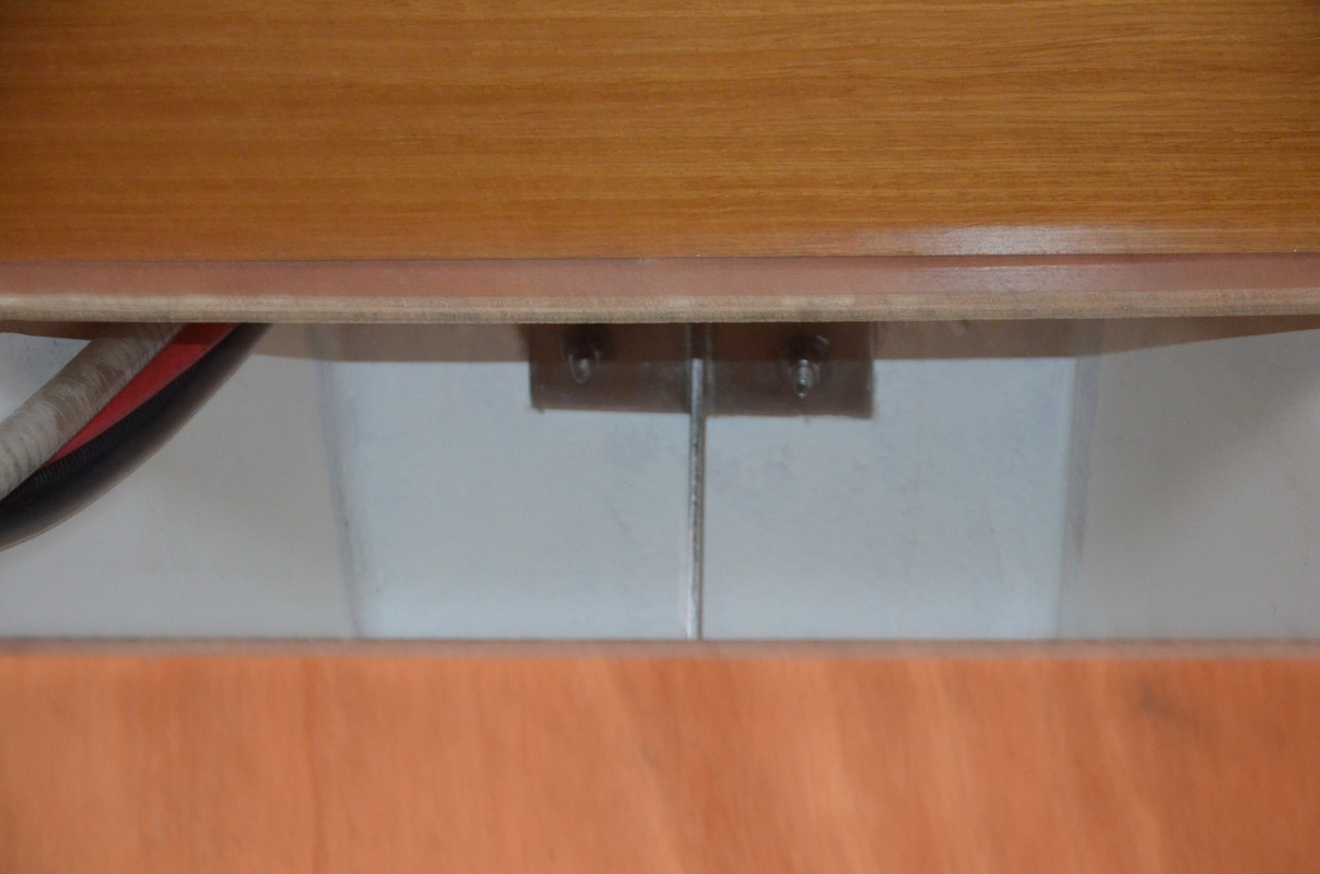

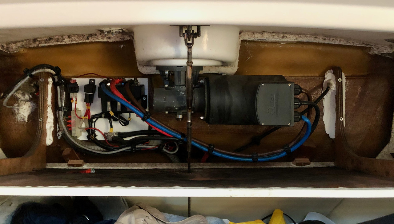

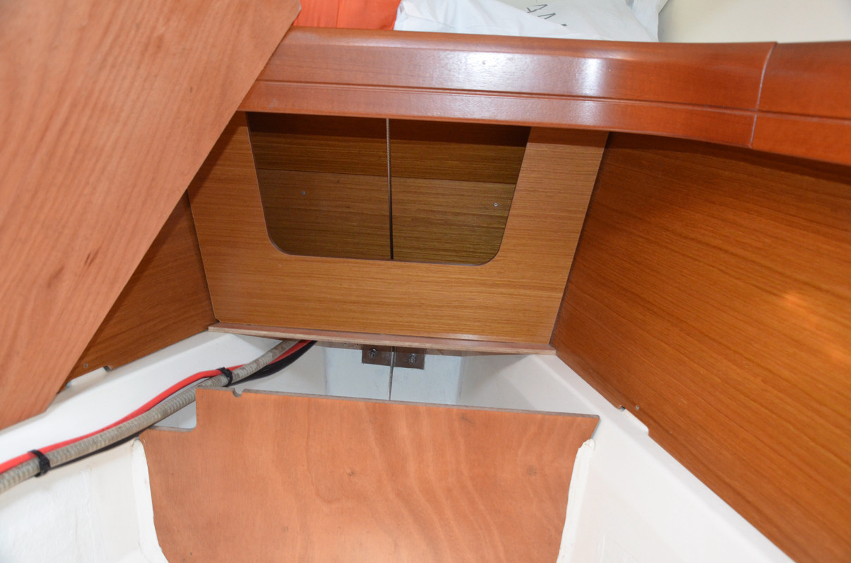

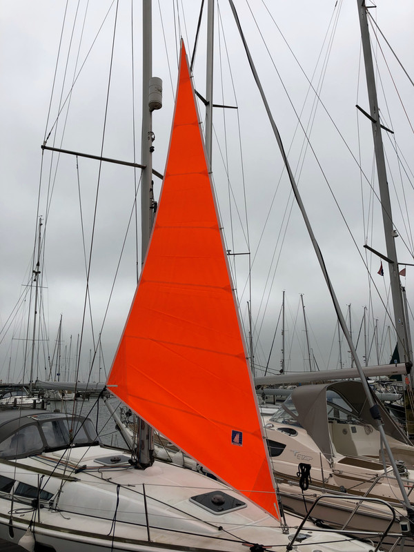

I have installed a removable inner forestay on my 39i Performance: To tighten the stay can be done effectively with a dedicated Wichard tensioner: The load of this stay is under deck transferred by this to a bulkhead and hull: Note that in the picture above the panel to acces the anchor winch is removed. So normally you will not see this. Finally the force of the stay is transferred to a bulkhead, which is strengthened and laminated to the hull.

1) how you have attached the removable fore stay to the mast? 2). I have a similar positioned strong point on the foredeck, but need to check positioning of the anchor well bulkhead or similar underneath to spread the load. I wonder if it would be strong enough as is? 3) I have a 2:1 code 0 halyard. I wonder if that would suffice to hoist a storm jib with inbuilt luff wire similar to the code 0. 4) It looks like you have removed the standard jib from its track on the fore stay? Have you used storm jib with the standard jib furled, and if so did you change over the standard jib sheets to the storm jib?

Hi Garry, We only have our 39i for a couple of months and did not sail much last months (really a lot of wind here in the Netherlands past weeks). Also, except of the inner forestay and tensioner, all was already installed on our boat when we bought her. So I will not be able to answer all your questions completely but I will give it a try. 1) the fitting in the mast was already there, I do believe however that this is a standard solution of Selden, the rig manufacturer. I am sure that your local rigger can advise you about that. 2) the stay below deck is attached to a small bulkhead. This attachment is also strengthened by a bracket which is laminated to the bottom side of the hull. I don’t have good pictures of that yet but these will give you an idea Here a bit more detailed picture. If needed I can make better pictures: This was as well already done by the previous owner. When we bought the boat I have asked our surveyor to double check if the construction was strong enough. He had no doubts about that. 3) I doubt that a 2:1 halyard can put the same pre-tension on the stay/wire in the sail as the Wichard tensioner. But I guess there is no harm in trying first. Personally I like the Wichard very much (had it on my previous boat as well) because it is strong and ensures, combined with the hanks on the strom jib, that the luff stays straight and the sail has excellent upwind capabilities. My sailmaker will deliver as well a heavy weather jib for the inner forestay soon. This sail is about twice the size of the storm jib and will work fine, also upwind, in 6 to 8 Beaufort. I don’t like sailing upwind with a furled headlsail. So for longer trips with more wind I am used to rig the a working jib. I hope never to use the storm jib but I expect I will use the working jib a few times per year. 4) the standard jib was only removed because it is winter and I also did not have a cover yet. Normally I will use the inner forestay with the standard jib still furled. I guess you ask this because you understand that is one of the biggest benefits of an inner forestay; you don’t have to remove the standard jib in heavy weather whilst underway. On my previous boat I used a second pair of sheets. The normal sheets can stay on but to prevent that these become strangled (not sure if this is the right English word for it), I prefer to remove the sheets of the normal jib. You have then to secure the furled sail with an elastic ball sail tie to prevent it will roll out. Hope this helps, Harald

I we logged more than 20.000 miles in 10 years with our previous boat (an Etap 34s). I never had to use the storm sails. There have heen however multiple occasions where I was more than happy with the working jib on the inner forestay. Sailing upwind between 20 and 35 knots it is so much better than a partially furled genua. The boat sailed higher, with less hell and faster than with a partly roll-reefed genua.
So the possibility of a flat working jib with hanks is the main reason to install also on our Jeanneau an inner forestay. I expect to use for 99%with the working jib and hopefully less than 1% of the miles with the storm jib.
I will get the working jib for the SO39i Performance next week. I am anxious to use it. The Performance edition has quite a tall/powerful rig and we have a lot of wind during wintertime here in the Netherlands.
