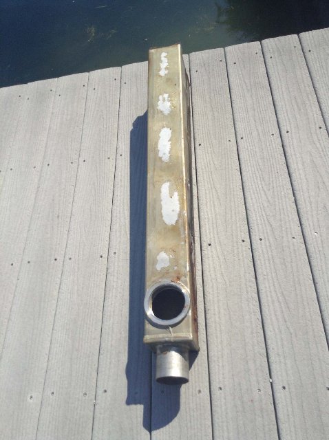

Post by dknebes on Oct 13, 2013 19:32:10 GMT
Thanks for the response Malcolm, I will try locally we have some good fabricators. I am also looking into a centek inline water muffler placed under the aft bunk, my only concern is the water left in the exhaust hose from the muffler to the engine about 4 ft down hill but about 18 inches from the 90 deg to the turbo. Jeanneau is saying because the boat we purchased had low engine hours 400hrs it may have sat for extended periods and not fully warmed up when it ran possibly causing the corrosion. Jeanneau now uses fiberglass. I am open to all suggestions. Thanks, Dave

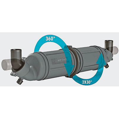

Post by dknebes on Oct 13, 2013 20:48:17 GMT
Ok, did some research and think the Vetus NPLH75 water lock muffler should work, it hold 10 liters of water and can be bought from defender for $197.00. I would still like some feedback on how much water will feedback from the muffler to the engine aprox 4 ft, I was told that there is 25% water mixed with exhaust. Attachment DeletedDave

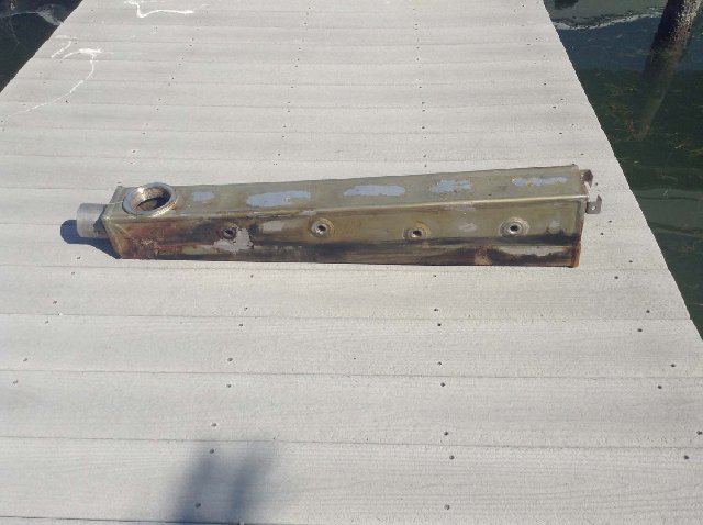

Post by dknebes on Oct 17, 2013 21:11:01 GMT
Yep, that's it and I have the 75hp Yanmar. Take a look from the front side and see if it has any rust on it, if I does like mine it is only a matter of time. I found a local fabricator in St. Petersburg fl that said mine was beyond repair and will make a new one for $1200.00 not inexpensive but better than Jeanneau at $1600 plus freight and tax. I have asked to make it out of a better grade of stainless and improve on the design if possible.
I had to remove the fuel tank to remove the muffler, I could not do it any other way because the muffler is so long it will not make the bend to lift it out, if you have a SO43DS the tank the two floor boards that run the length of the main cabin have to be removed.

Post by rxc on Oct 18, 2013 12:31:13 GMT
Hmmm... I am definitely going to have to have a closer look at my muffler, because it seems to me to be relatively small, and probably plastic, not SS. Is that long thing in your photo embedded in the engine mount stringer?

Post by dknebes on Oct 18, 2013 17:44:46 GMT
Hmmm... I am definitely going to have to have a closer look at my muffler, because it seems to me to be relatively small, and probably plastic, not SS. Is that long thing in your photo embedded in the engine mount stringer? Yes that is the water muffler. Dave
