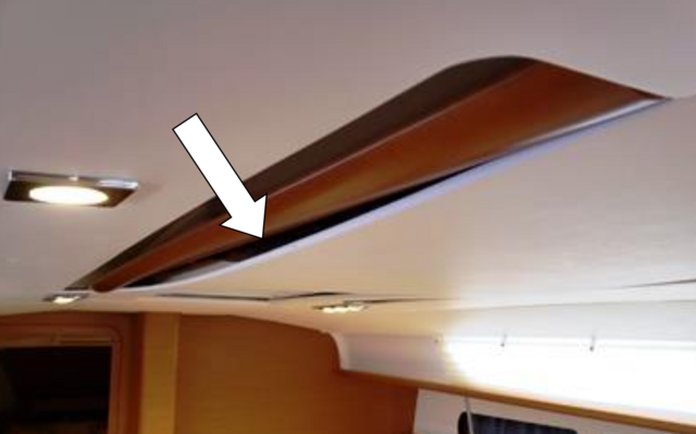

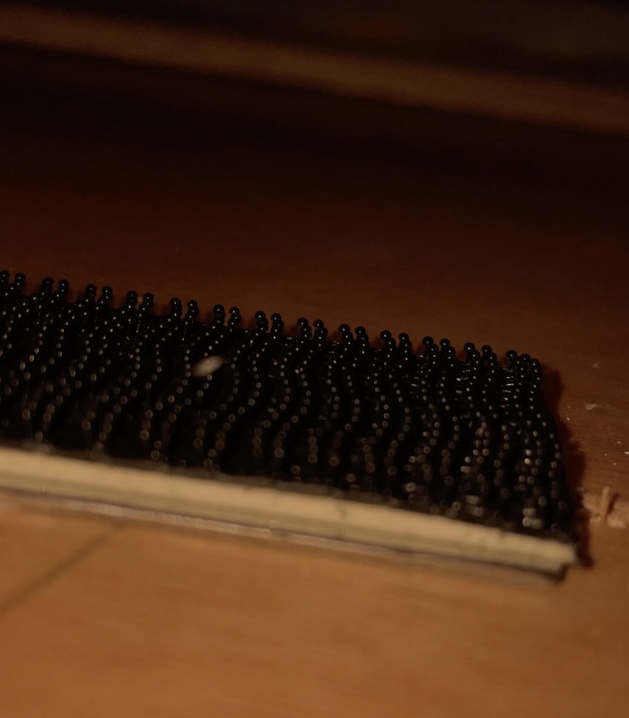

SOLVED! Thanks to kelowa I decided to try to see if my SO469 was velcro also. I scared the nuts out of myself when I pulled and pulled and it seemed really form then all of a sudden went "POP!". I thought I had ripped a screw out, it was that form. I was able to get my camera in there to peek around and I found it is indeed some kind of super industrial velcro recessed into pockets. If you pull evenly it will eventually pop then the others are easier. I did not however to get it to re-attach you have to press the decliner up and fund it with your fist. Pushing alone will not do it. please understand - I am NOT telling you to do this nor am I responsible if your boat is different. All I can say is on my 2013 Sun Odyssey 469 this is how MY headliner is held on. Here's a couple of screenshots from the little video I took:   Sorry the bottom one is no good, but I included it because it shows the top velcro also. Hope this helps someone along the way. Cheers, David
