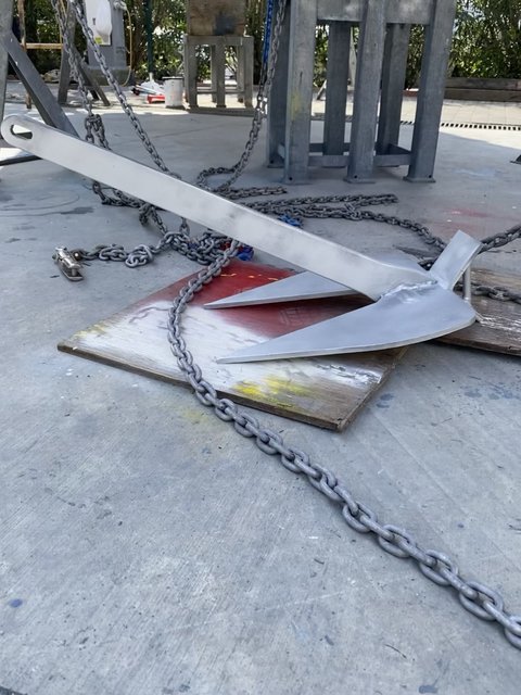

Post by ihsan on Apr 30, 2021 22:48:14 GMT
This may help. The factory installed anchor in 795 is 12 kg. with a moveable arm. Some friends who complained about the anchor not holding well enough in strong wheather chose to weld the moving arm from its base to the Wings. This creates a fixed angle about 30 degrees. They say they are happy with the performance now. This seems an economic solution and I am going to try. But dont forget to put a swivel after the chain if you dont have one.

Post by ihsan on May 1, 2021 14:46:02 GMT
 Welded original anchor 12 kg. 795. It positions itself perfectly to its place. References are satisfactory, but I have not tried myself at sea.
Post by westboating on Jun 1, 2021 21:10:30 GMT
did you weld the flukes in place?

Post by westboating on Jun 4, 2021 0:14:31 GMT
I was wondering why the shank was sticking up in your picture. I thought it would lay flat as the flukes move. What needed welding? And more importantly what anchor are you planning as primary?

[quote author=" westboating" source="/post/60193/thread" t imestamp="1622765671"]I was wondering why the shank was sticking up in your picture. I thought it would lay flat as the flukes move. What needed welding? And more importantly what anchor are you planning as primary? [/quote][ I I did not post the picture. I believe Ihsan did. As for the primary, I am looking at a Delta or Vulcan. Have not decided yet since I am not sure how they would fit. Hence my original post asking if anybody had any experience with a different anchor.
