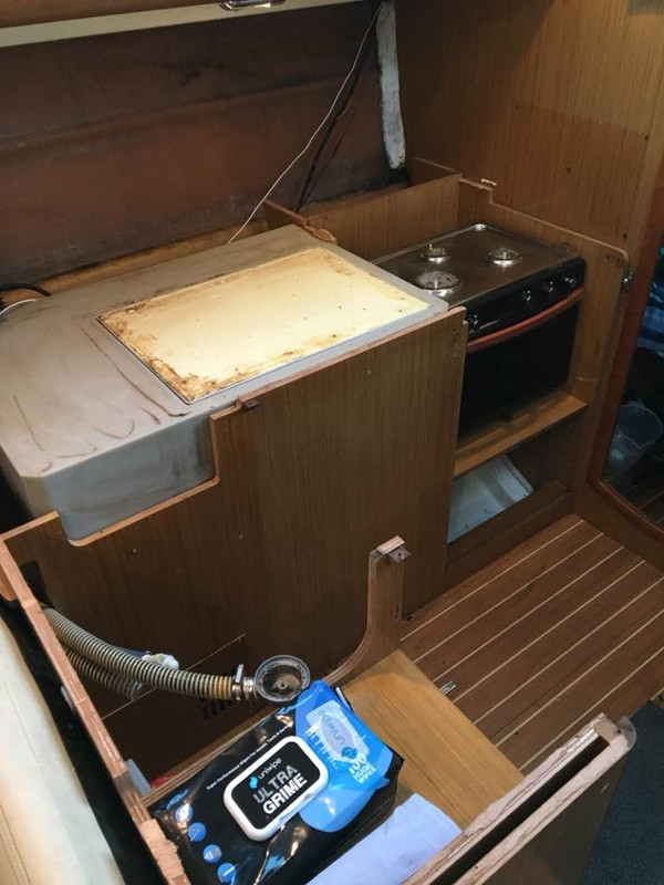

I have separate side by side freezer and refridgerator/freezer. I want to add additional insulation to both. My first choice is to access all sides and glue in sheets of closed cell foam. But access is hard for me to figure out. It looks like I can remove the stove/oven to access most of the refridgerator but the hull side of fridge and freezer are the problems as well as the salon side of the freezer. I started to remove various wood panels at the Nav station area but didn’t make much progress toward what I need. My plan “B” is to drill one or two small access holes and spray in some insulating foam. I can plug the holes with something like a stainless cap if wood area and some white stuff if I need to drill a hole through the counter top. Anyone have any ideas or success stories? How much should it help reduce electricity draw? Any suggestions on best way to access the hull sides of these boxes? Sorry no pictures available together now.

Post by moonshadow on Apr 8, 2020 14:58:41 GMT
