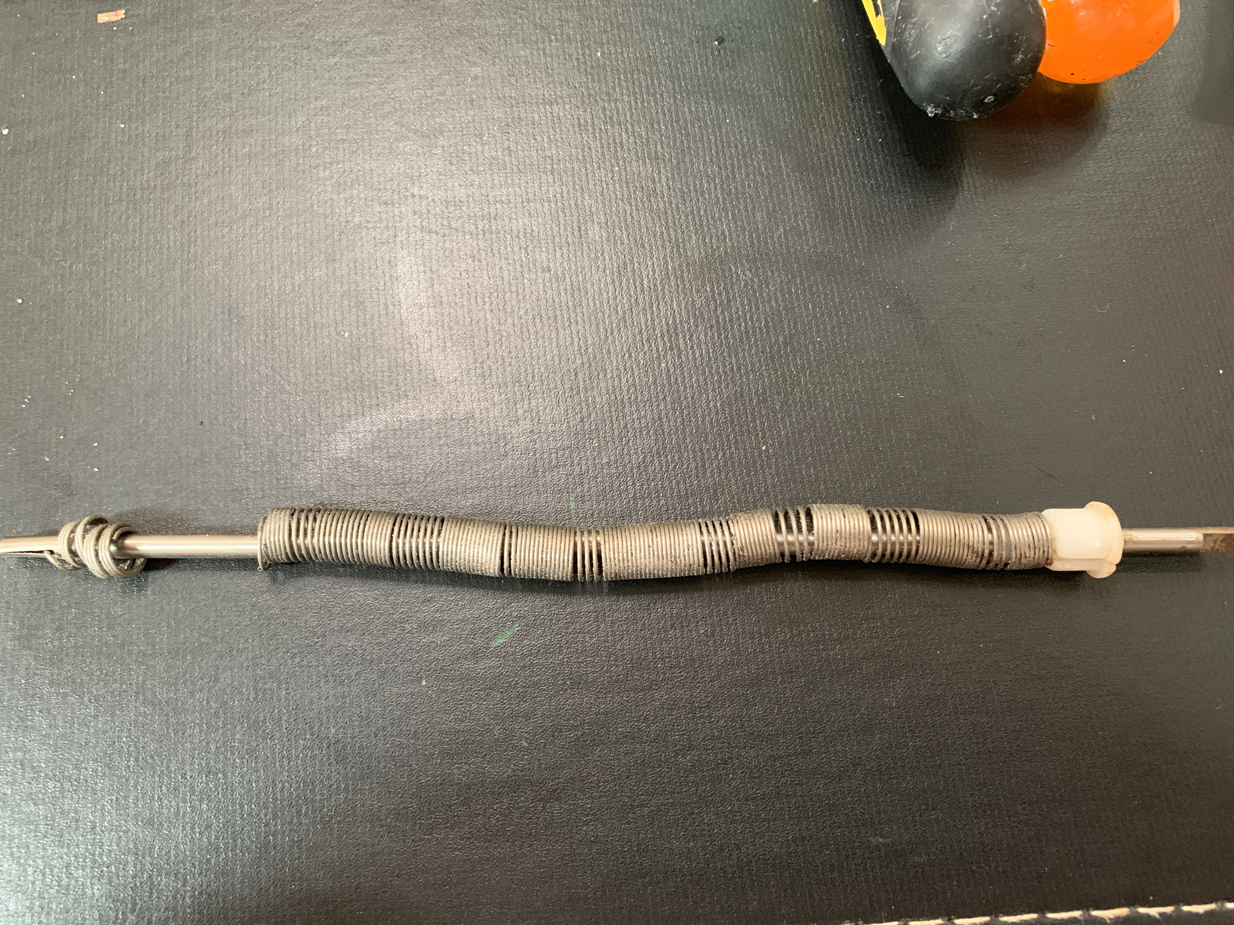

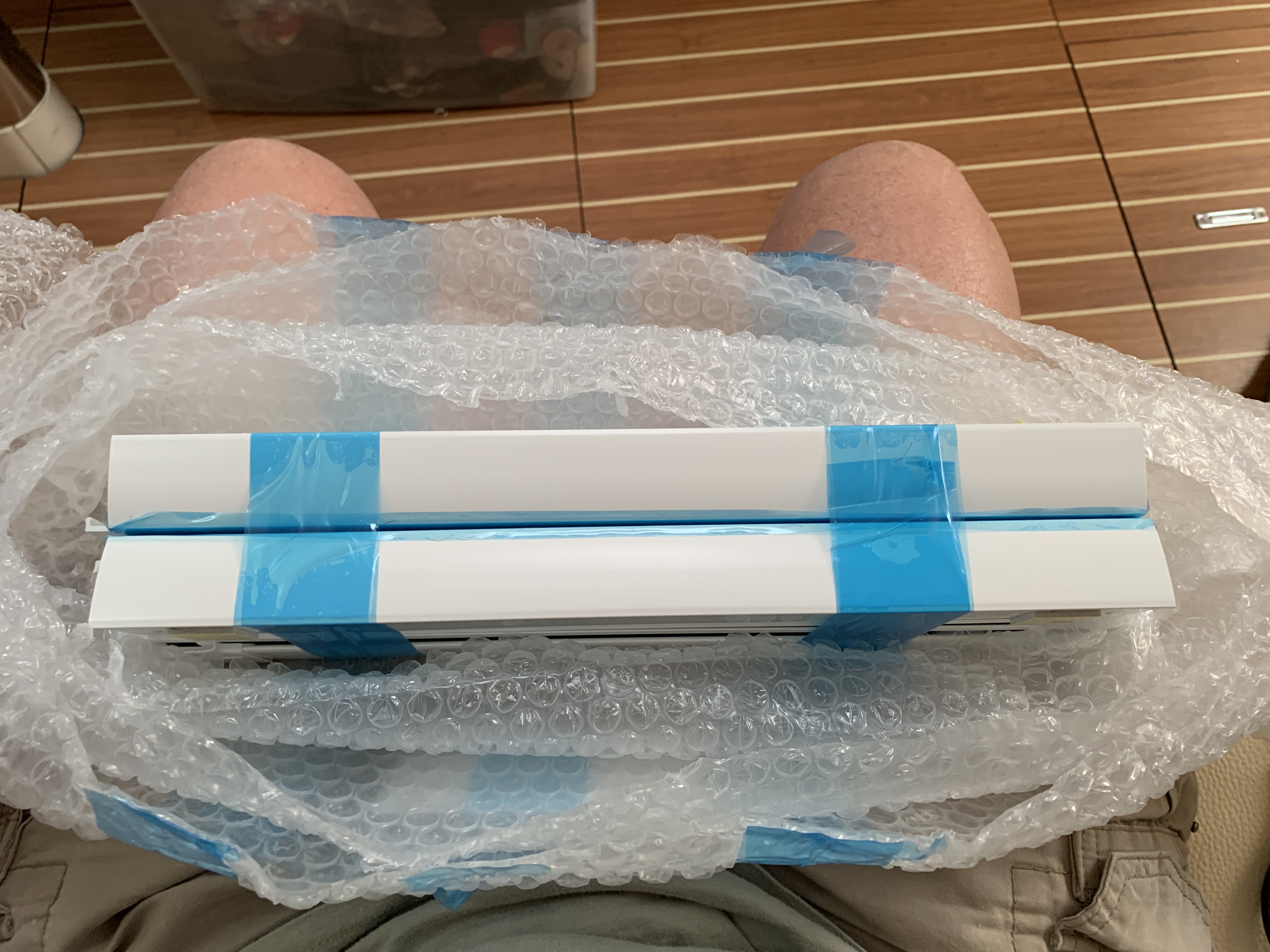

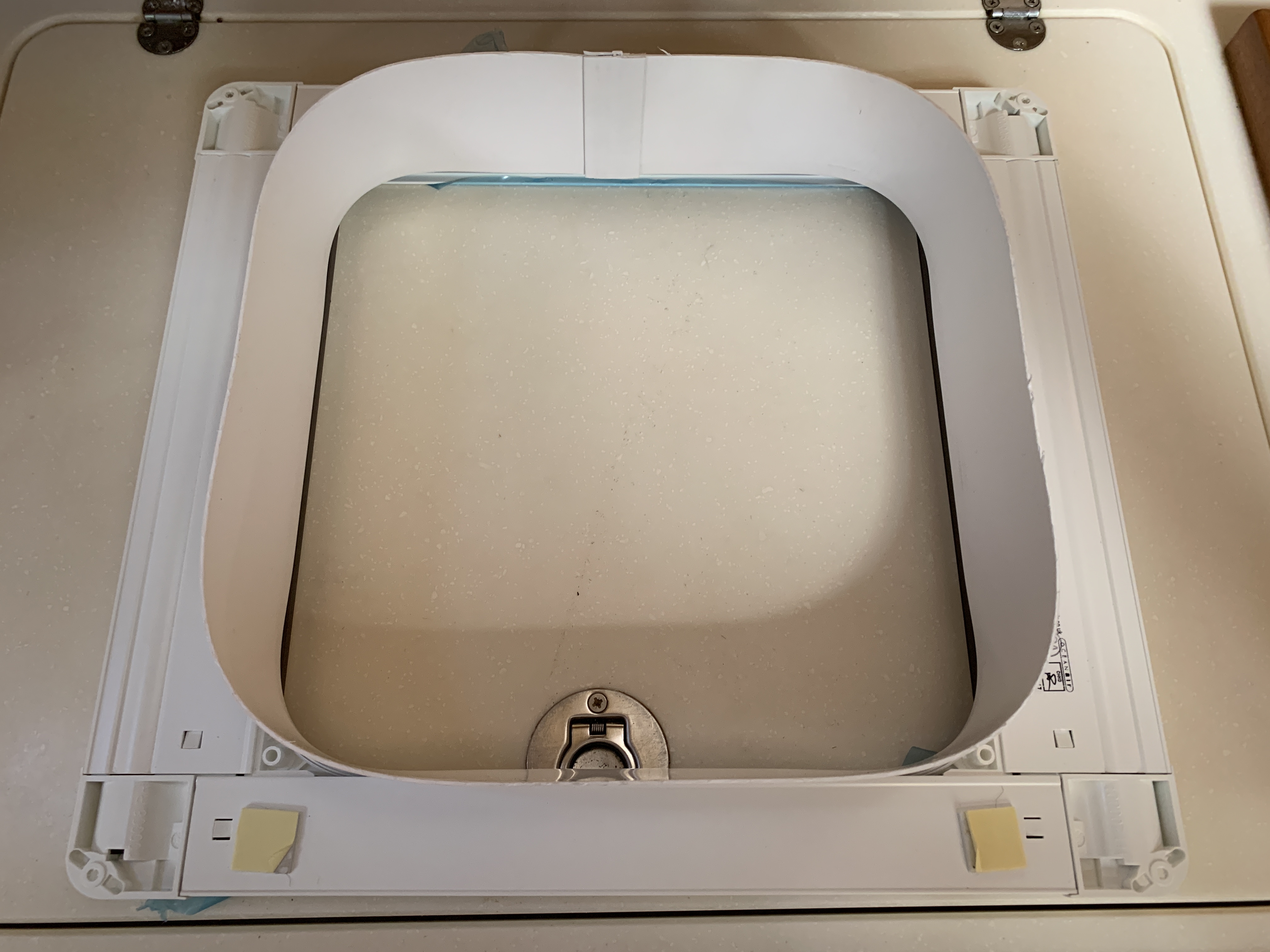

Hello alenka, I tried to locate a Lewmar screen for the forward head on our SO42Ds but they were discontinued. I then made it my life's mission to locate a new spring that had broken so I could repair the old blind. Once again, I was disappointed to learn such a spring is very difficult to find. In fact I failed in my attempts. I then researched other blinds and found the Oceanair SRS-10-W was a direct replacement. It also required the plastic trim ( Part number SL5-SRS-PVC) to go between the blind and the hatch to finish it nicely. This is the original blind. www.23hq.com/yachtbird/photo/57893506/originalThis is the state of the old blind when removed. www.23hq.com/yachtbird/photo/57893523/originalThis is the broken spring I failed to be able to replace. www.23hq.com/yachtbird/photo/57893533/originalThe new Oceanair blind comes as a group of parts to be assembled. Assembly is very easy. www.23hq.com/yachtbird/photo/57893540/originalThis is the assembled blind with plastic trim installed to go between the blind and the hatch for a nice finish. The plastic trim needs to be cut to length and cut to the correct height. You can see the joiner in the photo. www.23hq.com/yachtbird/photo/57893547/originalThe finished installed blind. In fact I think it looks better than the original. www.23hq.com/yachtbird/photo/57893561/originalThis is not the only Lewmar item that is discontinued on our yacht. We have a backlit, pushbutton sheet winch control button that has the push button worn through. I tried to purchase a new one. No such luck. Lewmar has discontinued this type of button and it is no longer available. It can be replaced with one that does not fit the existing cutout. Very disappointing. Regards, Trevor

Yes they are a Dometic product. They fit the Lewmar hatches perfectly so I am just glad someone took over from Lewmar to supply a way forward. I don't think too expensive as the one I purchased was AU$147 and the plastic trim was another AU$21. Not badly priced for a marine product and well worth the price to resolve a difficult issue.

The blind I used did not have the "accordian fold" but rather simply had straight material for blackout and fly screen on a spring loaded roller. I know the accordian style as we have these in our caravan and they are quite fragile but the one I fitted seemed reasonably robust.

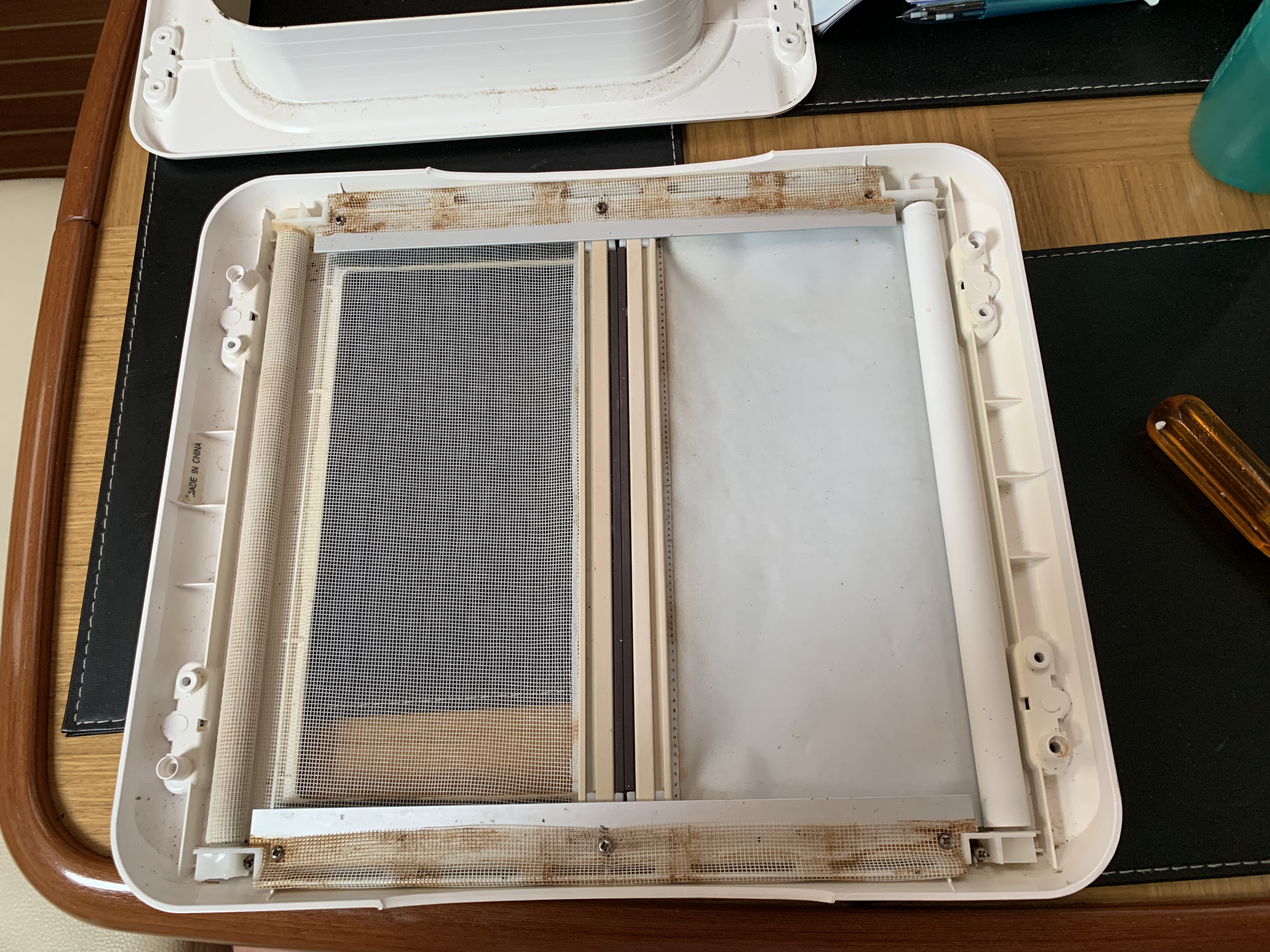

Post by shawnkaplan on Jan 21, 2020 0:11:48 GMT
Trevor (and all)-
Super useful pictures - yes, I have exactly the same issue. Not going to be able to repair the screen, looks like I need to replace the entire unit. The OceanAir screens look like a good replacement. I have a . 2007 Sun Odyssey 42 DS. The current screens look a little "off-white" to me. I'm in winter now so the boat isnt super accessible. Any idea if the original screens are white or beige? They seem to be in the middle currently. Trevor, looks like you went with the white ones? but this seemed to be just in the head, I'm replacing the main Size 60 hatches.

Post by colinnz on Jan 28, 2020 6:15:25 GMT
Hi all, I too am looking to replace my oceanairs as they look terrible. Also noted they were bought by Dometic but struggled getting answer from them. Found them here - www.svb24.com/en/oceanair-cabinshade-hatch-shades.htmlPricey but going to have to try them I think at least in main saloon and fwd cabin for now.

I had the same issue with the blind springs on our 36i. I tried to get replacement springs however they were not available. Rather than go through the expense and hassle of purchasing replacement blinds I had new springs manufactured by a spring specialist - was a long process but way cheaper! If anyone needs spare springs I have four spares available. Send me a PM if you are interested.

Just to answer shawnkaplan, yes, I chose the white colour. Sorry I didn't see that question earlier. To Panache, well done in getting the spring made. I really tried hard to find them, determined that the original manufacturer had to get them from somewhere. I also tired to get them made but could not find anyone willing to do that in small numbers so I gave up.

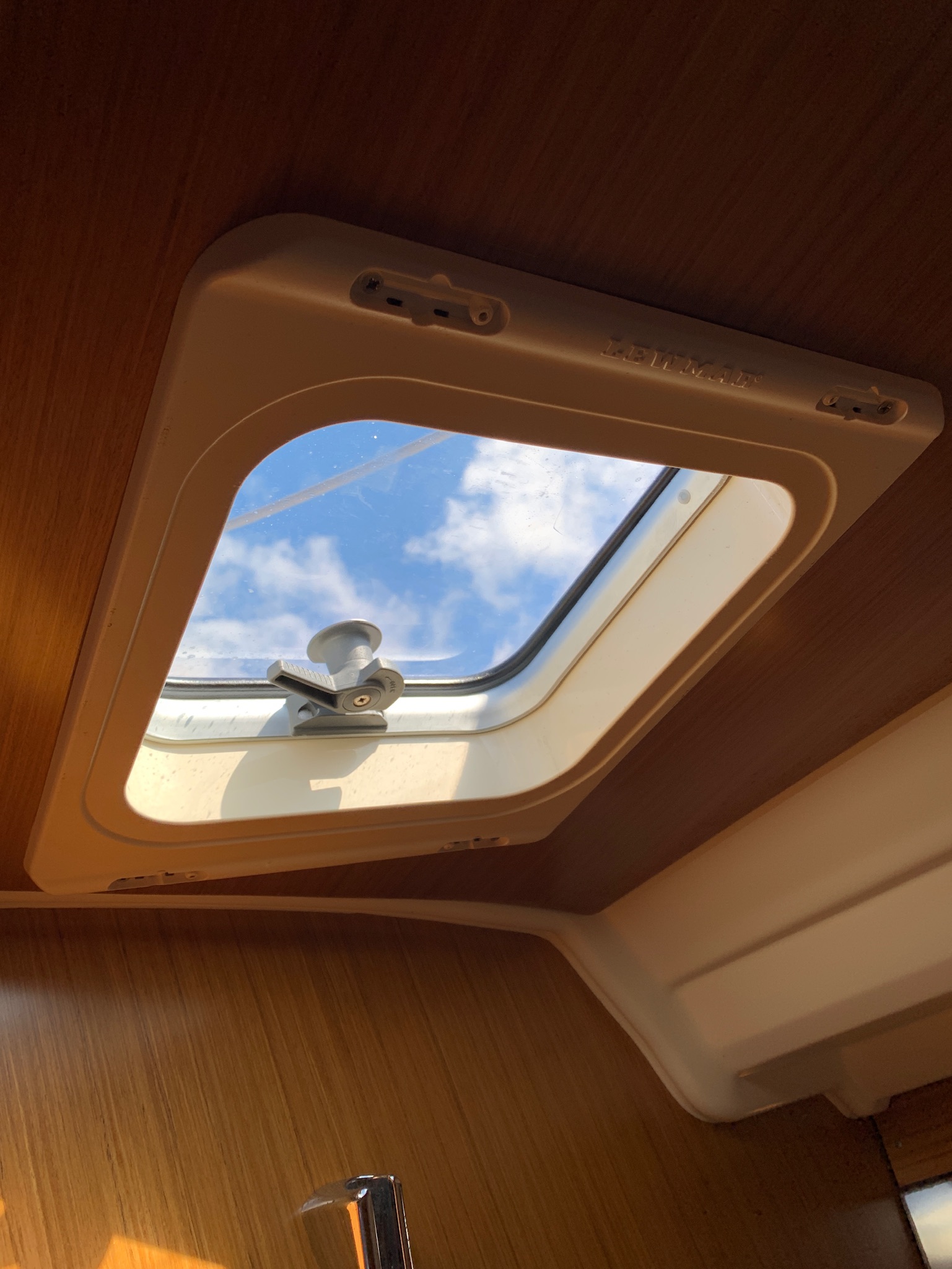

Post by lysandk on May 3, 2022 20:24:10 GMT
I'm aware this 'semi old' thread is about Oceanair screens, so just to inform, that Lewmar screens are available. I've just replaced one size 60 in the front cabin of my 2008 SO39DS, and together with the optional 'Trim kit' there is no problem in replacing. Takes half to an hour. www.lewmar.com/node/20189 and www.lewmar.com/node/20191 ordered through a marine equipment store.
Post by Trevor on May 9, 2022 13:52:11 GMT
Hello lysandk, that is valuable information because I though the original screens were no longer available. Thanks for updating us on this.
