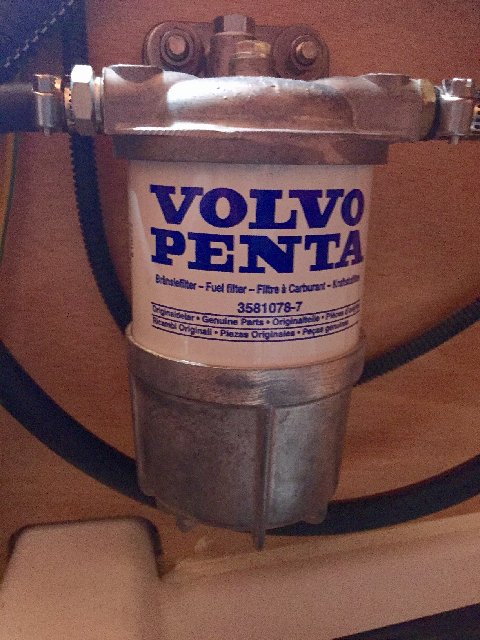

I have Volvo Penta fuel filter/separator on my 379 (photo below) and I'd like to check for water for the first time. Do I just turn off the fuel supply before the filter and crack the bolt on the bottom? What are the top bolts for? I'm having a hard time finding any diagrams of the filter online. Additionally, I'd like to replace the Volvo system with a Raycor filter that has a viewing bowl and vacuum gauge at some point. Can anyone recommend a specific model (micro size required?) and comment on a self-install? Thanks for the time.

I just swapped out the Volvo for a Racor 230 with filter element R20P on our 2011 36i with the 3ym30. This is a 30GPH with a 30um filter element.
I went this route based on the suggestion from so36idavid on this board.

I was not able to locate the part number for the racor assembly but it holds the 30 micron filter R24P. It is a metal housing tan in color with a pump handle on the top and a sight bowl and drain on the bottom. Sorry to be so non specific but I couldn't find any part numbers. So far it has been flawless and is a significant upgrade to the volvo which I kept as a spare. Having the pump makes changing the filter much faster and the sight bowl is critical. When changing the filter it was a simple replacement for the housing assemble. Used the same holes and fuel line placements. www.racorfilter.com/online/index.php/mobile-fuel-filtration/turbine-series/500fg-series/500fg2410.html
