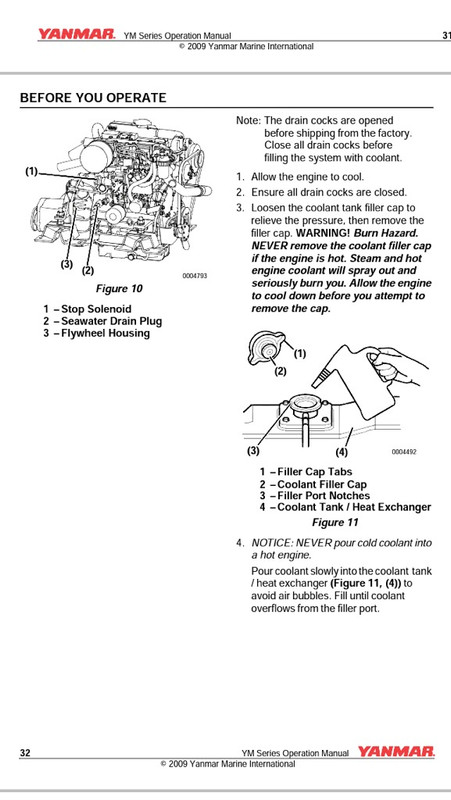

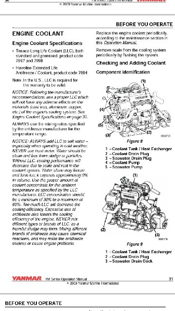

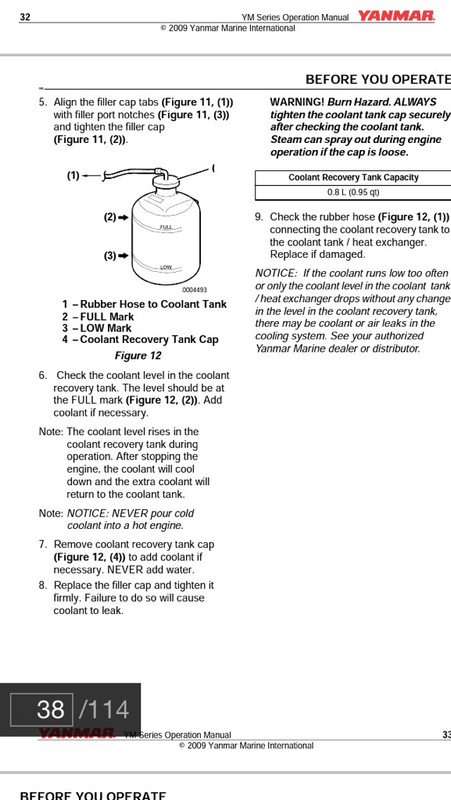

I am also getting ready to change the coolant (first time doing this) and it appears as though the Yanmar manual says to fill the coolant/ heat exchanger first and then add coolant to the coolant recovery tank directly (if not at the full line). Am I interpreting the manual correctly (see attached photos for corresponding pages from manual)? Thanks, Jon
Post by reverie on Jun 22, 2014 2:38:07 GMT
Yes, that's definitely the right way to do it. I finally got it working well. Key is to fill the engine very slowly. Also squeeze the large hose in front of the engine a number of times after the engine appears to be full to squeeze out air bubbles.
