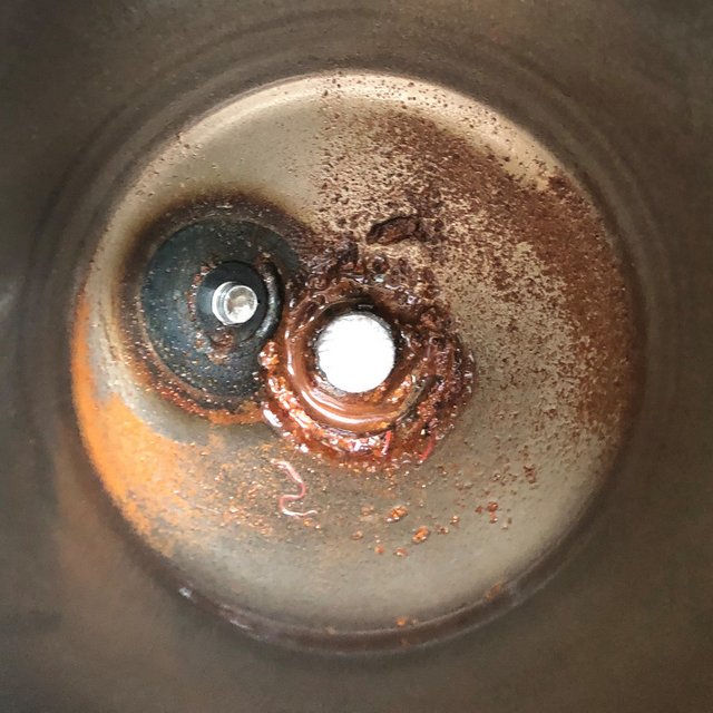

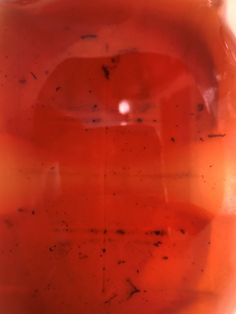

Replaced both filters last week. The job was much easier than expected and only took a couple of hours including bleeding the air out of the fuel system. No water in the water catcher however there was a bit of sludge and a few debris (see photos attached). All now back together and run for 20 minutes to ensure all the air was out of the system. Thank you once again for the useful comments.
