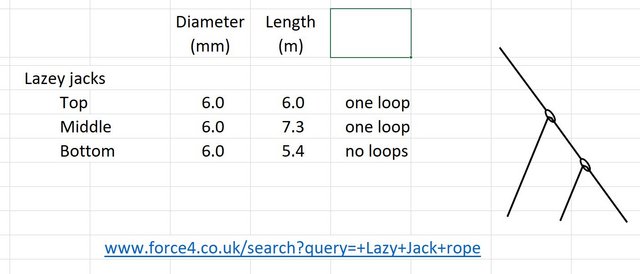

Hi, I recently replaced one of mine on my 2016 JSO 419 as for some reason it broke whilst out sailing one day. I used 6mm Liros Lazy Jack Rope in silver from Force 4 Chandlery in the UK www.force4.co.uk/search?query=+Lazy+Jack+rope The lengths as follows in attachment, hope this helps.
Post by mred25234 on May 11, 2022 14:45:47 GMT
Hi, I recently replaced one of mine on my 2016 JSO 419 as for some reason it broke whilst out sailing one day. I used 6mm Liros Lazy Jack Rope in silver from Force 4 Chandlery in the UK www.force4.co.uk/search?query=+Lazy+Jack+rope The lengths as follows in attachment, hope this helps. Alan This is very helpful. Thank you very much
