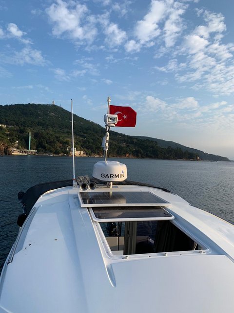

Hi, For those of you that have radar on their 795 and 795 series 2 can you put up some pictures, want to see mounting options?
Post by fritz on Dec 8, 2021 16:37:49 GMT
Post by ihsan on Jan 14, 2022 22:03:12 GMT
Hi For those of you that have radar on their 795 and 795 series 2 can you put up some pictures, want to see mounting options? This is custom made. The trick is to support the stainless base from under by bolts. All height and positioning of the radar are correct. Navigation lights and mast go up, horns also rests in the extension of the same structure. But if I had to do it again. I think I would put it on top of two paralel high stainless bars close to each other, resting on the roof screwed in from top. Working from under for support is difficult. It would be easier to install other extras that you may need.
