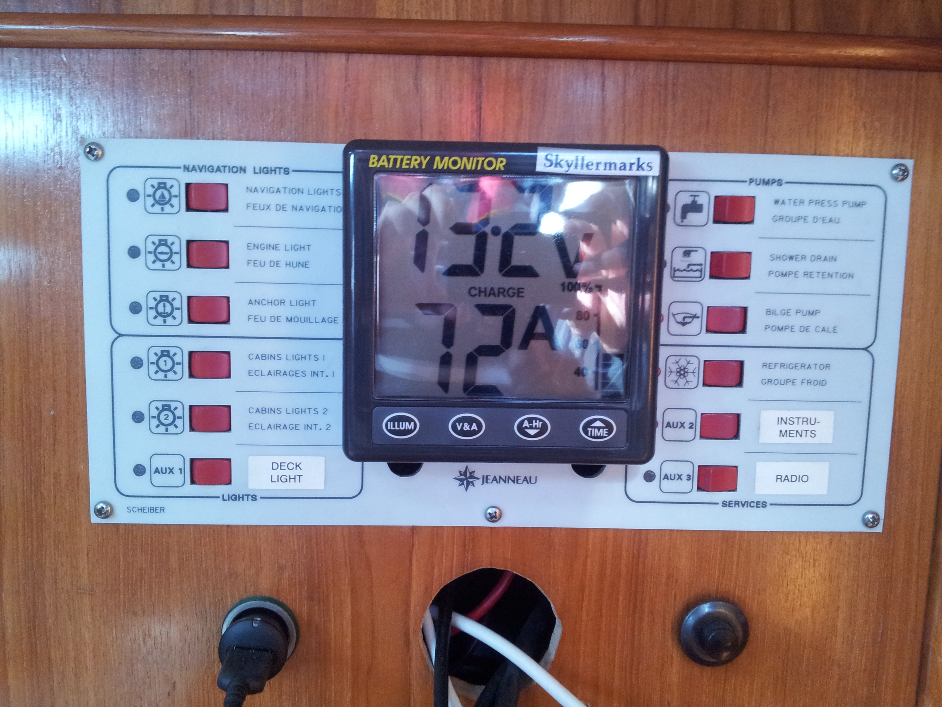

Post by saxofon on Jan 20, 2019 17:16:36 GMT
I think your cablings need some resizing I have 3x110Ah AGM batteries (some cheaper variant, "nobrand") that I bought for the 2011 season, which means they are now soon on their 9th season, and they are performing like new still. Then I also changed all the base cabling (electric panel <-> batteries <-> alternator). Here is a test I did some years ago. First depleting them alot, intention was 60% but I got them even a bit lower... seems I like to overdo things... Then charging by motor/alternator: if dropbox picture sharing don't work... it shows a battermonitor showing 72A) www.23hq.com/saxofon/photo/50831514/originalThat current showed for some time but I don't remember the details unfortunately, some 30-40 min perhaps, before starting to show a drop. The motor is a Yanmar 4JH2E with I believe original alternator. Don't remember it's marking but somewhere around 75-80A or so. So the test shows the alternator performing as stated. This is of course depending on a lot. Batteries and their conditions (I think one battery of the standard type is able to consume about 20-25A each, which matches my test too. Lithium would be like a shortcut in this test ), cabling and its condition, temperature etc. IMHO, we should be able to see currents for what the alternator states if the complete system is in good optimal shape. Often though, the standard cabling is too weak on the systems I've seen. You just can't have too big cables (found the manual and it actually states a 55A alternator as original, so probably someone upgraded the alternator along the time, will look next time I'm at the boat)
