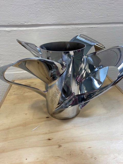

Post by lynnardm on Jul 9, 2022 0:48:16 GMT
The prop has arrived. Machining quality and finish is fantastic. Capt’n Lynn

That is a spectacular looking propellor. It’s a pity it does not really meet all the expectations, but good on you for hanging in there. I am sure you will learn more in the end from staying the course. And good on the manufacturer for the offered support.
I am sure that we are all waiting with fingers crossed for the results of the next steps. It certainly shows that there is art as well as science in propellor design and selection. It will be great to talk with their test engineer.

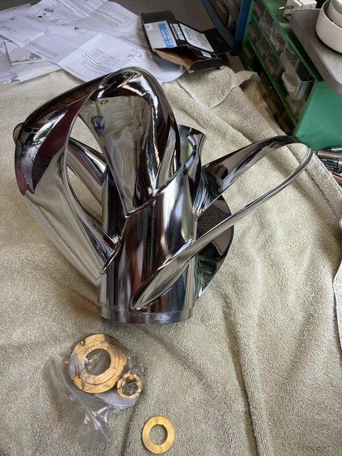

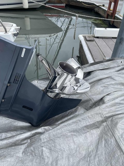

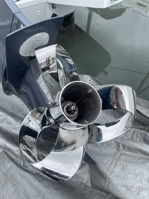

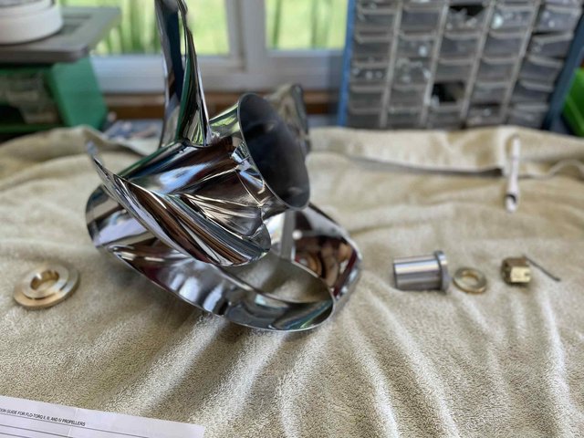

Rene Your scholarly input on the related post for propeller pitch reminded me I hadn’t input any pictures of the new sharrow propeller that now is on my boat. What’s interesting is that in the one picture you can see that on the trailing end of the propeller loop the pitch (angle) of rhe blade is quite different. Karl the engineer explained that is really is an increasing pitch in the blade from start of loop to end of loop. Capt’n Lynn

That prop sure looks great. I think it will also be a conversation starter.
It is a bit head spinning trying to follow the blades, the front surface seems to swap sides at the outer part of the loop, like some sort of Möbius strip.

Also, I notice you had to remove the small fin above the props which I assume are used for fine tuning direction, mainly on single engine set ups. Was that difficult to remove and have you had any issues pulling to one side?

Welcome to the forum. The Sharrow propeller is great. The F300 lower unit fin (anode) provides some protection from electrolysis when the lower unit is in the water and supposedly helps for torque pull. But even with the fin it took more steering effort to turn the boat in one direction than the other. Although she tracked nice and straight at least without autopilot. The fin was set at a couple degrees but I don't recall the exact setting. With the shape of the Sharrow blades they would have hit the fin. It is easy to remove and reinstall but I didn't need to. I just sawed off the fin (with it installed) using a hack saw. Sounds crude but it looks fine. The remaining base will still serve as an anode. Whats great as I previously commented in this thread is that with the Sharrow torque pull is no longer present. And yes you are correct, with twins and counterrotating propellers torque pull should not be an issue no matter the propeller.
