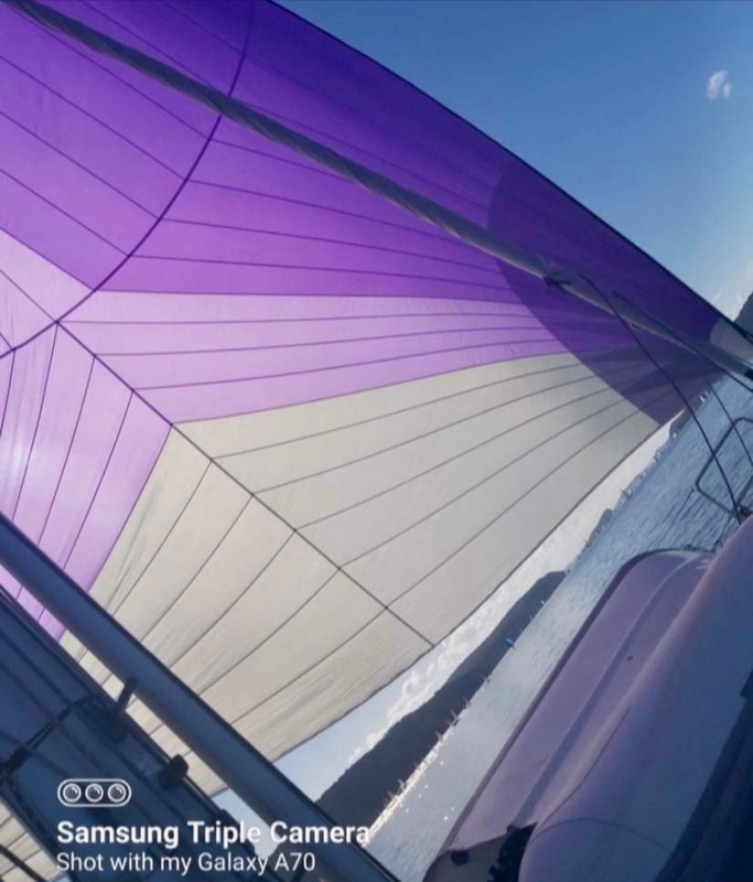

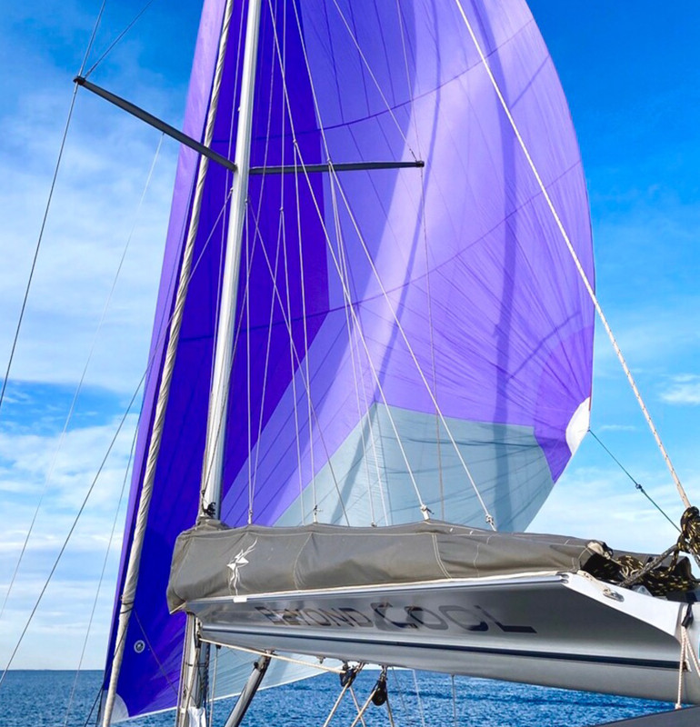

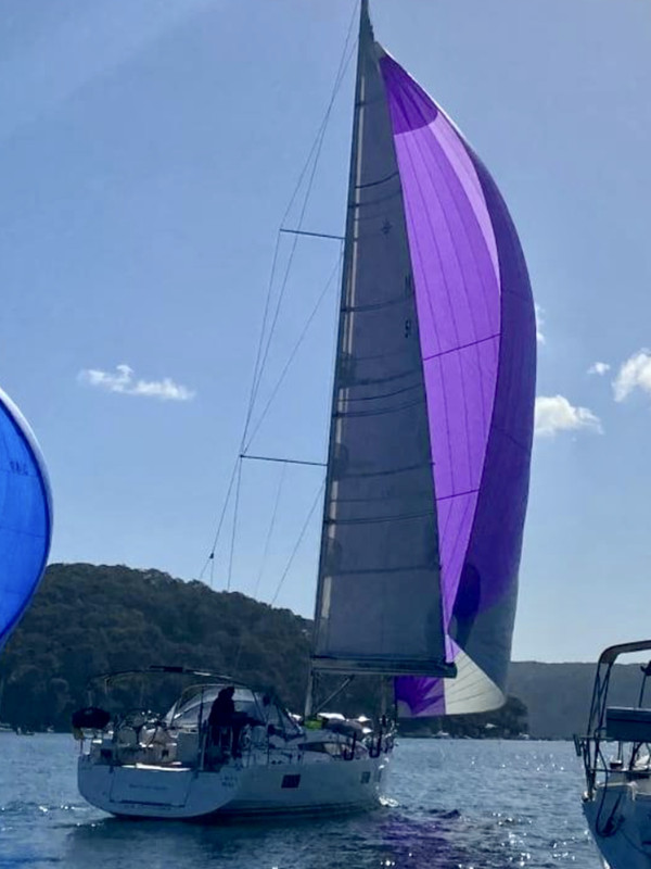

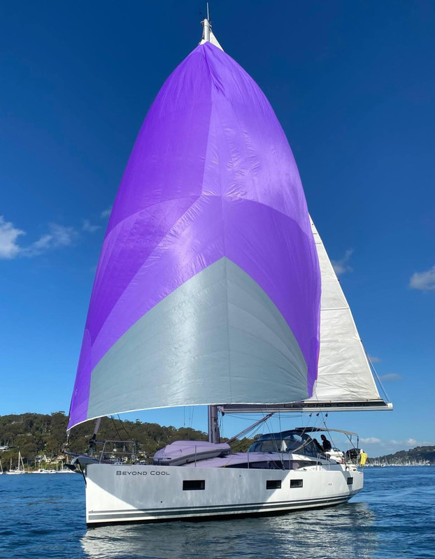

Jeanneau 51 Code D type furling A3 Phillips sails Australia Objective was App 120 to 160 deg / 8 to 18kts true wind speed - as full as will still furl easily. Solution was Karver top down furling sewn into luff = 170M2 It is exactly what I was after. Regards Mark SV Beyond Cool

That looks fabulous, Mark. Â You would really be flying in 18 knots true wind! Â But of course, sailing downwind reduces the apparent wind so I assume still quite manageable. Â And all that area makes downwind in light airs fun too. rene460 Hi Rene, I have not had it up in 18 kts yet but 12/14 so far. The whole concept was for deep angles so even at 18knots true at 160 deg App the furl would take place in approx 10 knots apparent - and we would probably put the motor on to keep the speed at 8.5 kts as we furl to keep the apparent wind around 10 knots which is very manageable. Objective is safe no drama spinnaker furl and the top down action with the cable in the luff gets the full head away first.
