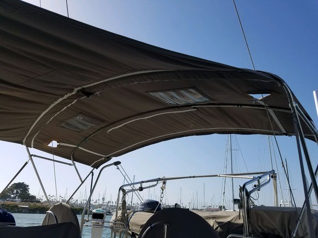

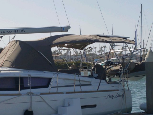

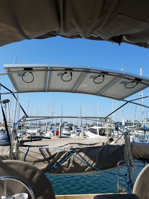

Post by sailingabe41ds on Jul 4, 2021 6:28:58 GMT
Hi.. I have 2015 Jeanneau 41DS which is similar in size to yours. First read alot about solar panels, controllers, and how to wire things together. It is not that complicated if you look at lots of videos and see how they set things up and how to calculate your needs. My house batteries are four AGM group 31 for a total of 420 amp/hrs house. I use about 180 amp/hrs a day. My goal was not to have my solar panels supply 100% of my needs but maybe 70-80% and maybe briefly use the Yanmar or a Honda 2000 to partially charge the batteries every other day and let the solar do the rest. I bought 4 Renogy 100Wt Monocrystalline panels....I went with rigid panels instead of flex for longevity. I added a Victron SmartSolar Bluetooth MPPT 100/50 charger. You need to read up on why an MPPT and why 100/50...that is where youtube and self education helps. Then you learn how to connect it all together, wire gauge, fuses, breakers. Again, read,read,read...you can do it. This is a pic of my final panels. I put it over the canvas covering and the frame appears to hold the wt without problems. A little reinforcement helped. The pics show how it looks without the canvas...and with the canvas with the panels over it. You can't even tell there are panels up there. Good Luck Abe
