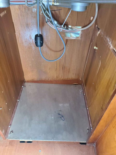

Post by andreshs1 on Apr 1, 2022 14:50:50 GMT
Hi mesteve I have just completed the washing machine installation. At the end, I purchased the Candy Aqua 104 le/2-s and I have fitted it under the galley sink. Photos attached Considerations: - under the galley sink there is a 2 panel wooden hatch door, this needs to be removed in order to be able to have enough room for the washing machine. As I was concerned on the actual support strength of the floor, I have added a 3mm steel plate over angle bars that provides additional support from the side panels (photo attached) - I cut a wider opening at the back of the cabinet, next to the water heater where I ran the drain and water hoses - new drain hose runs to the main bilge area behind the reserve fresh water tank, where a dedicate Surflo sump has been installed. This will help to remove 2 under water line thru-hulls (galley sink and forward sink), and consolidate the washing machine, galley sink, fwd shower & fwd sink to the existing fwd thru-hull for the forward shower. Cheers
