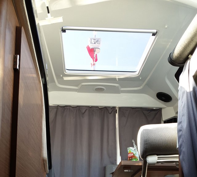

I find the factory installed speakers inside the cabin not enough to listen to music in the cockpit area.Therefore its better to install extra speakers. Some position them to the right and left adjecent to the doors facing each other. I preferred installation up on the roof extension corners, right and left of the round cockpit light. It is easy, you can easily drill round holes for them. You must be careful to drill a spot that will allow you to have enough back distance to install them. Otherwise you may have to put an additional piece between the hole and the speaker.

Thanks ihsan Do you maybe have some pictures of speakers installed? Outside and inside. I found one with outside speakers installed in rear bench. There is no storage in rear bench, just empty space without hatch? The following are the location of the speakers. The two fusions installed by the factory are inside. The other two fusions which I have added are outside. They are one size smaller than the factory installed ones. They were the ones I could get during that time. You can change their colours from white to black. The black covers were inside their box. The factory had put the box inside the boat. There is no storage in rear bench.You can open two hatches to port and starboard and use them. You will find two platforms there which will help you. However these platforms are giving way to empty space. This is a plus to store long objects which you cant fit anywhere. One end rests on the platform facing you and the other end must be secured firmly inside the empty stern area. But İf any thing falls down you may not be able to recover them. This did not happen to me. Somehow they stay firm, when you find a firm resting spot.

I will probably go for Kicker 6.5” speakers, inside and outside. Outside would like to install them in roof like you, for better weather protection and to keep aft bench free for storage. Installation depth says 6cm on speakers website. This should be fine, for roof installation inside and outside?
Post by ihsan on Jan 27, 2021 13:11:18 GMT
Super, thanks for the pics and info. I will probably go for Kicker 6.5” speakers, inside and outside. Outside would like to install them in roof like you, for better weather protection and to keep aft bench free for storage. Installation depth says 6cm on speakers website. This should be fine, for roof installation inside and outside? If you install your speakers over the roof extension as I have done you should get 5 cm.depth for sure. But the point is to make the cable connections, which require some working space for your hands. It was not that easy. Placing them a little back towards the door may give you more depth and ease. In order to be able to use the empty space inside the aft bench and all the empty areas in the aft of the boat, it is enough to put two hatches there. The round one in the middle is only for observation.

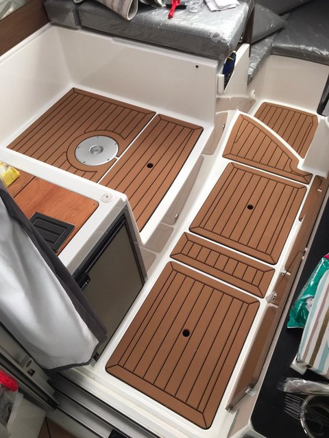

Nice idea for a hatch. This is on your boat?? This is real teak floor?
Post by ihsan on Jan 27, 2021 22:13:36 GMT
Its been over a year now since these additions were made all at the same time when the boat was still on land at the time of the delivery. - The same model as the Fusions inside but one size smaller. At the moment the model number is not next to my reach. - It is mostly got to do with the lenght and reach of the cable and it is not easy to work hands up and make the connection and place them back in a small tight closed hole. - THe cockpit area is real teak but later on I found the U deck, Marin decking. Cabin area and the decks are U deck now. This material is strong, resists steins, does not get hot, flexible, walking on it is safe and comfortable. After taking measures the pieces are made by cutting them with CNC machine. Therefore lines are perfect, the black colour also becomes apperent after removing 3 mm.s from the original material again by CNC. So you have a three dimensional lay out. You have got choise of grey and black which I think is also nice in 795. Altogether the material is 6 mm. and that seems to be good choice for this purpose.
