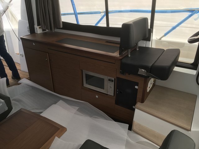

Hi, attached a picture of my NC11 with a microwave, fitted by Jeanneau ex factory. Andreas

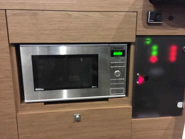

Hi. Thanks! Do you know what the make and model is as I’m trying to find where to buy. Otherwise need to know he dimensions.

My boat is away for the season. But it looks like a wood filler panel in the additional space above. Would be nice if that was an available spare part. Thanks for the photos!

Hi, I have been back to my boat today, which is in the winter shed. The microwave fitted by Jeanneau is a Panasonic NN-GD37HS, which is 48cm wide and 27cm high at the front. The wooden panel above is 54cm by 12.8cm.
