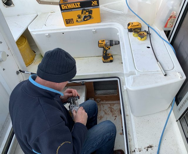

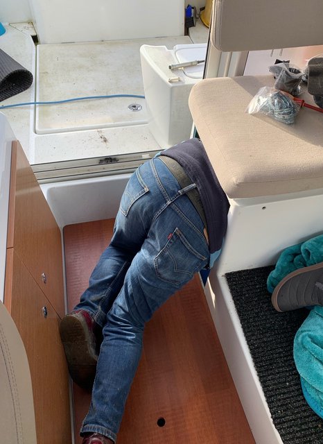

Post by mf755wahoo on Jan 2, 2021 19:25:10 GMT
We made a significant inroad towards the Webasto Airtop 2000 installation today. We were a bit sideswiped by what appeared to be loads of partitioning under the deck making us think positioning the ducting was going to be a real challenge. However, once we had created the 1st opening in the central compartment and taken out the fridge, things looked a great deal more promising. Notwithstanding that doing anything in boats generally requires getting into some very weird contortionist positions....... So vents are positioned and main ducting in place. Next will be sorting the fuel tank, locating the heater and dealing with the exhaust, air intake and combustion air intake positions. Attachment DeletedAttachment DeletedAttachment Deleted
