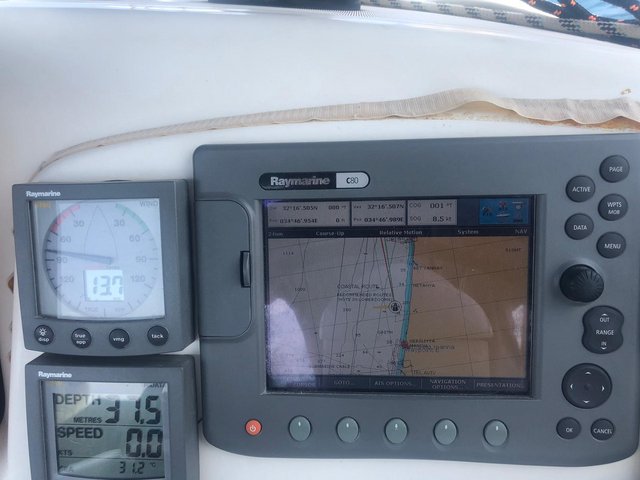

Using the site jitter.github.io/orc-data/site/ I have obtained some polar charts for SO40. These would seem to indicate that the boat should do up to 5.3 knots in 6 knots of breeze and up to 6.4 knots in 8 knots of breeze. However our experience is that it is somewhat slower than this and also slower than similar sized boats, which is quite disappointing. Once the wind increases it is better but does not seem to achieve consistent 8 knots plus that the polars would indicate? The boat is shoal draft which I understand will impact leeway, but I wouldn't have thought would make much difference to straight line speed. I realise that the polar is theoretical, but our poor speed against similar sized boats seems to indicate we should be going faster I was wondering what other SO40 owners think of the performance of their boats and also whether anyone has a Jeanneau supplied polar chart? Hi Esmeralda, just to make you sure those boats can go fast I went sailing today on my SO 40 DS , true wind was 12-14 knots, I deployed my 100 sqm gennaker and at awa of 95 degrees we reached 8.5 knots gps reading. Don't give up the ship.
