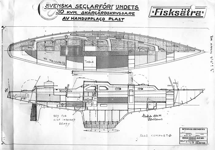

I grew up sailing a Fisksätra S30, a 6-metre type of of boat (long, narrow, shallow draft). I quickly heels to 30-40 degrees but stays there no matter how much sail you have. I still race on a friend's S30 sometimes. One time we were approaching the finish on a reach, and had to clear a gate and then tack the final 0.5 mile to the finish line. We had the big genoa and no reefs in the main. Just as we rounded up towards the finish line, there was a gust up to 50 knots. I was on the genoa sheet winch which was almost impossible to reel in because of the force. We heeled so much that the cockpit half-filled and I was sitting in water up to my waist. Even so, we stormed to the finish line like on rails. Around us the modern boats broached and blew out asymmetricals.

......I grew up sailing a Fisksätra S30, a 6-metre type of of boat (long, narrow, shallow draft). I quickly heels to 30-40 degrees but stays there no matter how much sail you have. I still race on a friend's S30 sometimes. One time we were approaching the finish on a reach, and had to clear a gate and then tack the final 0.5 mile to the finish line. We had the big genoa and no reefs in the main. Just as we rounded up towards the finish line, there was a gust up to 50 knots. I was on the genoa sheet winch which was almost impossible to reel in because of the force. We heeled so much that the cockpit half-filled and I was sitting in water up to my waist. Even so, we stormed to the finish line like on rails. Around us the modern boats broached and blew out asymmetricals. In the UK we call that a "plank on edge" seriously narrow beam. I have seen these on occasion in Holland and Baltic Many, many years ago with two friends we started repairing "Coronet" an old carvel built narrow "plank on edge" 30 foot design by Arthur Robb. It was an impressive design but loved to heel, my friend later sailed her singlehanded to NZ and Australia including double crossing of the Tasman (only image I can find still below)
