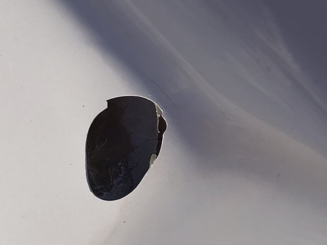

Jeanneau SO42DS, 2010. Recently discovered two parallel lines of cracks in gelcoat from beam to bow about three inches apart, and five inches from toe rail. What is underling cause: structural? Voids? Poor gelcoat install? Other.
Technician is trying to determine if void below. i am trying to understand if this can be fixed without making annual repairs.

Post by waterdog on Jan 15, 2020 23:41:55 GMT
Post by waterdog on Jan 16, 2020 15:50:17 GMT
It is hard to tell without pics. It really depends how deep they are, but typically cracks form in gelcoat where the fiberglass is flexing. Post some pics so we can see what they look like and where they are.
Post by zaphod on Jan 18, 2020 1:54:41 GMT
Those are strange! Usually you see cracks near stress points like tracks and stanchion bases.
I see you have done some exploratory drilling...is the core wet in those areas?

June 2020 update. J 42DS. Had survey conducted this week and three gelcoat/fiberglass technicians look at the deck. Nobody has an explanation for the voids that run along the deck and cabin top. Very dry under surface. Everyone that looked at it said it’s just really poor workmanship by Jeanneau. Several are wondering if other Jeanneau boats were built in this fashion.

Post by panoramix on Jun 26, 2020 7:17:07 GMT
My SO37 had these cracks in the cockpit floor.
These were caused by air bubbles just under the gelcoated. Probably trapped air during production. A part of the floor would flex when some load was applied by foot or hand. They only showed up after 4 years of use.
This cracked area had the size of a dinner plate. Repair was done by drilling several holes and inject epoxy in one hole and wait till it came out the next hole.
Post by waterdog on Jul 3, 2020 21:56:49 GMT
The president of Jeanneau America Informed me by email that, that is how we build the boat. The seam between the hull and deck has a gap of about 4 inches. That gap is filled with some kind of foam instead of fiberglass or resin. I was reassured by the head of operations that the issue is not structural. There is no issue or safety or degradation or moisture infiltration.

Our boat is from last year - built in the US plant. Yesterday we found the first sink hole just underneath the mast. The overall build quality of our boat is a mess. The teak in the cockpit started to get cracks already at the end of last season. In the interior the boat is oozing out some orange stuff that stains the seals - especially in the head. Our list on issues gets longer. We are getting an inspector now to survey the boat to understand if it is structurally impaired and if the oozing is toxic.

The last pic is worrying as it is in the mast step. I don't know where the other is. This can cause lots of problems as the boat ages.
It can be cured by injection but that is not what should be happening. I sailed a Catalina 25 for many years which was 25 years old and there were no voids like this.

I had a pre-purchase survey carried out on the boat I am purchasing and he found similar hairline cracks like these in an area usually stepped on to access pontoon and out from cockpit. Moisture readings were high. He said it was a void under gelcoat and quite common in French mass production boats. You can fair back the coating and refill, and inject filler into the void. The mast step crack/hole is important to sort out soon as water in there can give mast compression issues and long term issues with electrics inside that area.
