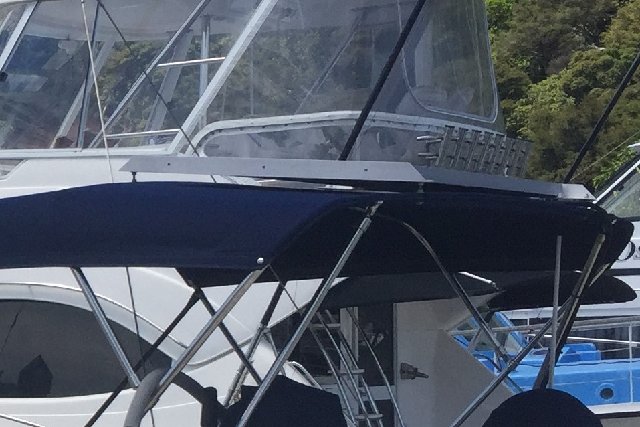

If bimini is your preferred location (which I agree with) then I'd suggest you mount a frame onto the top of the bimin and then the panels on top of that. See pic below of my setup on a previous boat (not Jeanneau).
Last point, the holes in the frame that I mounted were slightly oversized (oval) so I could losen and retention the bimini canvass if necessary. Otherwise a rigid frame with no adjustment could cause a saggy bimini if you can't retention the bimini bars from time to time.
