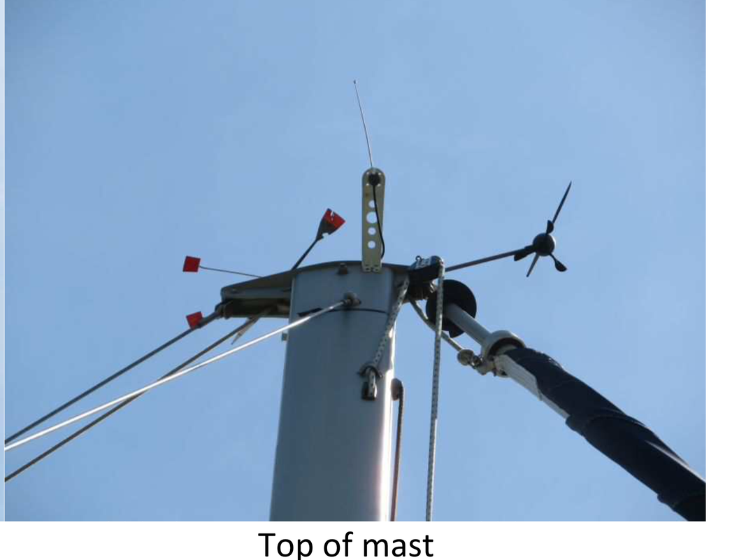

Hi Andrew, It was very interesting to hear, that you are using a top down furler on a SO 43 DS. I have the same boat, and built a nice stainless steel bow sprit. But actually I am affair that there will be a problem withe the space between the spinnaker halyard and the forestay with the genoa. This space is on the top rigged 43DS very limited. Do you have no problem with this or did you improve crane with the block for the spinnaker halyard. I would appreciate your your advice, because I am sailing mainly only with my wife and therefore a top down furler, using my asymmetric spinnaker would help me a lot. Reiner

Post by reiner on Dec 17, 2020 21:01:19 GMT
Hello, this configuration would be also perfect for me. Unfortunately the top rigg of the 43DS isn’t like this. Look at the photo.
Post by reiner on Dec 17, 2020 21:05:06 GMT
Sorry here is the photo
Post by zaphod on Dec 18, 2020 6:25:54 GMT
Sorry here is the photo Wow! There isn't a lot of room for a spin halyard on that mast! You definitely want some kind of crane on your masthead.

Zaphod is right. Not much room at the top of the mast of the 43ds for the spi halyard.
Reiner, I had the black disc removed and a long SS strip added at the top swivel of the genoa that then connects with the genoa halyard. However i suspect that the top swivel of my top-down furler is still being slightly fouled by the genoa setup since i get a reverse wrap from time to time when unfurling. I only once tried to gybe the gennaker (outside) and it was a total disaster in spite of the tack being fixed to a Selden bowsprit to get some space away from the furled genoa. I had to take the gennaker down and give it what i call the "washing line" treatment. Stretched out horizontally between two trees to carefully untangle it. Now i just furl it, gybe, then unfurl. I realise that is not much good for racing but it is fine while cruising short-handed.
As Zaphod says, it needs an extension plate for the gennaker at the mast-head but the tension on the torsion rope is so extreme that I think it might break an extension plate on the top of the mast. It might be better to get a rigger to move the attachment point of the forestay down a bit as well as the exit point for the genoa halyard if there would be enough strength in the mast with the forestay being a little lower. Meanwhile i live with what i have. My setup does work most of the time but i was hoping for some ideas so it works ALL of the time. One trick i discovered is to pull the UN-furling line for at least 20 turns on the drum or until you feel a little resistance, all while the gennaker is fully open (at about 140-150 AWA). Then to relax the sheets and wind pressure on the gennaker a bit (partially behind the main) and then pull on the furling line so the head of the gennaker catches the torsion rope and the furl starts. Once furled this seems to result in less stored twist in the torsion rope so the next time i unfurl it comes out beautifully. In 10-15 kn of wind it will fill very rapidly so you have to warn any crew not to be standing over the continuous furling line lying on the cockpit floor. I never tried Zaphod's idea of slowing and controlling the speed of the unfurl. Sounds another idea worth trying but risky by hand, it would need a turn on a winch.

The OP should definitely consult a rigger regarding solutions for the spin halyard. A properly designed and built masthead crane should be able to handle the load without bending.
With such low clearance at the masthead it will be important that the head of the spinnaker is not too stiff. If the sail wasn't specifically built for furling the corners will likely be quite stiff and overbuilt. My sailmaker took off some of the layers on the head to soften it up.
Post by reiner on Dec 22, 2020 11:37:24 GMT
Hi Andrew, hi Zaphod, thank you for your replys. My idea is also to built a new crane for the spinnaker halyard to create more space. The remarke with the tension on the non twist rope is important. I would like to buy a furler from Bartels, they have very good test results and hose over the rope. This increases the diameter and a quicker roll up of the sail and gives later the non twist rope the possibility to unbend against the furling direction without turning the sail. I will ask them what tension is necessary. Zaphod your are right, it is surely also a question how stiff is the head of the sail. This point I have to check, thank you for this important note. Unfortunately the boat is actually in Croatia and I in Germany. I don't know when it will be possible to go to the boat next year, but thats a general problem, so stay safe. Reiner
