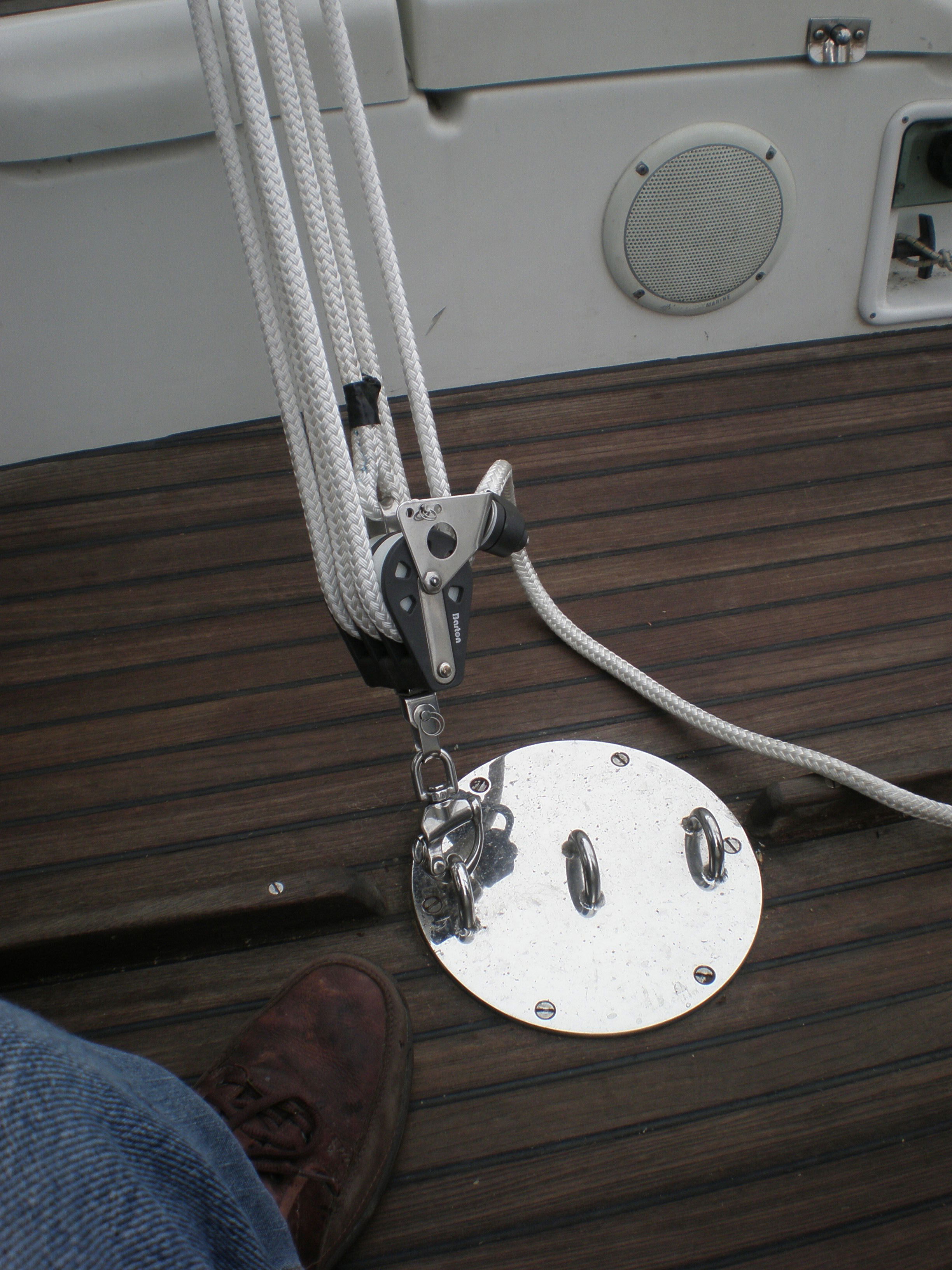

Hi Billy....I did post some photos of my mainsheet arrangement a few years ago but I can't find them on the forum at the moment. I'll keep looking. Basically I designed and had made a stainless steel plate and a backing plate to replace the cockpit table plate on the floor of the cockpit[tiller version]. This had 3 stainless U bolt type hoops welded on, to one of which I attached the mainsheet block arrangement from the boom via a 6 pulley set up thus doing away with the cabin top sheeting system which I found annoying. The other 2 hoops allow for different position of main block or you could clip on your safety line. This has worked well and though you have to be aware of the main in the cockpit it means you can now dump/trim the main from the helm. It also helps centralise the main. Also the mainsheet block can be unclipped when at 'rest' and secured to the pushpit out of the way leaving the cockpit clear.
I think the winches were moved back on the 32i because most people were buying wheel steered boats. I'll try and find the pictures. Ron

Post by lateron on Nov 25, 2018 12:20:36 GMT
Post by MalcolmP on Nov 25, 2018 20:00:43 GMT
Ron, You were 99.99% there, for some reason you had added http:// twice on the link.

Hi Billy ......well I've found it really works for me and means the boat can be single handed from the helm which is very useful when only 2 up which is how I sail most of the time. You could of course go one step further and install a traveller across the cockpit. There is a thread on here somewhere about that. I think I would probably fall over one of those but they would do an even better job.
Thanks Malcolm next time I'll get it right. Cheers Ron
