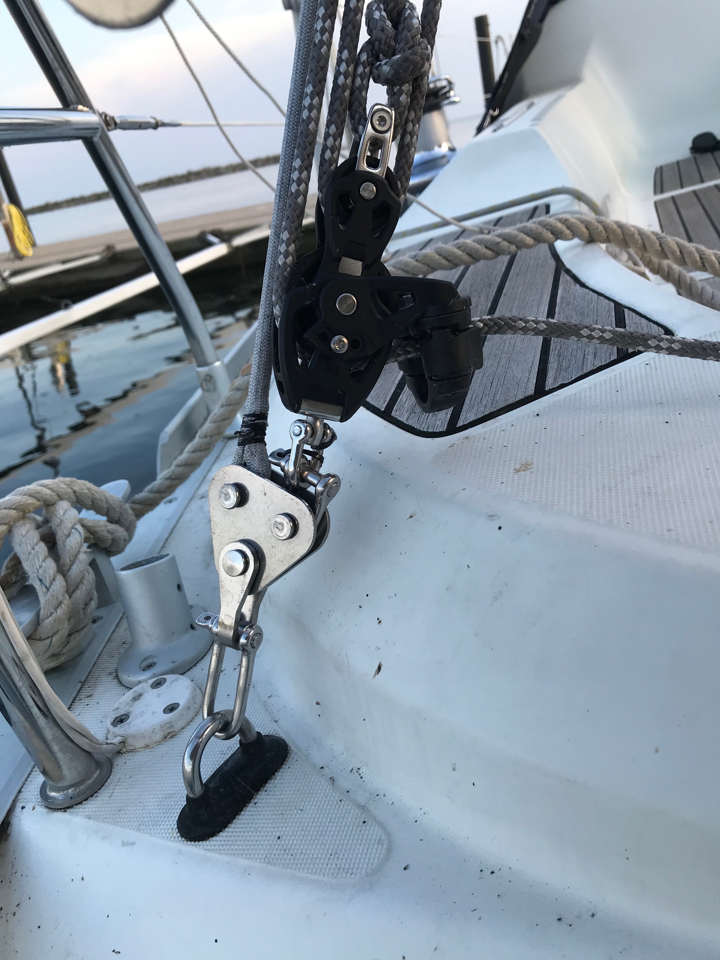

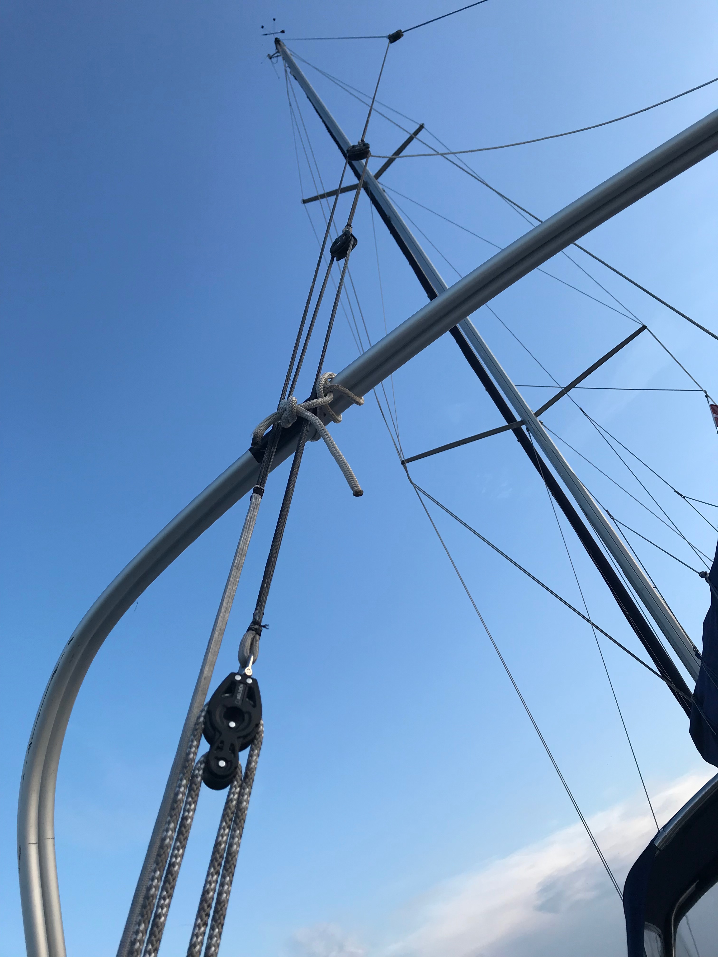

My setup is similar to this: www.jeanneau-owners.com/hintsandtips/SO36iadjustablebackstay.htmlBut with some variation. I used a 70 mm Selden block attached to the existing wire backstay, with a Selden rigging toggle between. The line is 6 mm dyneema. Then two additional cascade blocks, and a 4:1 purchase at deck level. So in total 4*2*2*2 = 32:1 nominal purchase. It feels just like the right amount. I preferred the 4:1 purchase at deck level to 6:1, since it makes for a slimmer setup. These are the components: Seldén PBB70 Single block (attached to backstay) Seldén toggle 3/8 Seldén PBB60 Single block (2nd cascade) Seldén PBB50 Single block (3rd cascade) Seldén BBB40 Fiddle block (4:1, top) Seldén PBB50 Fiddle block with becket and cam (4:1, bottom) 6 mm Dyneema 8 mm double braid polyester sheet line (for the 4:1) It did the dyneema splicing myself and it was fairly easy. The trickiest part is to measure the correct lengths. Use the old backstay for comparison. Unfortunately I cannot find my notes with the lengths I used...
Post by johannes on Aug 27, 2019 7:02:36 GMT
Oh, and I re-used the triangular rigging plate that was on the backstay to attach the cascade and 4:1 to the chainplate.
