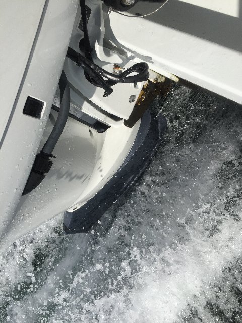

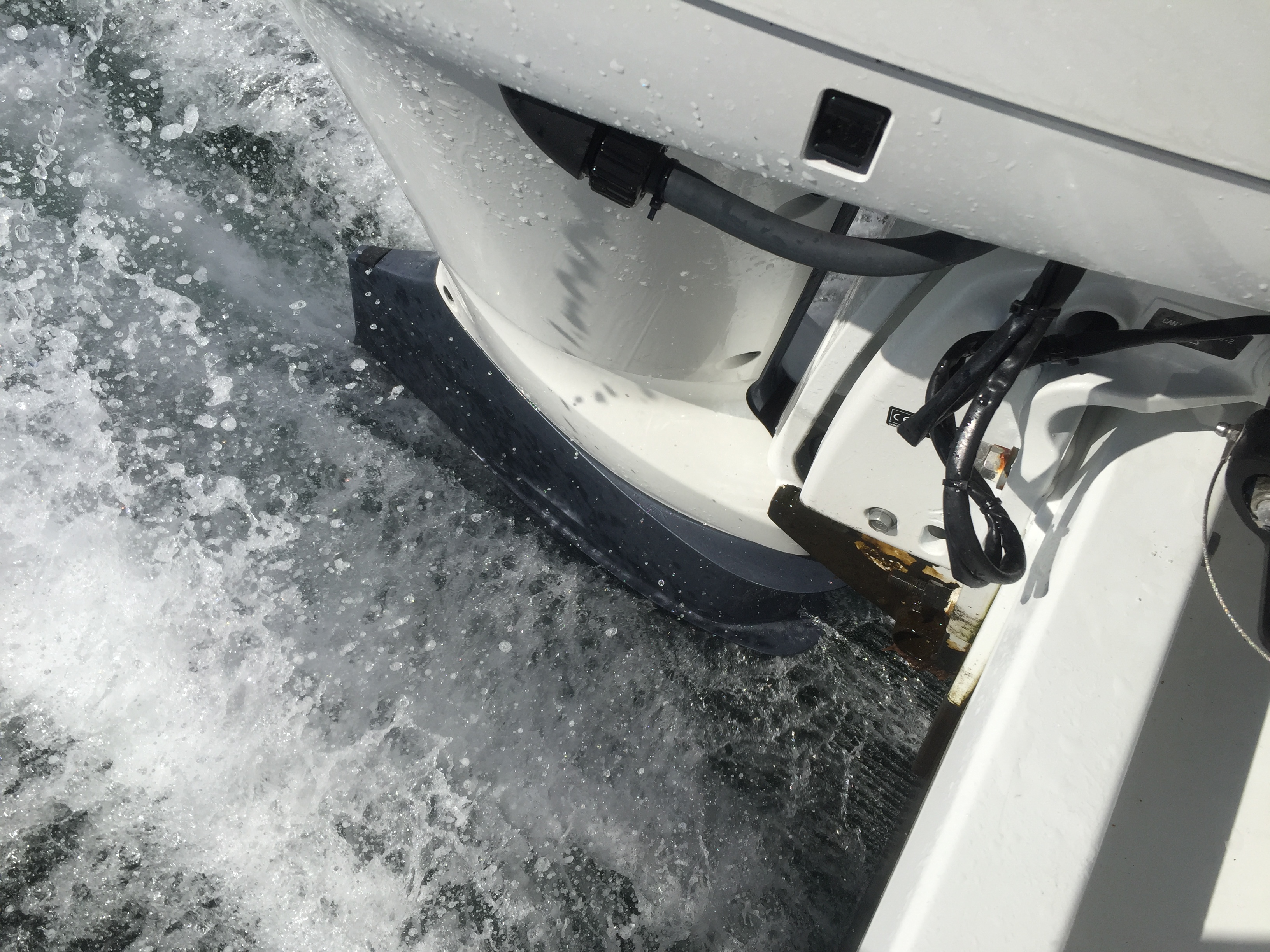

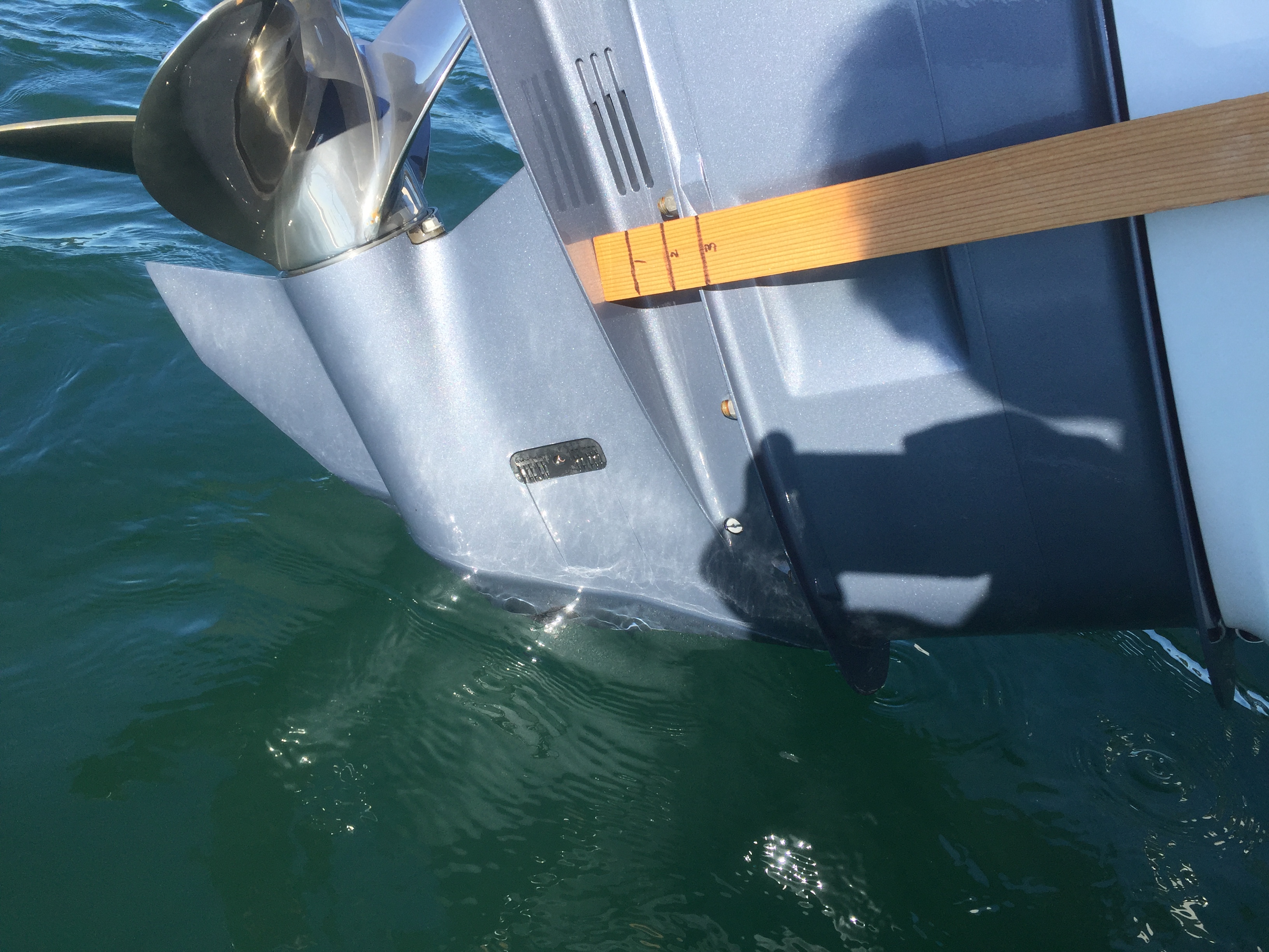

Post by lynnardm on Mar 6, 2019 16:35:17 GMT
Bogdan
I finally got out on the water to take a look at the position of the ant-ventilation plate. The first picture shows the drive out of the water. I marked a stick with 1" increments. For reference, the anti-ventilation plate is about 2.5" below the other smaller fin/plate (not sure what that's called). The 2nd pic is with the boat up on plane going about 25 MPH. The trim tabs are full down, and the engine trim is set at 3 bars up (from full down). The smaller fin/plate is definitely out of the water. But I can't see the anti-ventilation plate as there is so much spray and water movement. So I can't positively determine the location of the anti-ventilation plate, but it appears like its in the water. I was hoping to be able to put the stick on it to get a feel of its location but the water/spray is too violent and the force of the water just pushes it away. You may recall that I mentioned earlier that if I move the engine trim up a couple of bars from this position I start to get ventilation so I know that the propeller and hence the anti-ventilation plate is pretty close to the surface. If you learn anything or get additional info on the optimal height for the 895 & F300 please let me know.

Post by lynnardm on Mar 6, 2019 22:05:42 GMT
I just talked with Yamaha tech services. They say the engine should be mounted with the anti-ventilation plate at the bottom of the hull or up to 1” below the bottom of the hull. The plate is designed to be run submerged while the boat is on plane. So per Yamaha the height as installed on my 895 (at the bottom) should be correct.
