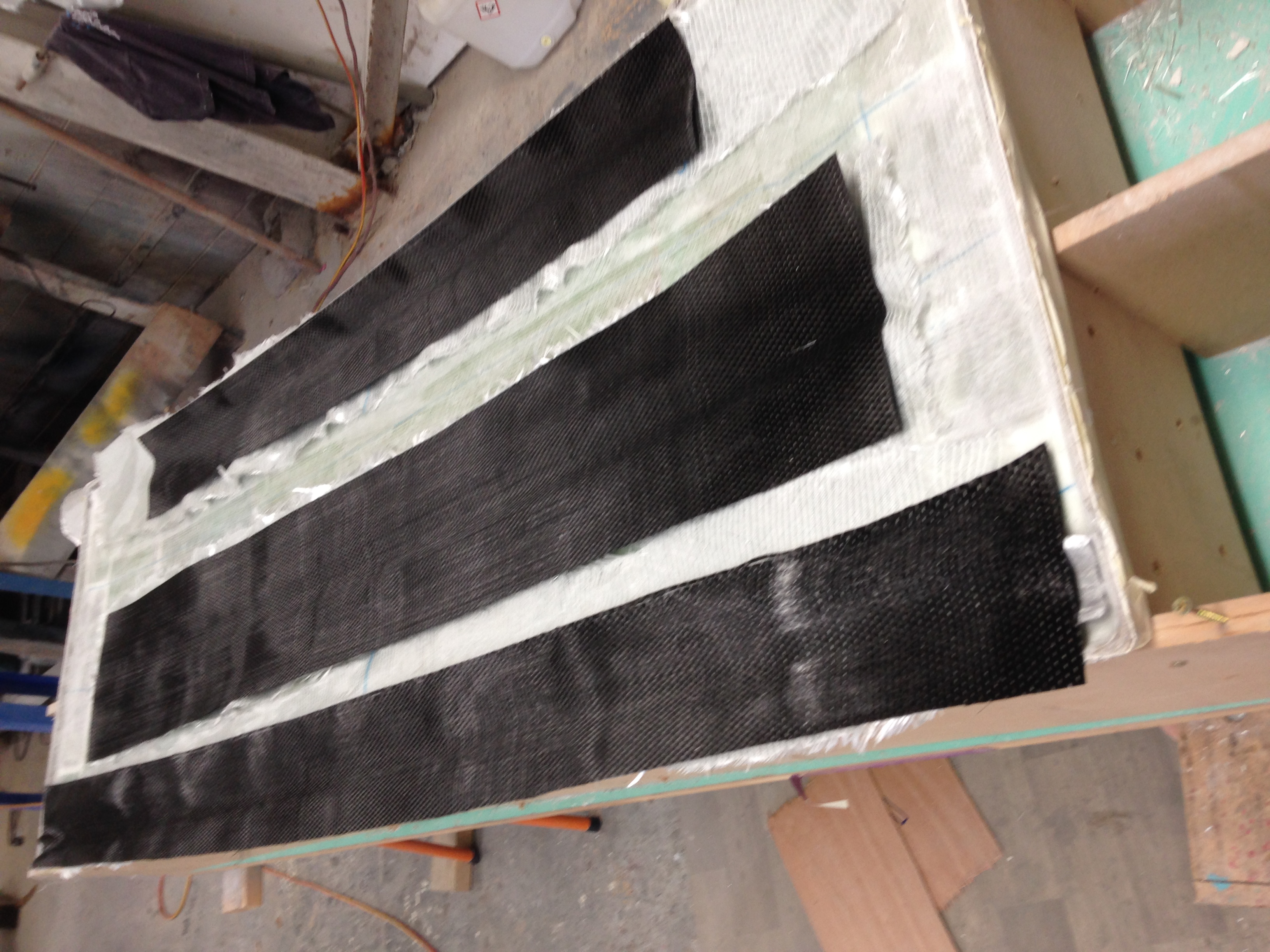

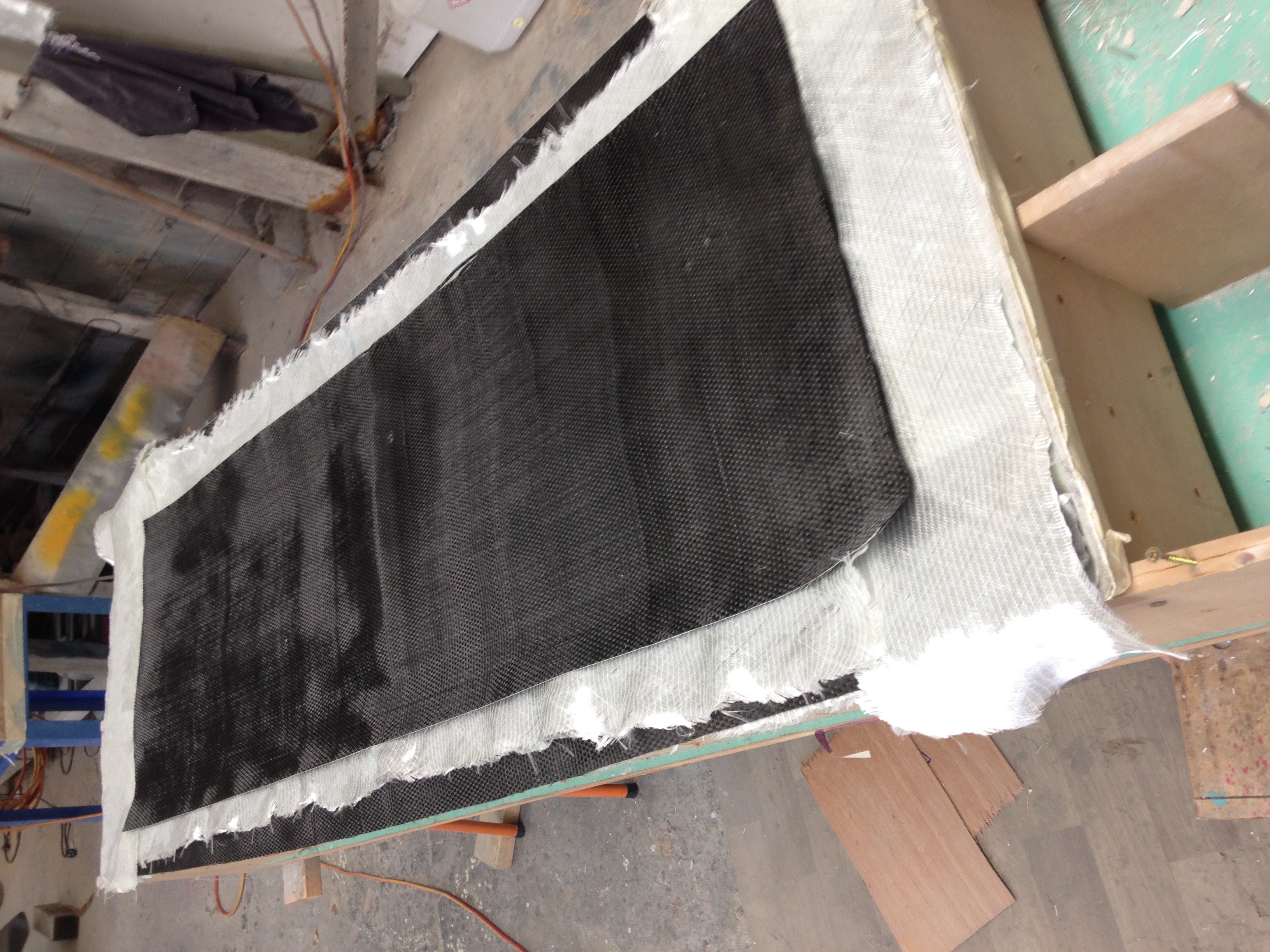

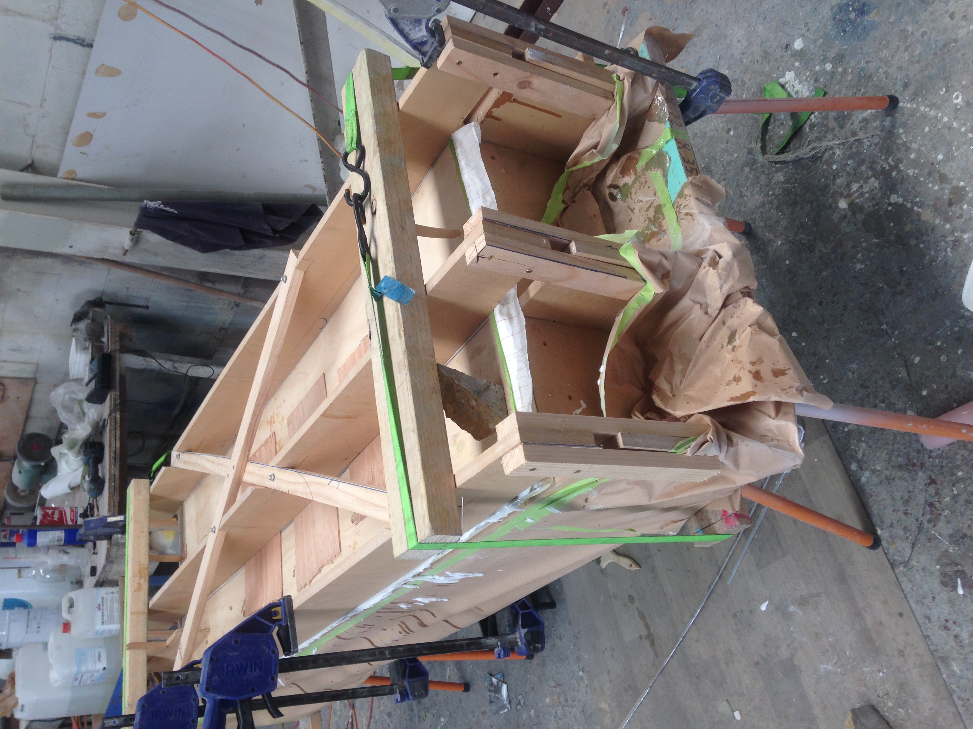

Yes absolutely and using that test will prove it to your dealer. Yep, got ours replaced today. Commissioning water maker now, a beast at 30 gall per hour. Also, did they reinforce your transom panel? Looks like our dealer mx will be doing it next week. We did get the transom reinforced by the dealer but also where the swim ladder rubs against it we are looking at a metal strip to stop the gel coat cracking.
Post by ania on Apr 8, 2019 23:58:21 GMT
Transom is off to get reinforced, Goody, our dealer is asking how did they reinforced yours. 0 particles per million H2O from the watermaker
