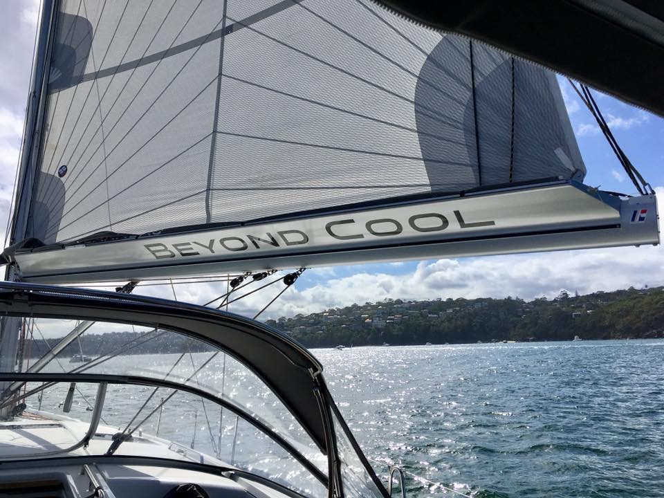

Hi Malcolm, Our boom is a Z-Spar "Park Avenue" or "canoe boom" - Z-Spar also make the other spar components for the J51 (mast, furling main boom and classic mainsail boom and vang). These canoe booms are on the options list for the Jeanneau Yacht 58 and although not on the price list for the J54, most of the stock photos of the J54 show a canoe boom installation. Quite a story how we got it actually. I had come across a blog of a catamaran in the Caribbean with one of these booms and they mentioned how helpful a Rémi Gerbeaud from Z-Spar had been. I also tracked down a pic of a SO509 in the UK with one of the canoe booms. images.app.goo.gl/6CwoyRvYfvQ4iXTX6Jeanneau directed me to Z-Spar as they hadn't tested it on a J51 and wouldn't offer it (even though I knew it worked on a SO509). So I sent an email to Z-Spar attention Rémi who not only replied but he bent over backwards to provide us with the canoe boom to match the J51 and send it out with the boat. The boom is the same boom section as the classic main boom with Al extruded wings welded to the boom section then the whole boom is painted. The spring in the vang has to be a higher capacity to handle the increased boom weight. I am aware that other J51 owners went for the in-mast furling main which is not relevant to this boom but for us with a classic lazy jack main the advantages were: 1) the main stacks neatly on the boom as it is 600mm wide 2) if necessary it is totally safe to walk on (jammed Reef or other problem possible) 3) each "wing tip" has two grooves - one for the sail bag and one for our boom tent that runs from the mast to the front of the bimini - in Cruising mode very necessary in Australian summers. 4) in racing mode we drop the sail bag and lazy jacks onto the boom "curved platform" and put belts over the top (groove to groove as the straps slide into bottom groove). - see second pic link in post above as you can see the main bag folded and secured not interfereing with lamellar flow at the foot of the main. 5) we live on a large saltwater lake which has a shallow channel to the sea so we can safely have two or three people sit on the end of the boom to provide some lean 6) a nice "canvas" for our boat name - again see last photo link in the post above 7) looks cool !!! ..... Actually draws lots of comments BTW - we thought Rémi was the most patient and helpful sales guy ever but we found out after the boat arrived that the very approachable and supportive Rémi is in fact the Director General of the Z-Spar Group !! Cheers Mark
Post by markclement on Mar 20, 2019 11:00:07 GMT
Mark Where did you source the wings for the boom? Hi SV Mrs Ed, Please see the reply to Malcolm above for some info. The wings are not available as stand alone items but as part of Z-Spars "Canoe Boom" range. We had discussed with Rémi buying the wings but he explained that the whole process of welding the wings to the boom section without section distortion etc was part of the development technology for these Park Avenue style booms compared to the carbon versions construction and associated prohibitive cost. Regards Mark

Hi Malcolm I found a better photo of Beyond Cool in racing mode with the sail bag dropped and held on the canoe boom (600mm wide) with clip straps - you can just see five of them connected to the bottom wing groove. Cheers www.23hq.com/MarkClement/photo/52823179/original

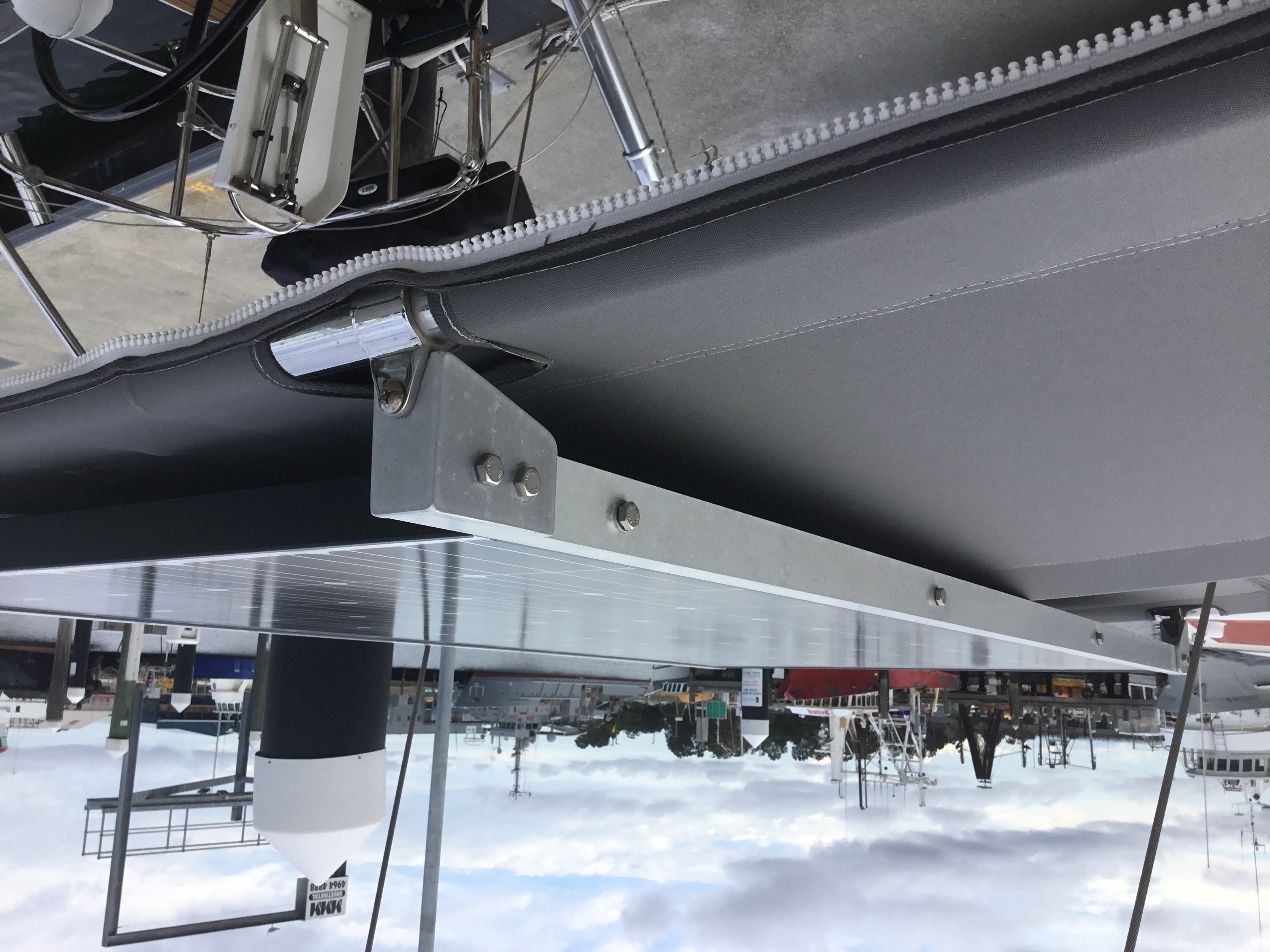

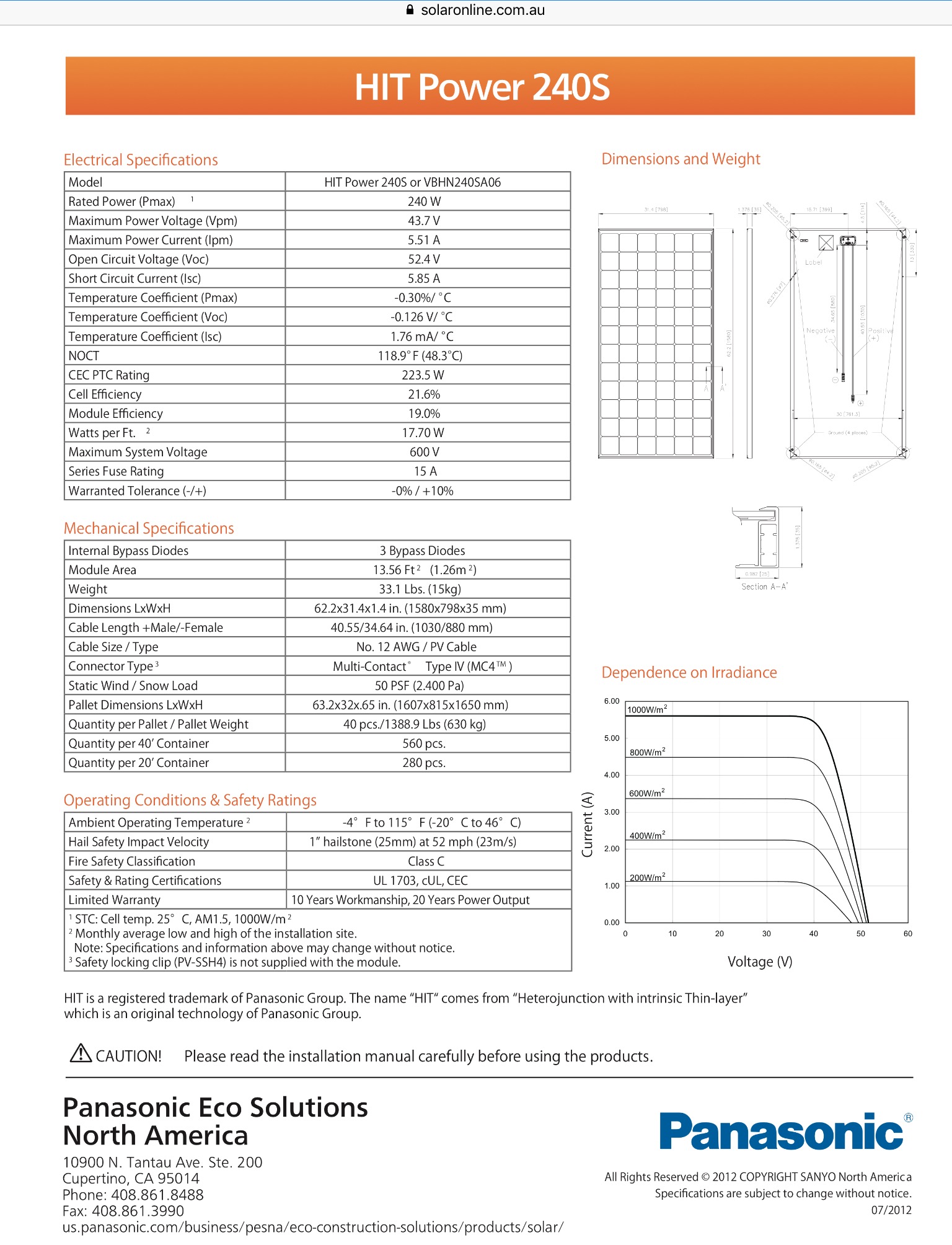

Hi All, By way of sharing our various solutions, below is a depiction of our solar setup. Not as neat or the capacity as Latitude 25's flexible setup Ania put together but we have an Australian built bimini which is full width but much shorter than the factory option with a larger infill. As a result the available length and curvature of the bimini led us to opt for a single high capacity solid panel fitting between the backstays. On a sunny day with reasonable elevation (say between 10am and 2pm) we see around 8amps into the house batteries. The system has a Victron MPPT 100/50. Because we also have a Victrom Digital Multi Control 200/200, Victron Multiplus (3000va inverter and 120 amp charger) for the house system and a Victron BMV 712 battery controller. we display all the system status on a Victron colour control GX panel. www.23hq.com/MarkClement/photo/52842295/originalwww.23hq.com/MarkClement/photo/52842322/originalwww.23hq.com/MarkClement/photo/52842353/original
