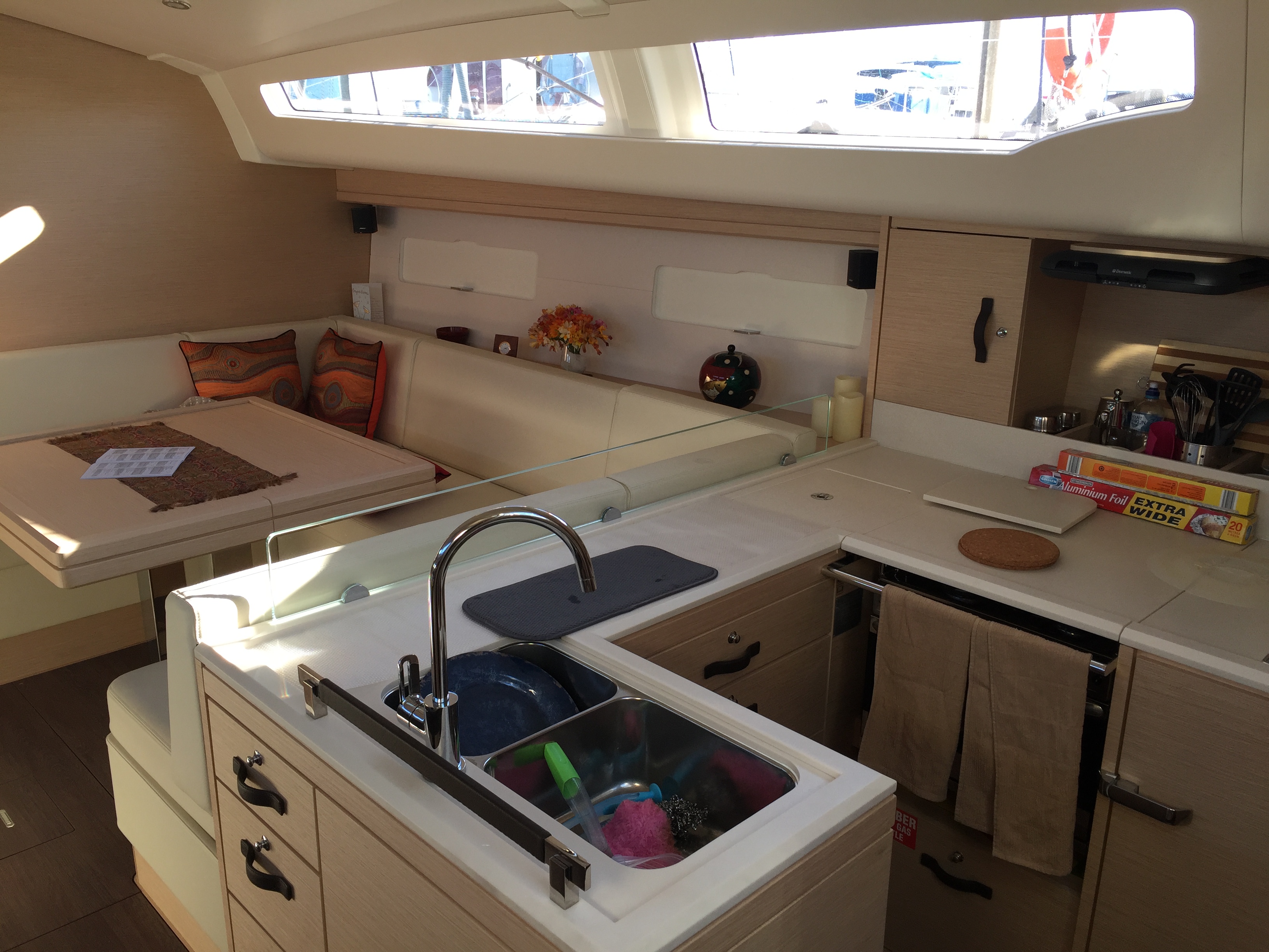

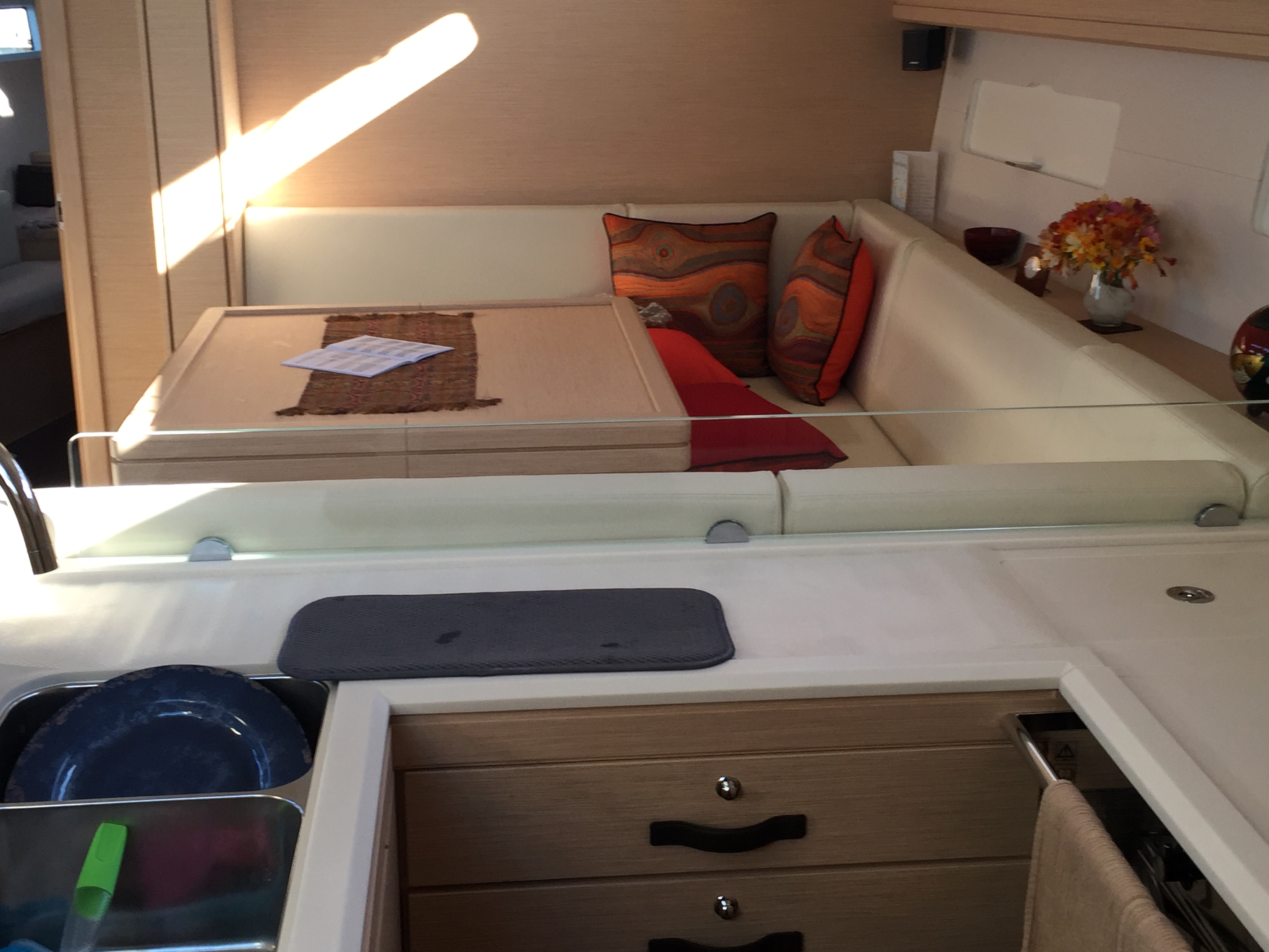

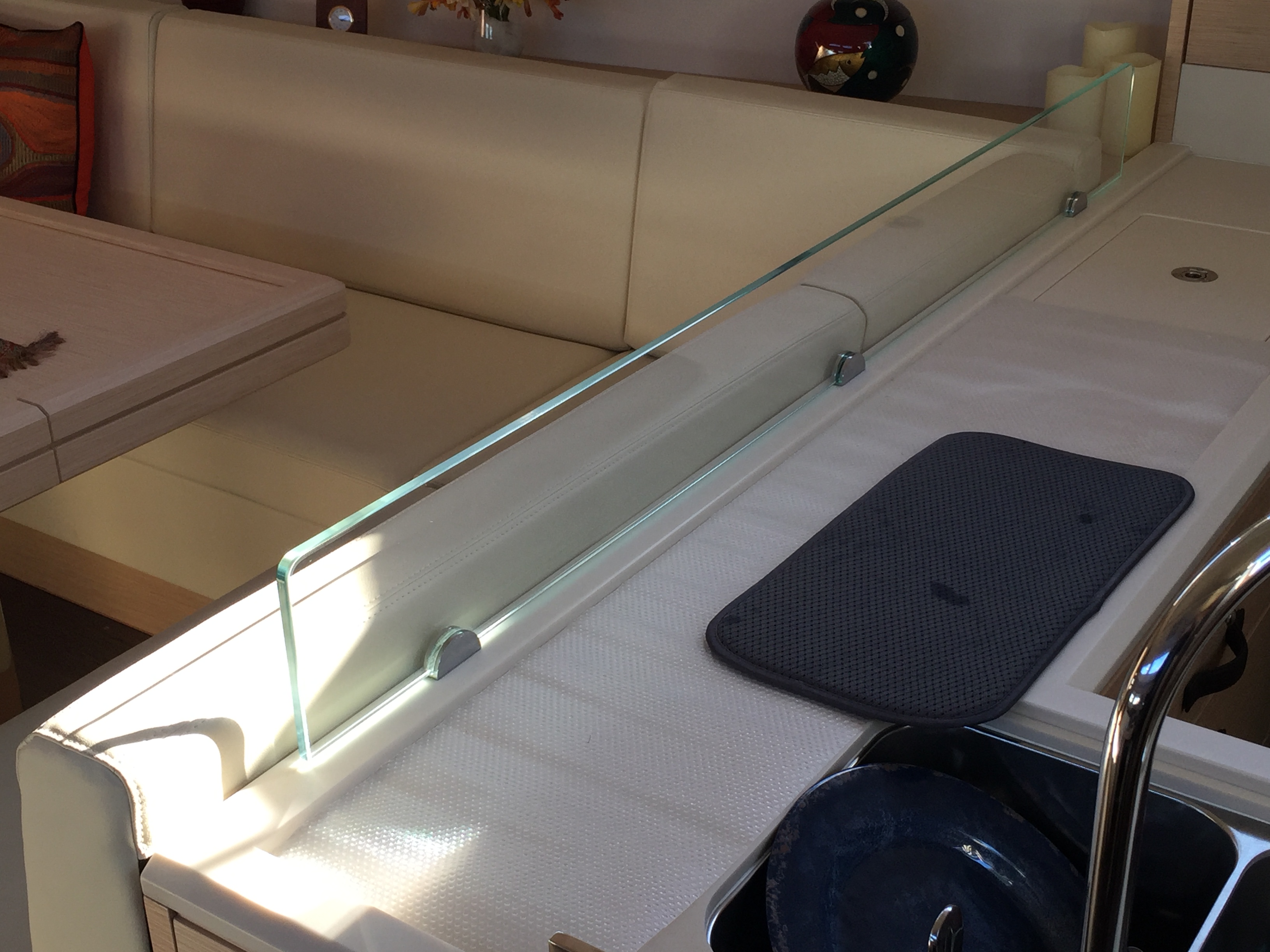

Still waiting for my code 0 but it wont be far away as everything is ordered, fittings are what we are waiting on now. We are getting a glass panel put between the bench top and the back of the seat squabs so that we don't ruin them, we had this on our 409.

Awesome, thanks for the video with the exhaust smoke and the photos of the glass. I have put a couple of quick photos up on in the J51 folder but will sort through some more. If you guys ever come to paradise be sure that you let us know, I would love to get you out for a sail and compare notes.
