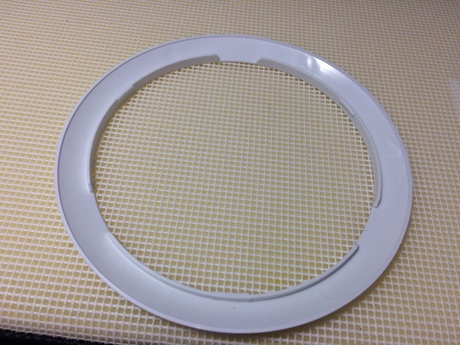

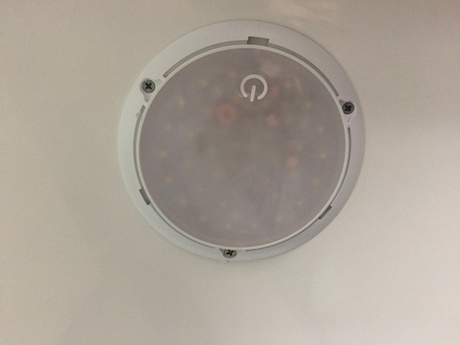

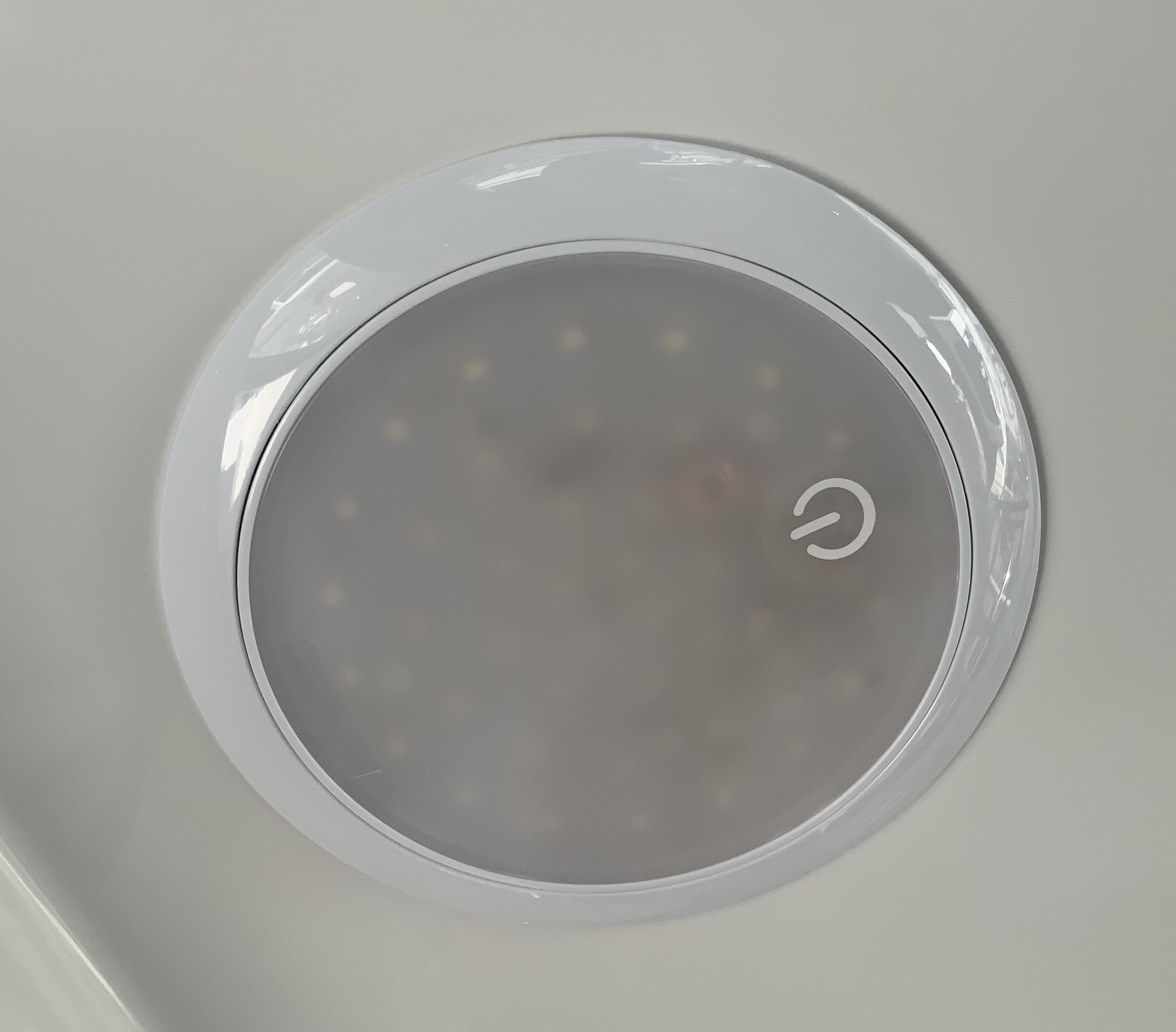

I looked on the Jeanneau spare parts site and found the LED light that can be purchased, but it didn’t have the manufacture listed. You might be able to get that info if you pull the light down and look on the back side.
Good Luck!

I looked on the Jeanneau spare parts site and found the LED light that can be purchased, but it didn’t have the manufacture listed. You might be able to get that info if you pull the light down and look on the back side. Good Luck! Added Blue LEDs in the Saloon which was super easy....Then I went to add the same blue LED out in the cockpit....Didn't realize that light was caulked in as well as screwed....It took some time to cut/slice the caulk off....I did re-caulk and screw the new light on....All-in-all it came out amazing! The underwater blue lights and now with the boat LED blue lights; makes her look amazing at night.... I purchased the new LED lights from West Marine (5 inch)….They have both the white/blue option on the
