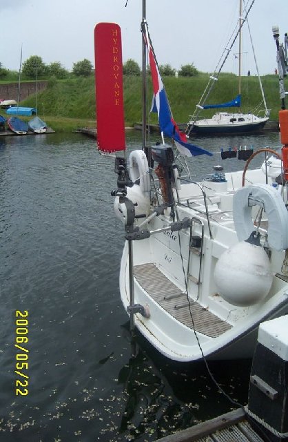

Thanks for your comments. I have now found a dutch guy who actually fitted a Hydrovane to the same boat as me!!! (SO40). So perfect. He has it off centre, so he can still use the bathing platform an access into his cockpit.

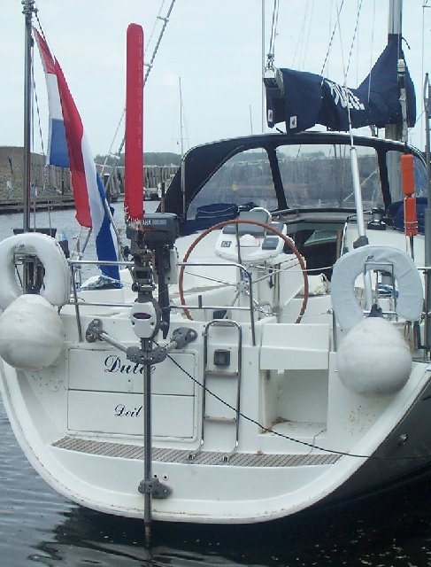

Hi, I have a hydrovane installed off centre on a Jeanneau 39DS, the vane performs very well off centre but I think at least on my boat central installation would actually have been no less convenient as regards access to the stern and would seem more correct. It is very difficult to attach the rudder to the shaft on the vane if not at rest in a marina and the vane's rudder will naturally reduce the boats manoeverability in close quarters unless you have a crew member available to manually operate the vane. I would recommend a vane if you are going to do passages longer than perhaps 24 hours in open water, otherwise use an electronic autopilot. The Hydrovane website has lots of very useful info on installation and use of the hydrovane and the Hydrovane management are very helpful. Overall a very good piece of kit, and a spare rudder in an emergency. Hope this helps............

Any possibility we can get some photos of the off center & center installations?

I wonder if anyone has fitted one of these to a SO 43 DS ? Any photos would be appreciated.
I have checked the Hydrovane website but nothing there.
Thanks
Post by On y va on Mar 19, 2014 22:05:51 GMT
I wonder if anyone has fitted one of these to a SO 43 DS ? Any photos would be appreciated. I have checked the Hydrovane website but nothing there. Thanks Yes, a dutch 43DS "Sailing Dulce": www.sailing-dulce.nl/home/2

I had some back & forth dialog with Hydrovane last week. Great folks, but a little out of my budget right now. I liked the idea that it was an independent system and not tied into the boat's steering. A good backup if you were to loose your steering, but at close to US$7000, there is a price to pay. We have an arch, so it would mean mounting the RIB on the foredeck for the long runs in order to use the Hydrovane. If you are mechanically inclined, a DYI installation should be a low challenge project. They sent many photos, including one exactly for the SO42DS in an off center position. With removal of a few bolts, the unit can be removed and stored when not in use. I asked about a hinged swing to the side version, but they did not recommend it...another joint to wear, etc.

I got a couple of pictures from Hydrovane earlier Hopefully they can be seen ok
