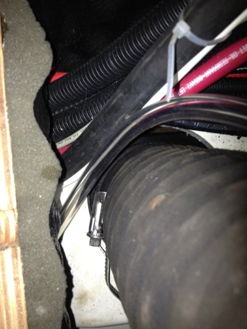

Post by Tafika II on Jul 25, 2013 21:45:15 GMT
Problem fixed  Based on this Jeanneau Owner’s & Cruiser’s Forum comments & suggestions, I re-inspected the systems again. It looks as if I had two contributing factors. The Vetus non-return pressure valve had stuck open & dumping salt water directly into the under-bilge. I cleaned the value, ordered a new one for replacement and attached a 22’ long 5/16” ID water hose ($0.76/foot + clamps…pretty cheap fix) to drain into the forward bilge pump sump area. Why Jeanneau thought it was a good idea to dump salt water into the under-bilge is beyond me. Had there been a general failure of the valve, the boat could have flooded. For an additional $25.00, this could have been avoided if Jeanneau have run this hose overboard or directly into the bilge pump sump area. The second problem was harder to find. I saw a rivulet of water exiting the exhaust hose where it enters the water muffler. While tightening the clamps, I noticed the entire male fitting was loose. I removed the hose clamps, hose and fitting (easily removed by hand…no tools). The threads looked to be sealed with standard plumber’s putty. There were no cuts, splits or gouges on the “O” ring. I inspected the fitting and receiver box for any crack….none. After cleaning the male & female threads & an “O” ring, I applied a vibration resistant Rectorseal 4-oz. Tru-Blu Pipe Thread Sealant to the male and female threads. I applied a generous amount of silicon grease to the “O” ring and “O” ring seating area and reinstalled the fittings & hose. No leaks. The under-bilge did take a few sailing trip to finally empty, but it’s basically dry again. Thank for everyone’s help!

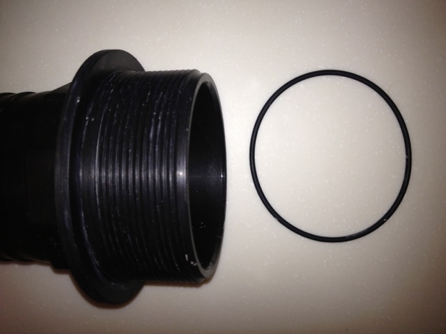

Post by Tafika II on Nov 20, 2013 15:02:24 GMT
Well...just when I thought this was over... The same salthingyer leak at the wet muffler reared it ugly head again, so pulled it apart one more time! It seems the thread sealer…Tru-Blu Pipe Thread Sealant, while stating it was suitable, was not. It deteriorated in hot salt water and the diesel gases and attacked & destroyed the “O” ring. I cleaned both threads thoroughly, applied Permatex 99839 ULTRA BLACK (it is a silicone & oil resistant) at the suggestion of my local service yard, as that is what they use. I replaced the “O” rings (Silicon O-Ring with temperature range of -65° to +425° F; Durometer hardness of A70; 0.139” Diameter thick x 3.359” ID and 3.637” OD). Once again it is fixed…Let’s hope I don’t have to update this again.

Post by Tafika II on Jan 4, 2014 0:59:02 GMT
OK, it leaked again, so this time I threw away the book and used my brain...what's left of it. It seems the design enables the "O" ring to grab and not seat properly, no matter how much Permatex 99839 ULTRA BLACK you put on. I cleaned up the threads ID & OD and again applied the Permatex, only this time I left the "O" ring gasket off, but put a extra generous amount against the thread/flange angle. I tightened it up, reinstalled the hoses and left it sit for 48 hours. Started the engine...no leaks (been there, done that), vacuum the watered out of the bilges and went sailing for a week. It has now been 4 weeks since I did this final fix and it is not leaking at all. I'm still checking it regularly but I think this is the fix. Have a Happy New Year and pleasant sailing in 2014!
