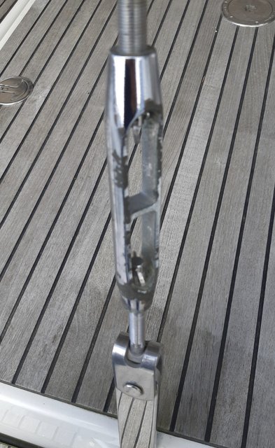

Hi, any idea what brand can be the backstsay turnbuckle for a 2016 SO479? Attached a photo.

To the original question: this looks like a ZSpar item. If it is there should be a “Z” logo on it. My problem was the cap shrouds being seized. It took three weeks of work to free them up. Pretty much daily applications of penetrating lube ( corrosion X, PB Blaster etc) and repeated heating with propane torch to get them moving. Apparently not a rare problem with these turnbuckles. My issue was having to replace my jib furling drum. I was able to release the headstay by loosening the backstay. But reattaching the headstay was impossible. I needed to loosen the cap shrouds due to the swept back spreaders keeping the mast back. Once these were loosened I still had to totally disconnect the backstay. This allowed me to connect the headstay. Reattaching the backstay wasn’t too hard once I tensioned the shrouds and used various halyards to pull the top of the mast back.

They are Z-spar turnbuckles. On the boat I just bought, 5 of 6 were frozen, and the rigger working on it required heat and penetrating oil to free them up. He recommended changing them out...he's not a fan of Z-spar turnbuckles (because they freeze up)...
