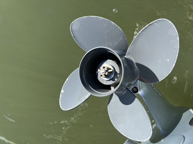

I know I should be getting more out of the engine than this? I did inspect the propeller today and the locking nut is slightly loose along with the silver washer underneath that seems to rotate as it’s not tightened down enough! I know this shouldn’t be the case so will tighten that up tomorrow (not sure how much of a difference that will make tho).
I’m running a 4 blade prop 14.75 x 15” prop. Went around looking at other Merry fishers and they are all running 3 blade props. Some with the same pitch as my 4 blade, others with a 17” pitch.

I did inspect the propeller today and the locking nut is slightly loose along with the silver washer underneath that seems to rotate as it’s not tightened down enough! I know this shouldn’t be the case so will tighten that up tomorrow (not sure how much of a difference that will make tho) Are you saying the propeller nut is loose? If you can wiggle the propeller (in/out), or if the propeller is mounted incorrect you could get strange issues with cavitation etc. I have never seen this myself, I was just told the same from the prop manufacturer when exploring issues ourself. The thrust-washer can spin on the shaft, however, you should not be able to see or tutch that with the propellers on? Maybe I missunderstand the "picture" your painting. 😉
Post by lynnardm on Aug 10, 2022 23:10:17 GMT
GK
Yikes a loose propeller nut? Yikes that’s a concern. Not sure if that could cause damage or not but don’t use the boat like that. Pull the propeller and check the shaft and spline and large thrust washer and the propeller spline and load surfaces for wear or damage. The torque requirement is provably around 35 ft lbs if not more. You are likely set up with the wrong propeller. That performance is terrible. You should not need 4 blades and that along with other propeller characteristics like perhaps too big a diameter for 4 blades is likely the culprit with your performance. Hopefully the loose propeller is also not contributing.

Appreciate the feedback all! I’m determined to sort this out! 😂 So from looking at the picture, there is a little bit of play in the propeller locking nut (left and right). The silver washer underneath the nut appears to rotate when I turn it, presume that’s because the nut isn’t tight enough. I’ll get that sorted! There doesn’t appear to be any play back and forth on the prop itself. I will lift it and take a closer looks at the drive shaft etc! Other that that I’m running out of ideas. If all else fails I’ll take it in to a yard and get someone to take a closer look and (or) perhaps come out and run some tests on the water with me!

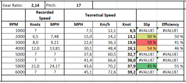

Made a quick spread sheet for your outboard (assuming the gear ratio is 2,14) I now tried to post a picture, and realized I have never done that on this forum before. :-) So if there is no picture here, I have failed. However, the numbers are as expected really bad. you can expect a high slip between the hull speed (6kn) and on plane speed (13-14kn?). However you have a high slip all over. Your propeller is spinning and using most of the energy to make bubbles and sound, and less energy on the movement. Looking at the theoretical speed on the prop's at 5800 rpm the boat should be moving 37 knots at 0 slip. Boat normally have between 5 and 20%, giving the top speed with this prop 30 to 36 Knots. I do not dear on guestimating what props you should go for, but the one you have looks to have to little blade area and to high pitch. Before continuing to examine, make sure the propellers are installed correct. Did you try to tilt the engines up? Do that have any effect?

Made a quick spread sheet for your outboard (assuming the gear ratio is 2,14) I now tried to post a picture, and realized I have never done that on this forum before. :-) View AttachmentSo if there is no picture here, I have failed. However, the numbers are as expected really bad. you can expect a high slip between the hull speed (6kn) and on plane speed (13-14kn?). However you have a high slip all over. Your propeller is spinning and using most of the energy to make bubbles and sound, and less energy on the movement. Looking at the theoretical speed on the prop's at 5800 rpm the boat should be moving 37 knots at 0 slip. Boat normally have between 5 and 20%, giving the top speed with this prop 30 to 36 Knots. I do not dear on guestimating what props you should go for, but the one you have looks to have to little blade area and to high pitch. Before continuing to examine, make sure the propellers are installed correct. Did you try to tilt the engines up? Do that have any effect? Thank you so much for taking the time to do this! I’ll take a screenshot of this and take it with me if I go into a yard and get it looked at! Unfortunately I didn’t get a chance to run anymore tests today. The prop must be slipping if it’s not giving me that power but I can’t see why! When I installed a new propeller towards the end of last year everything looked fine! Plan at the moment is to change over to a 3 blade prop (pitch to be decided) and run another test. If I’m still seeing poor results then I will be going to my local Jeanneau dealer to have a look at the engine and try and get them to narrow down the problem. Hopefully nothing too serious! It’s only done 97 hours so far! In regards to the prop slip it doesn’t feel it sound like the prop is slipping, but I’m not an expert on this, only from what I’ve looked up on YouTube etc… The engine runs but once I hit that 4000 RPM marker it just isn’t delivering the type of speeds that I should be getting. Just seems like the engine is giving it all and the boat is just dragging away at 12/13 knots. It’s the same at WOT, will only hit 21/22 knots at 5800 odd RPM. there isn’t any feeling or sound of the prop slipping… or maybe I don’t fully understand how prop slip works or sounds! 😅 not sure why the picture down below is to the side but that’s my RPM and speed as shown on the nav system just to show! So frustrating! 😫

From the web Propeller slip is the difference between the actual distance the prop travels forward through the water versus the distance it should theoretically travel based on the prop blades' angle of attack. The theoretical travel is determined by the prop pitch.

Post by thehammer on Aug 12, 2022 6:24:44 GMT
Further, I looked at the Performance Bullitin from Yamaha on the 695 with 115HP. They have used a 13 1/2 x 14 Alu propeller, and got 32 knots. View AttachmentThis looks like a 605! But still, the RPM’s compared with the speed same to match correctly! You are correct.. Thanks.. I dont know how I managed to screw that up. I will try to find 695 in stead.

The interesting thing about that definition of slip is that it is so universally written in all kinds of books and articles over so many years, yet has so little relevance to the physics of how a propellor works, and hence adds very little to our understanding of the issues involved.
I am sure it is of some help for a beginner to understand the concept of pitch, but I suggest it is more useful to think in terms of a thruster device rather than a screw.
The propellor produces thrust which pushes the boat at a speed where the hull residence or drag equals the thrust. It produces a thrust whether the boat is still tied to the jetty (100% slip, don’t try this with a high power engine!) or on a sail boat motoring sailing hard enough that the slip factor would conceivably be negative. The thrust at a given propellor rpm does vary with boat speed, but there is no direct relationship between boat speed and rpm as there is for a car for example, unless it is in a skid pan. Slip is just an observed correlation between pitch speed of advance an actual boat speed but not much help in prediction except for very similar boats.
So how does a propellor produce thrust? I suggest it comes back to Newtons law, you know the one about bodies moving in a straight line unless acted on by an external force? The property causing things to continue moving in that straight line is called momentum, and mathematically it can be given a value by multiplying the mass of the body by the velocity. Providing consistent rational units are used, a change of momentum per unit time is exactly equal to the force required, or in case of the propellor, the force produced. The maths is surprisingly simple. The whole principle is more neatly stated as the principle of conservation of momentum. Not as well known as conservation of energy, but equally universal (along with three other conservation laws that so far are believed absolute and universal.) Application of this law allows physicists and engineers to determine separate equations that simultaneously apply to help solve problems.
In the case of a propellor, the propellor geometry, and rotational speed combine to move water that is stationary ahead of the propellor, or if you like, approaching the propellor at the boat speed, and accelerating a mass of that water in the direction of the back of the boat at a higher velocity, also causing it to move in a spiral direction in the process, but the linear direction is the important one in this context. The mass of water accelerated by the propellor depends mostly on the diameter of the propellor and the speed of the boat, with blade pitch, profile and area, all having important effects. The pitch has to be sufficient for the water pushed out of the way to have to end up moving in the required direction.
But I detect a hint in your post that you knew all that, so back to the original problem.
So to the original poster, G K Dawson, yes, pitch and diameter do make a difference, both to the thrust produced and to the power required to turn the propellor. As always with any theory, the proof is in the testing, and there is always an efficiency factor which always means less effect than you might expect. In this case, the actual thrust at any boat speed compared with a calculated factor. The theory is simple and exact, but there is a problem determining just how much water is accelerated by the propellor, and how high the resulting velocity.
It is very difficult to even compare well documented test results. In this thread, three sources are quoted. The Yamaha test at the end for example, the lower power of the engine is not important as it was obviously adequate, but apart from the boat model, the gear ratio quoted is different from the gear ratio quoted for the 150 hp model. And the internet yields a different ratio from that quoted in the early post of the thread for a 150 hp model, so first step is to determine the right ratio. I assume there are sub models intended for different applications. It is the propellor rpm that counts, engine speed is only an adequate proxy if the gear ratio is the same.
Certainly your results certainly seem to indicate a mis-matched propellor, but the suggestion of increasing diameter and pitch worries me. That will require more power. It is interesting that the motor seems to have reached its expected full throttle operating speed, so the power requirement seems reasonably matched, but the speed result suggests either a badly trimmed hull or badly over weight, or more likely, a different diameter and pitch combination is required to get more thrust with the available power. Diameter to accelerate less water, pitch to accelerate that water to higher velocity. Rather than try and guess, I would also suggest going to a reputable propellor manufacturer for advice and recommendations, They have special sophisticated software for predicting the performance of their propellors, and will come much closer than any of us to selecting the right one. A good one may even have a records and data for similar boats, suitable loan propellor for testing or other approach to helping you get the right prop. It is worth re-reading Capt’n Lynn’s thread on his latest propellor adventures. It is most interesting and illuminating.
