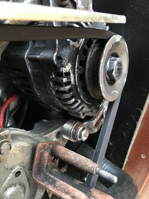

It’s been a niggle for a while, alternator belt adjustment, it is doable but not easily, and I never liked the idea of a belt change in a choppy sea, the bolt head for the adjustment , on a ‘banana’ bracket faces aft, and with insulation and bits of engine in the way makes for a three socket extension plus universal joint assembly ,( or a strange shaped spanner) to loosen it, and someone else to keep the socket on the bolt whilst attacking the pesky bolt from within the aft cabin. Whilst fiddling , fitting new belts , pump impeller and primary filter, it dawned on me that it needed re modelling. Pic shows a pack of stainless washers making about an 18mm stack , ( titanium spacer to replace the washers when a lathe and materials come to hand) and a M10 x 50mm long bolt (titanium replacement also required) to move the adjusting bracket to the fore, rather than its original aft position relative to the alternator, means you can now get a spanner on the bolt head, with no assistance, it’s accessible! Stupidly simple, and makes the belt adjustment so much easier, why didn’t I do this two belts ago I wonder? Excuse the rust on the hose bracket, ………. it’s French you know ! And no idea why the picture is on its side ….. I sail boats and no idea how to drive a computer/ ipad, just rotate it 90 deg clockwise for proper orientation . Could be a unique thing to the SO 35 2006 Yanmar 3YM30 ……. but probably not. CB

Good idea. i had this problem! I just need more washers...........

Charlie,
Not unique to your model. Their is a post pictures in a Sun Dream 28 FB page staring yesterday about a similar issue.
With boats in the 20+ yr bracket, seeing some picture of 30-40 year old motors, not surprising some maintenance is needed. A bit of rust here, older heated up parts, things get out of alignment, rust eats into belts, making the wear or break pre maturally.
A few also have the bolt on engine side vs easier to get to front motor side.
Will look at my setup tomorrow to see if I don't have some of these issues with my 85 2gym.
Marty
Post by Charlie-Bravo on May 15, 2022 20:53:44 GMT
One enterprising chap on the forum here found an even more elaborate solution, and put a hatch doorway in the shower enclosure ….. which also gives better access to the heat exchanger , but quite a lot more of a project than a stack of washers or spacer.
