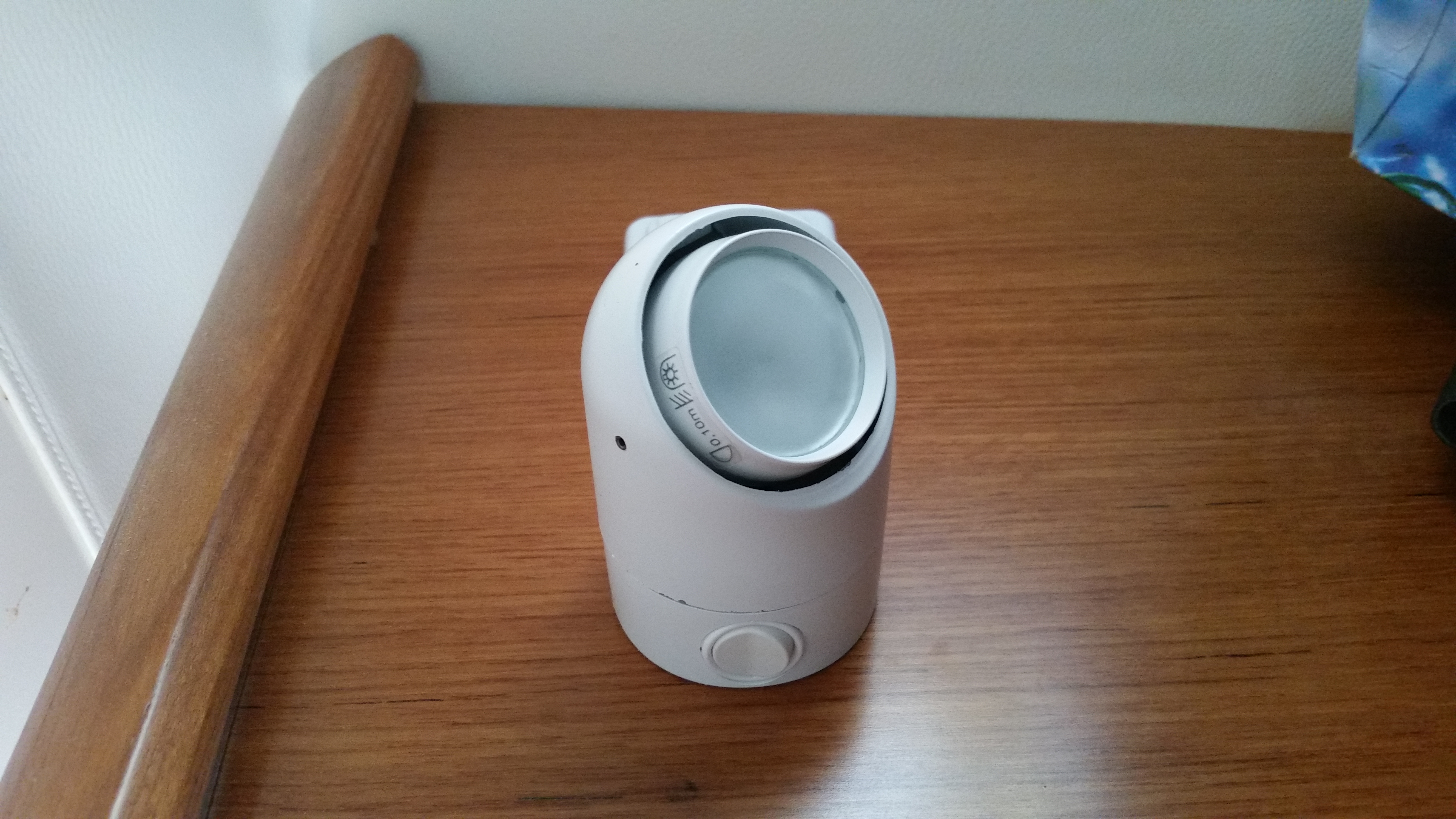

Hello all, I recall seeing this question answered a couple of years ago, but I can't find the thread. I would like to replace the halogen bulb in the reading lights in the aft cabin of my SO35 with LED bulbs, but I can't for the life of me figure out how to open them. A picture of the light fixture is at the link below: www.23hq.com/ReverieSO35/photo/59030792/originalAny hints on how I might open these lights to access the bulb would be tremendously appreciated! Many thanks, John Reverie - 2004 SO35

All you have to do is grasp the inner ring and rotate it 1/4 of a turn counter-clockwise.

Perfect. Thanks, Don.
I had tried that and it didn't budge. I give it a little extra 'encouragement' when I try it again.
