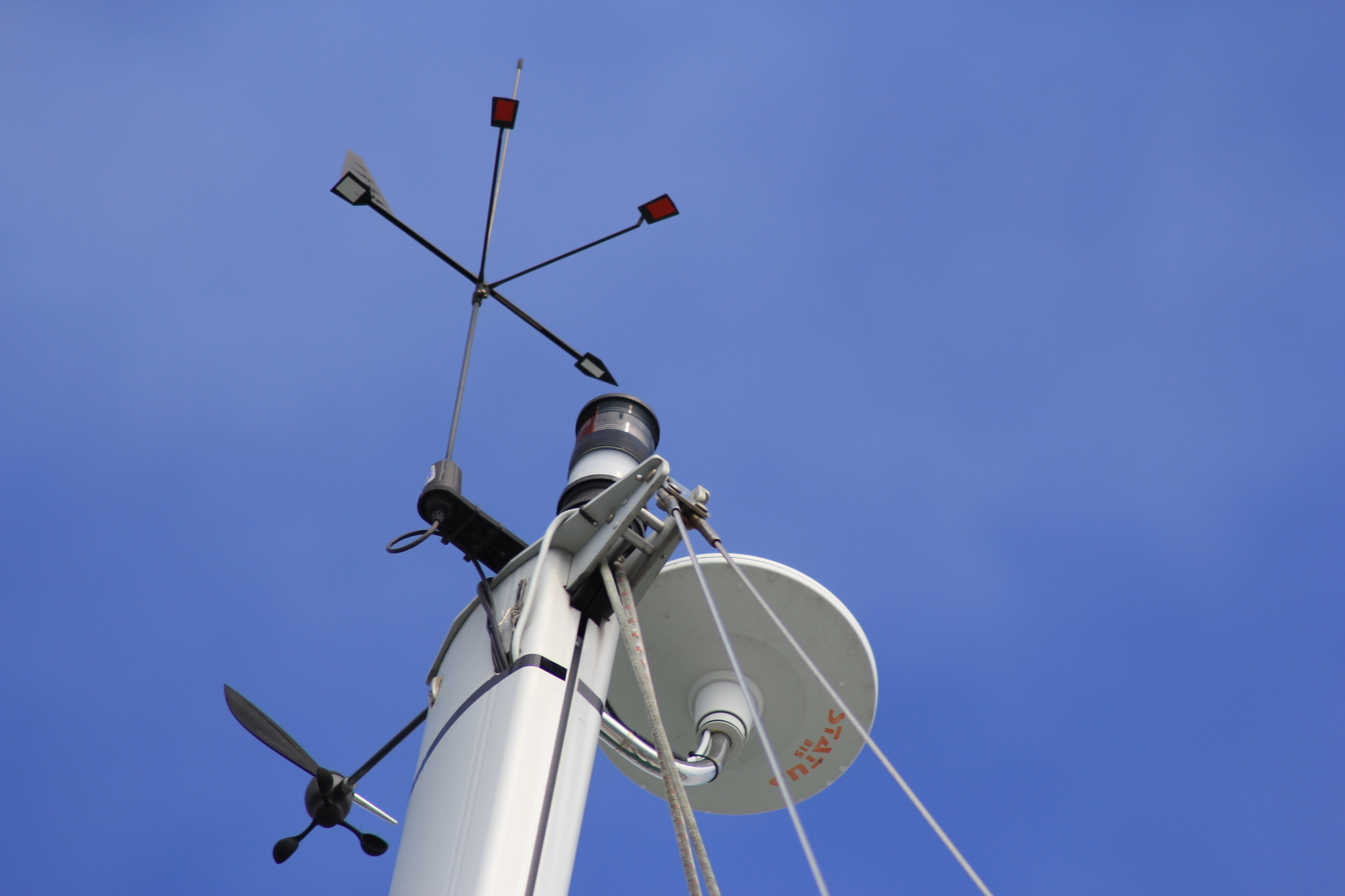

Post by voiceman1uk on Jul 29, 2019 4:25:44 GMT
Hi www.23hq.com/Voiceman1uk/photo/57881812/originalif you pm me I can send you a picture of mine (I have a 2007 42i) I replace mine with a dusk to dawn led from these folk were very helpful and was able to identify from the picture what bulb I required just found the way to upload an image 😀
