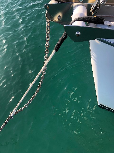

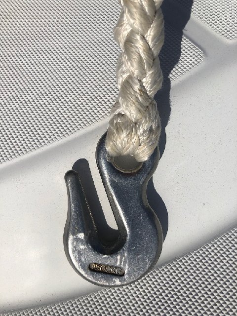

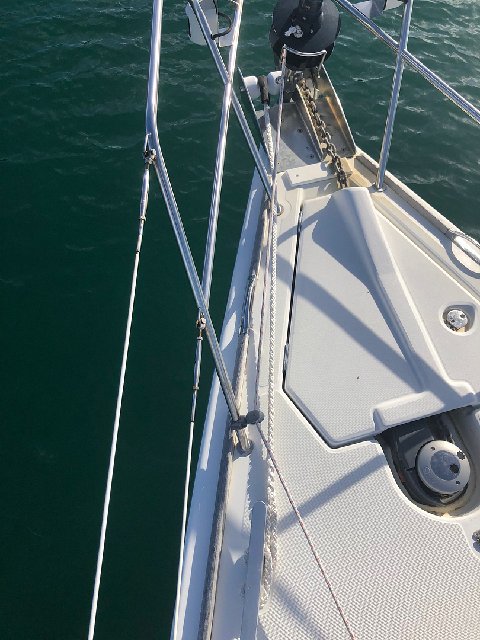

Any suggestions for a snubber hook/shackle? I have a Spade anchor and generally ride on 100% chain. I am concerned with the loading because the anchor “does not give”. Happy with the anchor, worried about the loading.

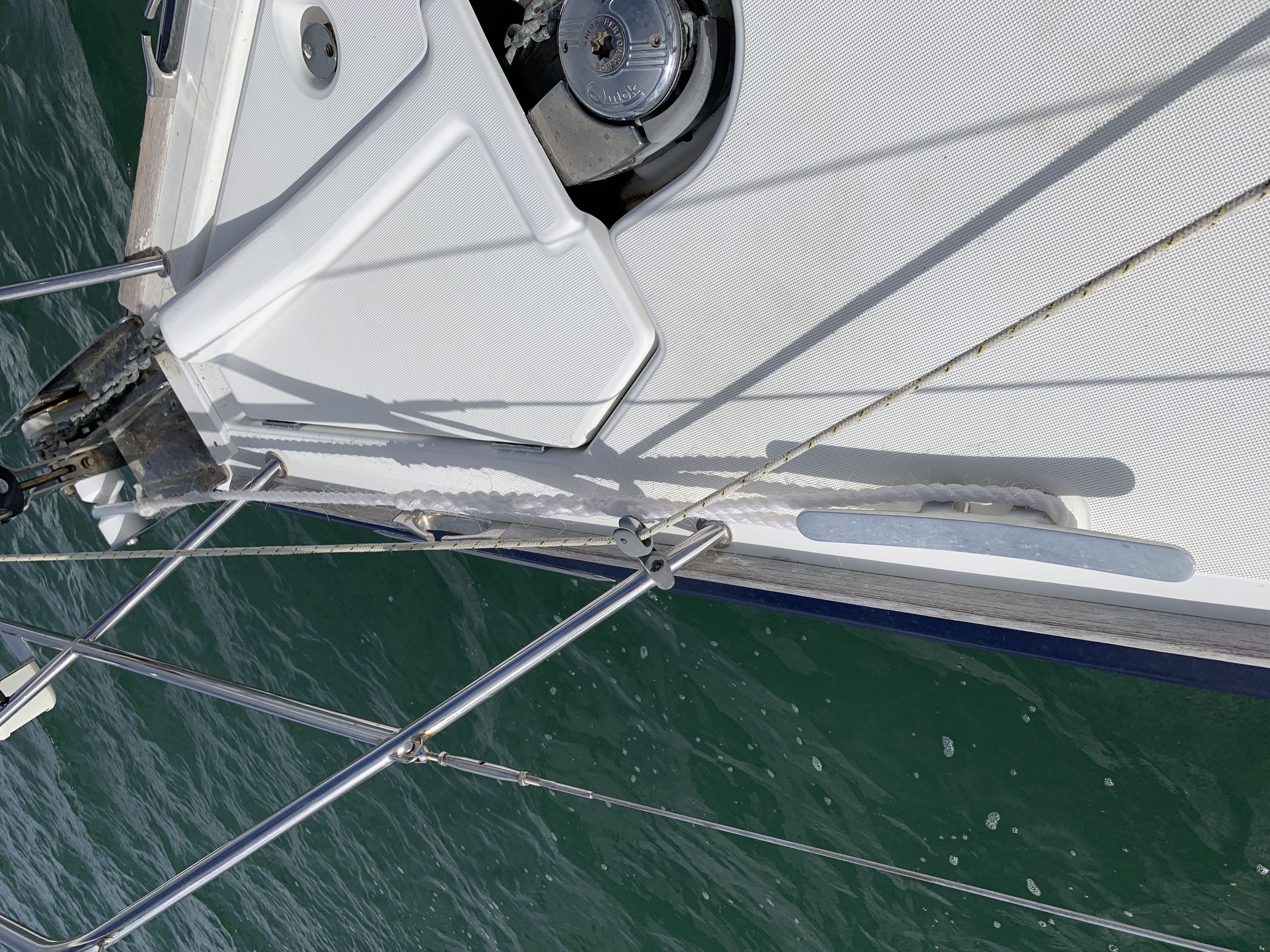

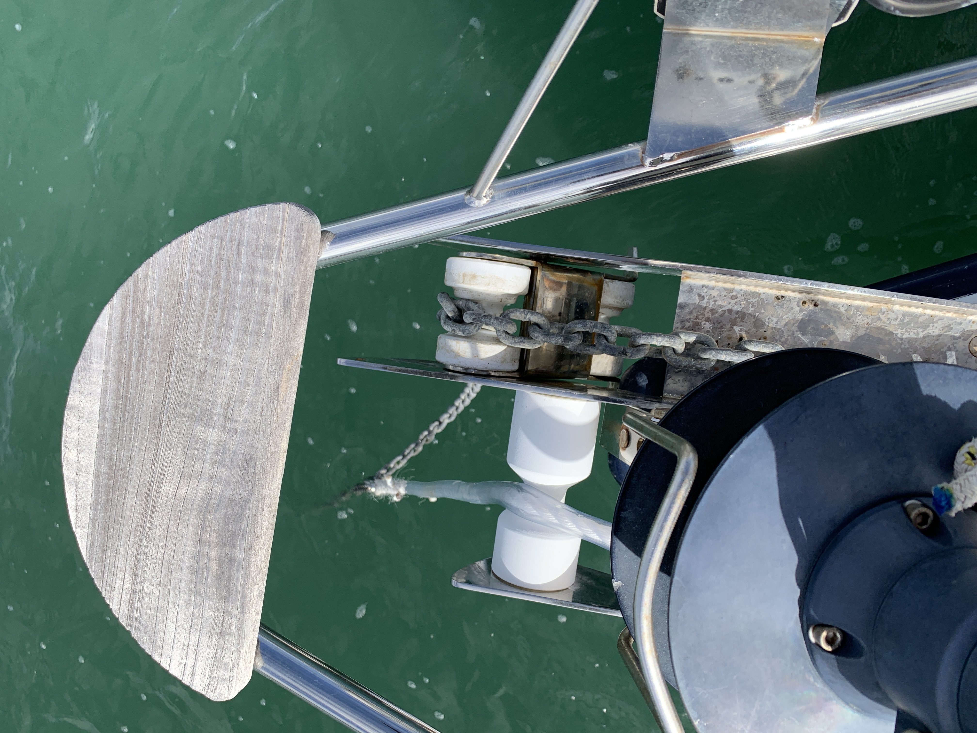

Here's my set-up. Works a treat in light and heavy conditions. Note 1500kg hook and anti-chafe sleeve.
Post by jy51 on Jul 15, 2019 12:39:46 GMT
Great pictures but I have two comments, number one, did you do the splicing yourself, if so hats off to you, all my attempt look like a dogs dinner, secondly I would be a bit concerned that your pulpit seems to be taking the load, in a very heavy blow and sea it might give way.
Post by NZL50505 on Jul 17, 2019 0:36:21 GMT
No I had the splicing done by a rope pro!
Yes there is a small amount of deflection around the pulpit but I've worked on the basis it's so slight that the lateral load is very small. But next time there is a decent load on the snubber I will check how much lateral load I can feel and if I'm worried then I might run the snubber over to the stbd cleat instead.
