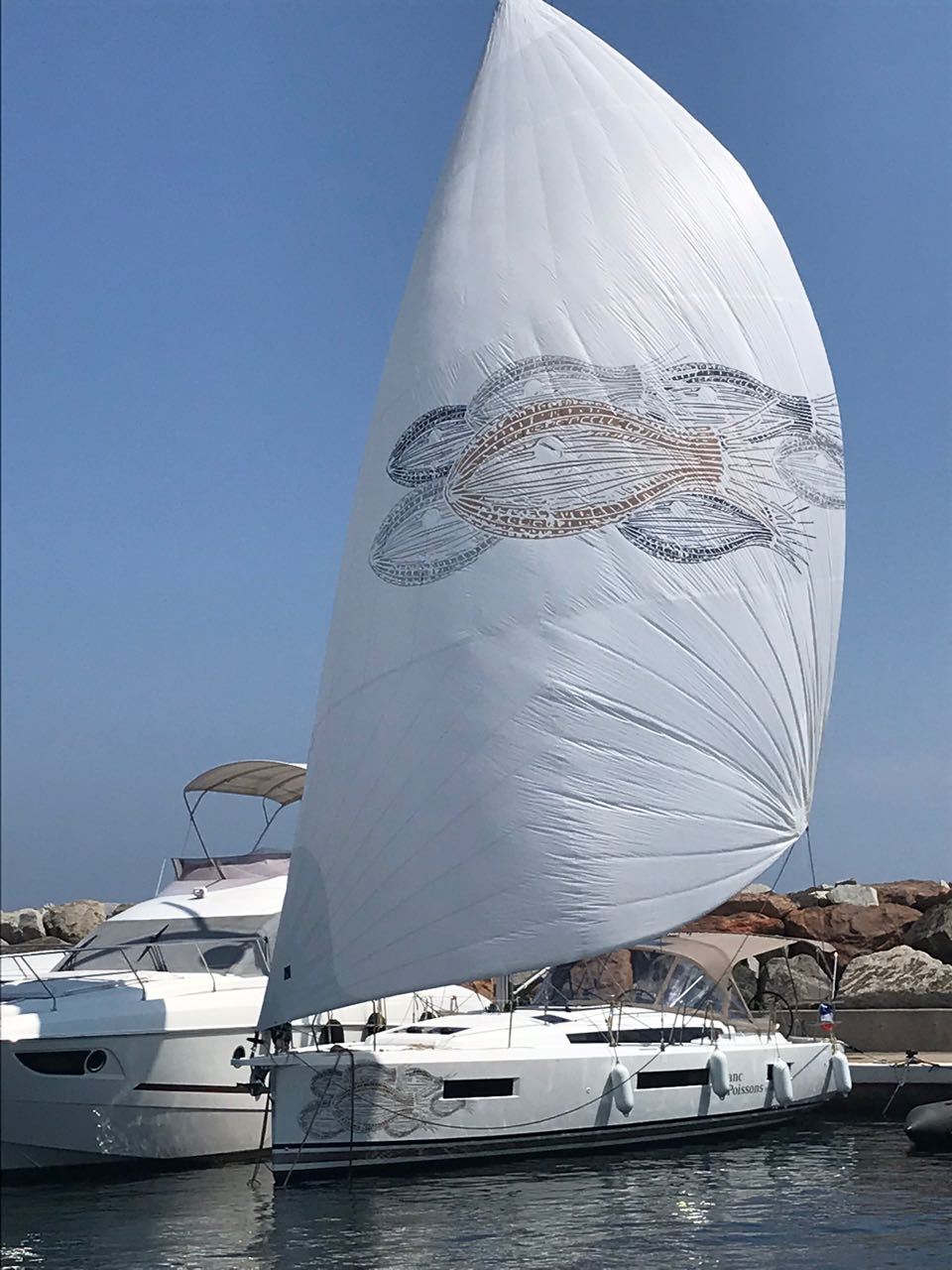

Post by Fabrice-Erta on Jul 27, 2019 10:38:22 GMT
Here we are !!!! The boat has been delivered :-) SHE is really special. Not enough time to sail as much as I would but 2 trials, one when getting the boat from Port-Frejus to Les Issambres. Another to test the A3 quantum sail. At the end only some minor points to be adjusted / corrected. The support from Jeanneau factory was great to deliver the special "deco" we have done. I believe any one could recognize us. Thanks a lot to Mr SUBERVIE who was very supportive to expose his creations. A special thanks to JY51 and all his advices especially for the AC which has been successfully tested these last days..... Waiting for my holidays to sail more !!! www.23hq.com/fabtarga/photo/57811980/original
