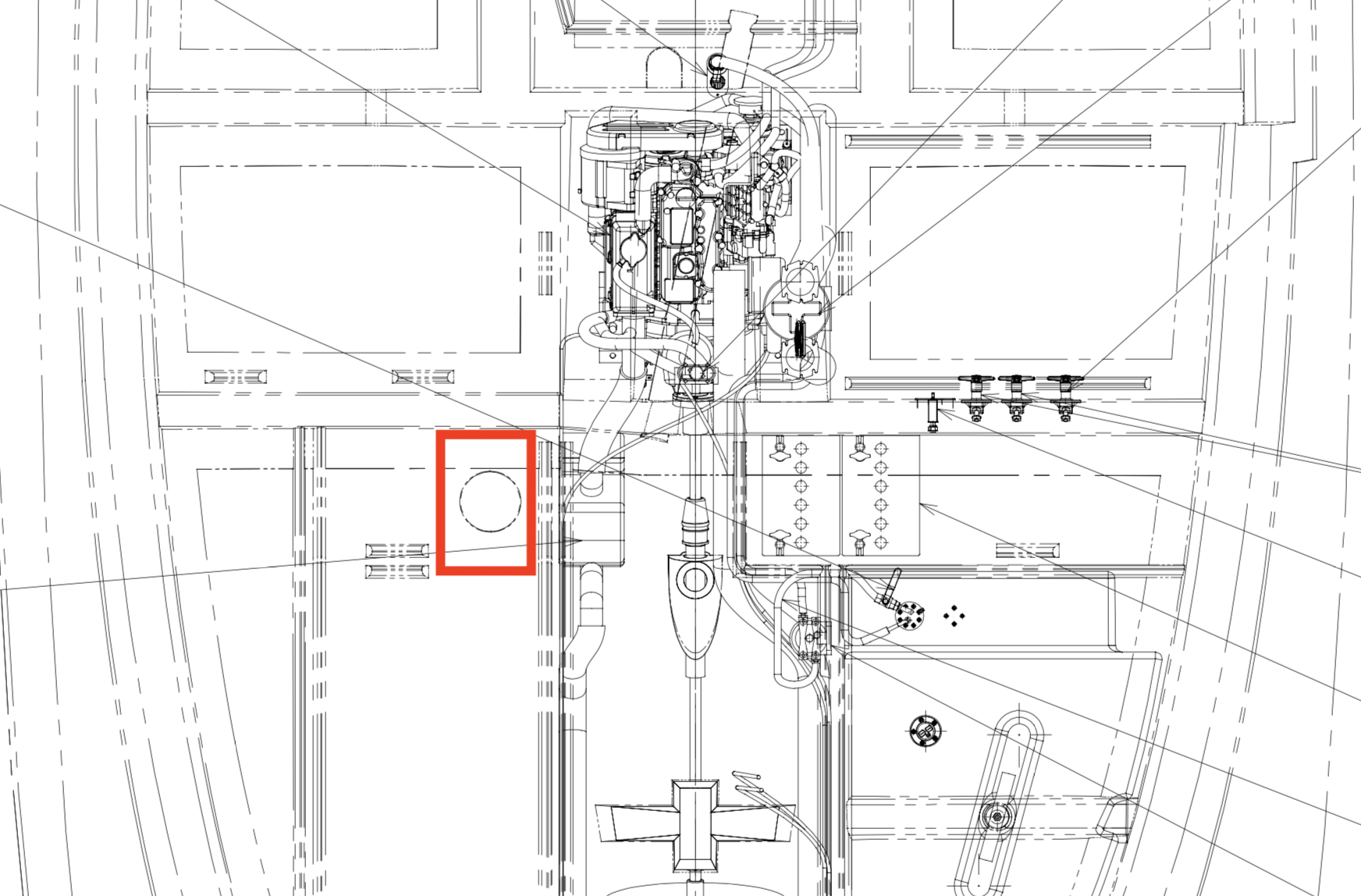

Hi Jorge and welcome I have a SO33i and it seems has a similar battery arrangement to your boat, I had a second 70amphr factory fitted in the position marked on your diagram, and like you limited in height for bigger batteries. I have added a third 70amphr battery in a battery box (no lid) alongside directly aft of the second house battery the battery box is screwed in its side to a wooden frame below the bunk. One thing I have to do is adjust the lengths of cable joining the batteries so they are all the same length. I have a 60W solar panel on the coach roof which is great for keeping batteries topped up over winter but not really big enough for fridge and the big items, its given me a taste for solar so now looking to get more probably another 2 x 60wats on the spray hood. I have a viltron ppt charger which a bit pricy but is very good quality and has bluetooth which allows you to set up for battery type and shows battery status and history. One thing to be wary of if you have a similar fuel tank shape to the 33 is the fuel gauge is not very accurate as it goes down slowly at firs then quicker at the end due to the irregular shape of the fuel tank. Best Regards Ian

Hi Ian,
Thanks for your feedback. I definitely need to upgrade my service battery (adding a second one) and will do that with time when arriving in Portugal. The fact that the SO33i has a battery in the place that I marked is promising for me.
I already have a long list of things to check, once in La Rochelle, prior to my departure, but I'll add that behavior of the fuel gauge. Tks!

Good luck with it all Jorge, I had the second 70 amp/hr battery fitted when boat was new but still found I needed more. I fitted a battery monitor display in the cockpit so could keep an eye on it when using the autopilot and nav gear and just found an alarm setting on my plotter which can be set to alarm off at a preset voltage which give a bit of peace of mind. It would be interesting to know how you get on with your batteries. All the Best Ian

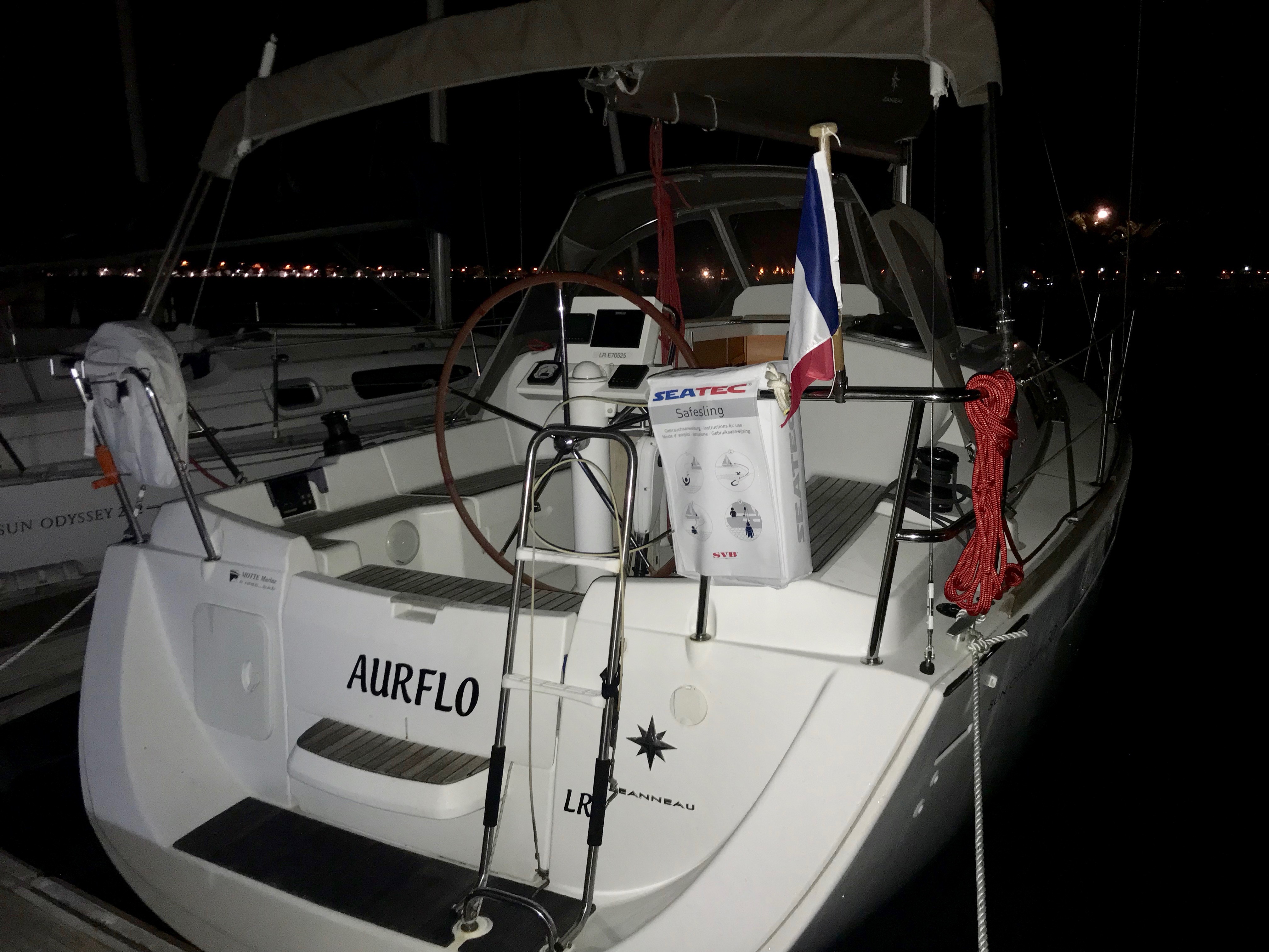

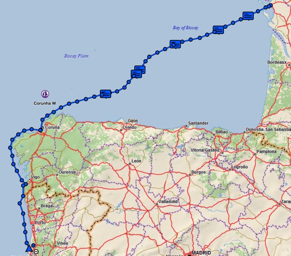

Hello, Sorry for this big delay in giving you feedback. Just like to share that after a nice crossing in the middle of April 2019 from La Rochelle to Aveiro (Portugal) I now can enjoy my nice boat (recently named Triinimar) All went well!!! The boat sails just perfectly in different seas and wind conditions. During the first 24-30 hours, we faced moderated seas and Bf 7 winds managing a good average speed for a 30 foot. The passage in a total of 600nm was made in the following legs: . La Rochelle to La Coruna (368 nm, around 74 hours) . La Coruna to Bayona (112nm, around 22 hours) . Bayona to Aveiro (120nm, around 19 hours) Regarding the boat characteristics, the main drawback I found is the location of the main sheet, which can easily hit a crew member during an accidental gybe. I already made some fixes to the boat, so if any SO 30i owner wants some details I'll be happy to share my experience. I'll try to post here some photos of the passage, hoping it will work. Safe winds! At La Rochelle (the day before) www.23hq.com/JFA_67/photo/56367841/originalIn the middle of Biscay Bay www.23hq.com/JFA_67/photo/56367871/originalSome waves and cold www.23hq.com/JFA_67/photo/56367892/originalAt La Coruna www.23hq.com/JFA_67/photo/56367912/originalA nice sunset www.23hq.com/JFA_67/photo/56367921/originalEnjoying a beam reach www.23hq.com/JFA_67/photo/56367940/originalJust arrived at Aveiro www.23hq.com/JFA_67/photo/56367954/originalThe entire route www.23hq.com/JFA_67/photo/56367960/originalRecently Beached in Aveiro (remember, its a lifting keel version) www.23hq.com/JFA_67/photo/56367962/original

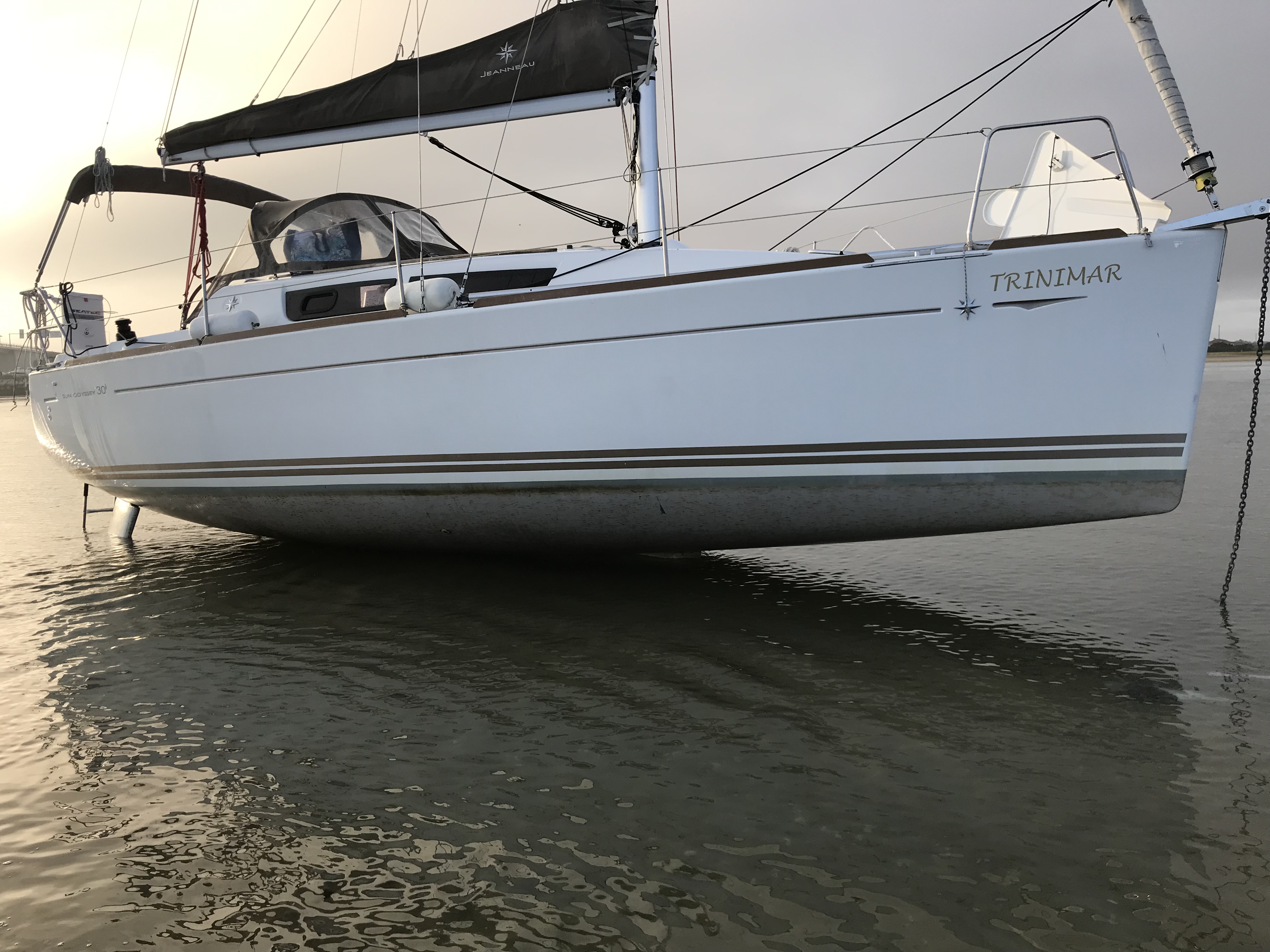

Hi Malcolm, Thanks for the instructions. Now I succeed in posting the photos. Just like to take the opportunity to reinforce the invitation of guysela, by asking owners of SO 30i to join the facebook group he created www.facebook.com/groups/358155278180074/

Hi Jorge, well done on a successful trip. It must have been quite an adventure.

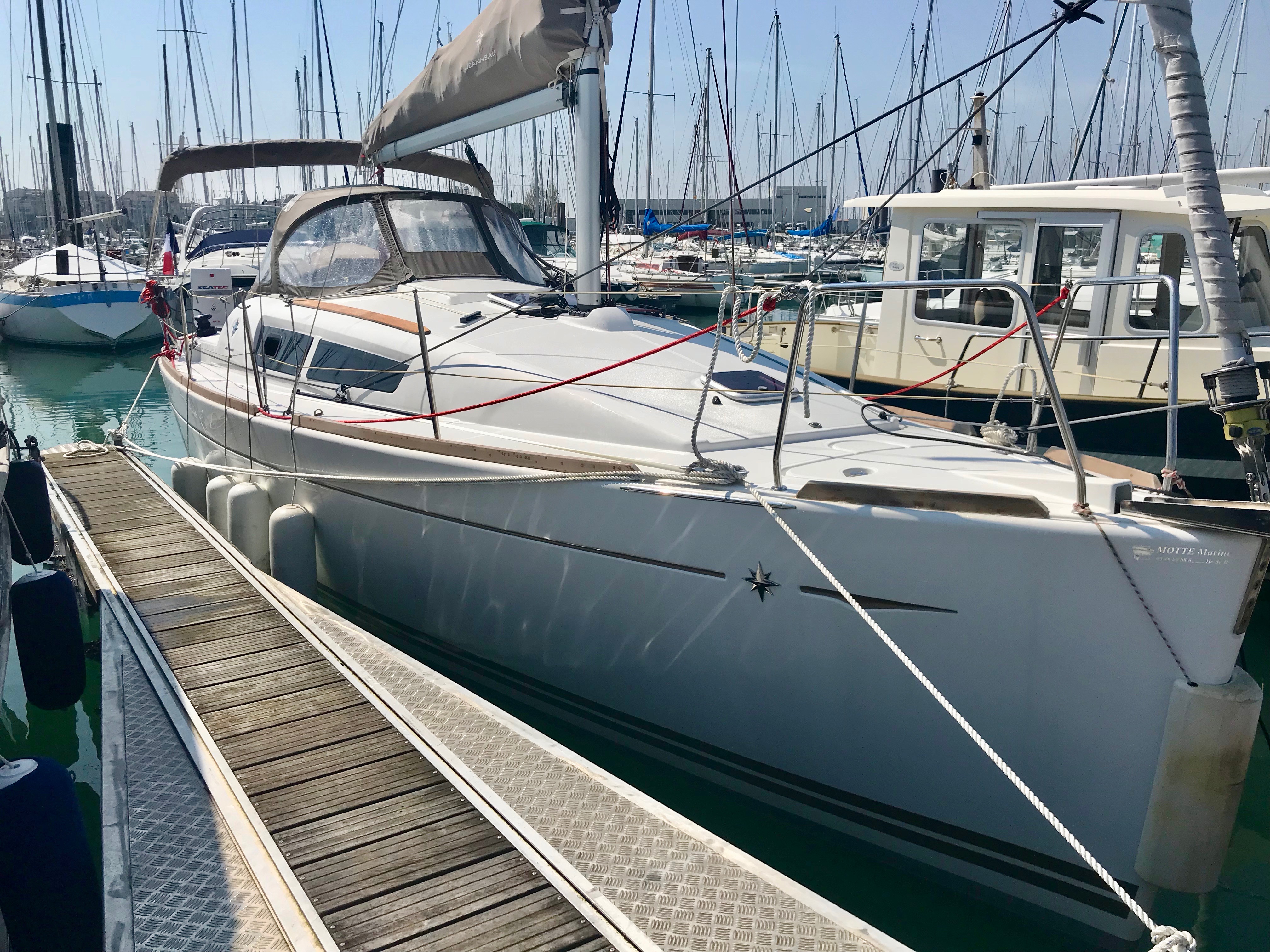

Thank you for the great photos. Seeing her tied up at the pontoon, she looks very familiar.
When you have some time it would be great if you made a post or two on the modifications you have made. We would all like to see what you have done.
I would love to see that last photo, of her beached. All the others have now come through fine.
