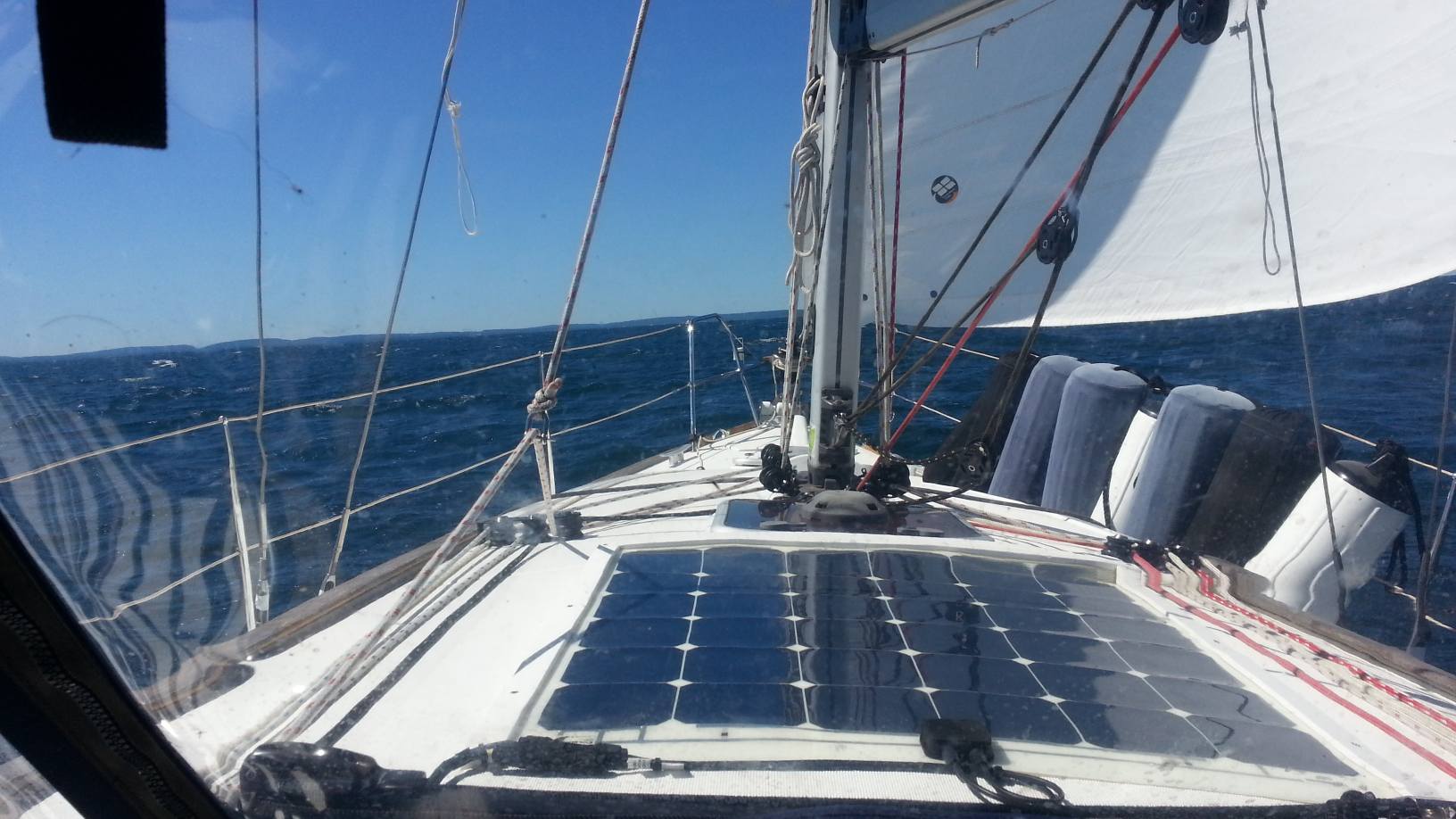

Hi......looking at fitting semi-flexible solar panels to Coach Roof of Jeanneau 379....anyone done this and can give advice on fitting method and any pitfalls..... Different boat model but yes hav done it - make sure you buy only panels with sunpower cells , lensun in HK are quite good - just ask them to produce with sunpower cells for you I installed my one with SS screws with thread inside and panels are fuxed with bolts tand this way I can dismount the panels fir the winter

Post by vasko on Jan 27, 2019 19:52:03 GMT

btw: I step regularly on mine and and no issues so far - Lensun quality is amazing
