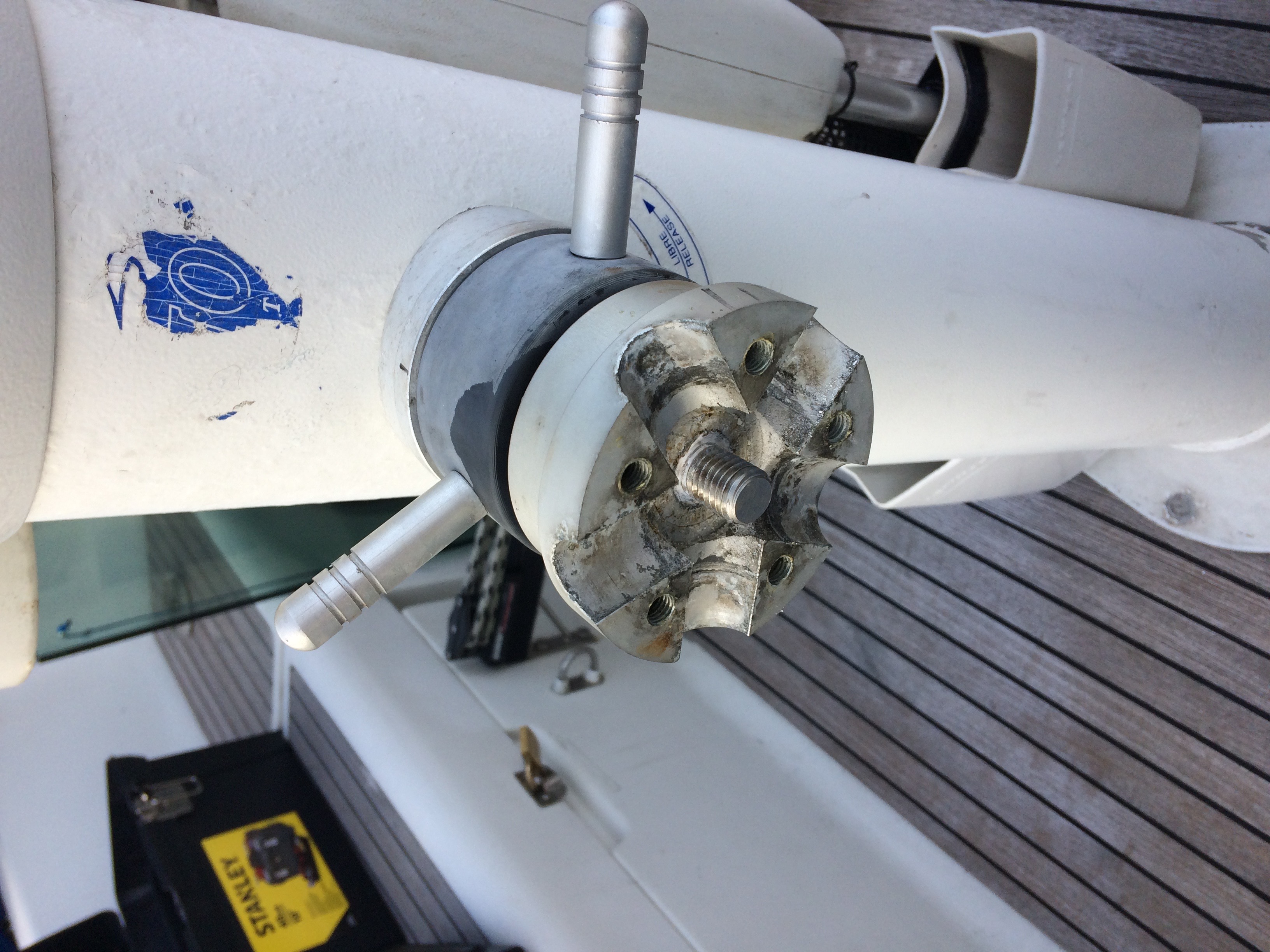

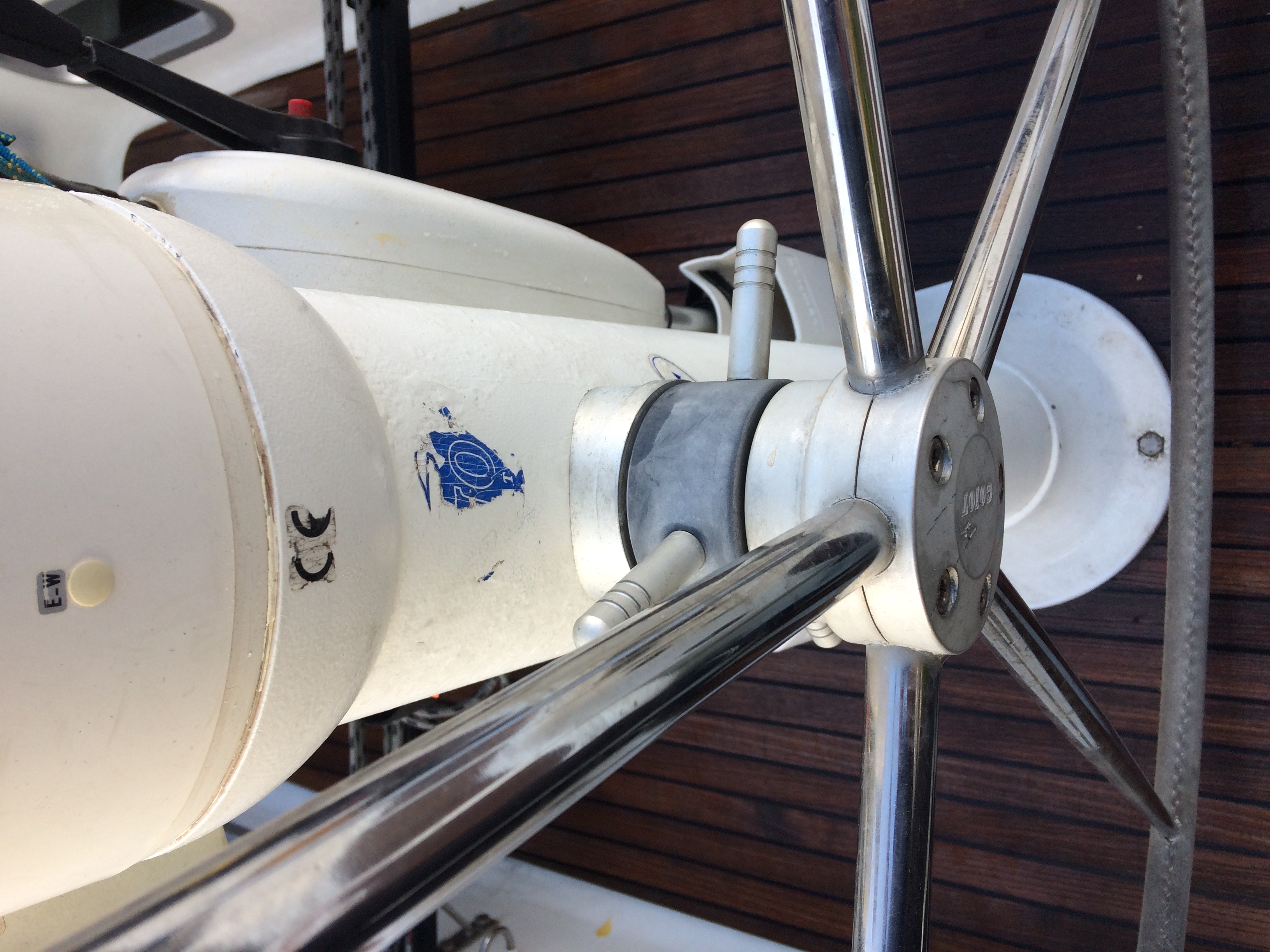

Hi I have a Sunfast 37 with Goiot steering pedestal / wheel. I am getting quite a lot of lateral movement on the wheel so am guessing the bush/bearing around the spindle/shaft is badly worn and needs replacing? Have taken the wheel off but am unsure how to remove the central unit that the 5 Allen bolts that hold the wheel on? I have taken the central nut off but the unit appears to be seized on. Any ideas? Wondering if I should use the wheel brake to lever it off. Is there something else I need to do? I am hoping once I remove the central unit that it will reveal the bush that I am hoping slides off, however if any one has done this or knows how to do it your help would be appreciated. Also you know where I can source a replacement bush/bearing? Thanks for your help www.23hq.com/AndyB/photo/50901093/originalwww.23hq.com/AndyB/photo/50901112/original

Hi the boss is on a keyed taper. only the nut holds it on. you will need a puller to remove it. you could try boiling water then re-assemble the wheel and try to 'rock' the wheel to release it. Once removed there are two screws behind the brake that attach the bearing holder inside the tube. On my SO35 these screws had come loose causing lateral movement of the wheel. Once tightened all was well.

Your pedestal looks just like mine, including the disintegrating Goiot decal. Use the brake to push it off. It works well. Take a look at the axle for the wheel and see whether any of the C-clips have broken. I have one that be broken, so that the axle moves slightly fore-and-aft, but not laterally. It could be that the lateral movement is due to slack in the wires, or in the chain that runs over the axle.
You will also have to remove the compass and the top of the pedestal, where all your electronics displays are mounted, to get to the interior of the steering mechanism. It is not hard, but there are likely a LOT of wires there, so try to be gentle and not distrurb them.

If you put the nut back on but only a couple of turns. Then put the cover over and systematically tighten the Allen screws that would probably push boss off the shaft.
Is the play when you turn the wheel or pull it for and aft?
If it’s when you turn then the likely causes are the woodruff keys or slack cables, hopefully the latter.
