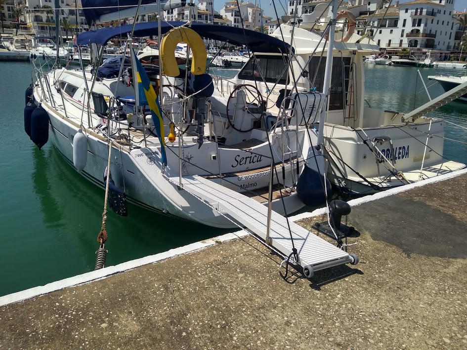

Post by MalcolmP on Dec 19, 2018 18:11:45 GMT
Our set up is similar to Vasko's I used an Osculati bracket, did have to drill an extra hole to increase the angle a bit from standard, good bit of kit that came with a reasonable backing plate www.osculati.com/en/11624-42.660.25/adjustable-bushing-(-30%C2%B0)We have been fiddling with getting the system to work over the past season since arriving in the Med. www.23hq.com/Jeanneau/photo/49783489/originalMain issue was as I fitted it off centre as I didn't think the steps would have been strong enough, but that meant that the side support guys only worked in one direction. You can see this from the photos, so I was having to tie the passerelle off on the quay to stop it swinging etc www.23hq.com/Jeanneau/photo/49783492/originalBut now have ditched the side guy lines and use a telescopic pole with small spi fittings which as a push-rod so the passerelle can be adjusted to almost any angle. This works pretty well. In my ignorance of Med berths I ordered a rather too long one... 2.5m, I now think 2.0 would have been enough at least in Spain, but may be useful when we eventually get to Greece. The one we have was made in Greece www.dakoutros.gr/wp-content/uploads/2017/11/exportproducts.pdfwww.23hq.com/Jeanneau/photo/49783495/originalI also initially used the topping lift with a bracing bar to support the end, but now have simple 6:1 tackles from the solar panel support, which is also much better. The above photo was taken last month as we are laid up afloat in Valencia. I now simply swing the passarelle across the transom, it fits fine and that also means no need to remove stanchions etc I also fitted larger wheels, which can be just seen in the photo above and also some sacrificial rub rails for when we moor to concrete breakwaters. The Oscualti bracket is maybe a bit low, it it was higher the passerelle would be at a better angle and the original wheels would have then been fine, but stepping onto the bathing platform would probably be more awkward. Finally saw this hydraulic Besenzoni being fitted to a 43DS, they had issues with the stern flexing as it is obviously very heavy www.besenzoni.com/passerelle/. Hopefully they ended up putting in some major reinforcement. www.23hq.com/Jeanneau/photo/49783498/original
