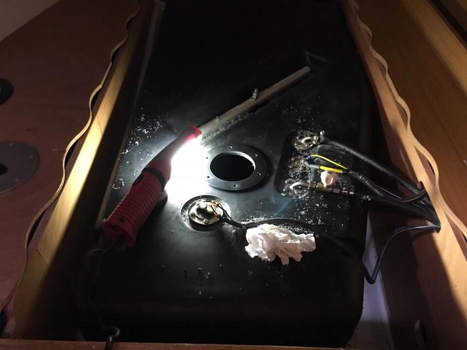

Post by georgia on Mar 6, 2019 19:02:57 GMT
I had a fuel contamination issue and needed to get a company to scrub the fuel and clean the tank on my Jeanneau 39i... the tank only had 1.5" largest access so I found a company that sells high end access ports for both metal and Poly tanks. So I purchased two and installed them to let me get full access to scrub the tank... my blog about it is here: captaingeorgia.com/blog/f/access-ports-for-my-fuel-tank

Question - what did you do to minimize the debris from getting inside the diesel tank when you drilled the stud holes and cutting the access holes?

Post by georgia on Mar 11, 2019 22:45:20 GMT
we used a vacuum cleaner to suck up as we cut and we cut very very slowly to make the least amount of crap. Then after we did both cuts, we scrubbed the fuel and cleaned the tank. side note: they've been in about a year now ... no leaks, no issues. (knock on wood)
