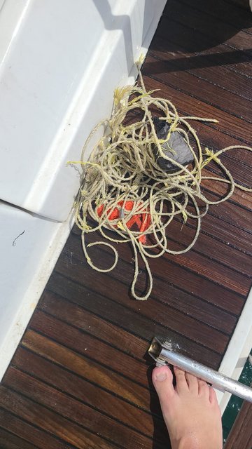

Hi there Yes, ultimately I used the Yachting monthly review in order to make the final decision, and I gathered that the Flexofold was the most complete for my needs. In addition their customer support was excellent, thus, I went for it. So far it has been on for 2 years and I am loving it, great investment I am now in the process of getting a "Gator rope cutter" (www.propprotect.com), as last weekend while anchoring at night I got entangled on a crab trap with a black floatie... and wasn't a pleasant experience being next to a cliff... Regards Andres
