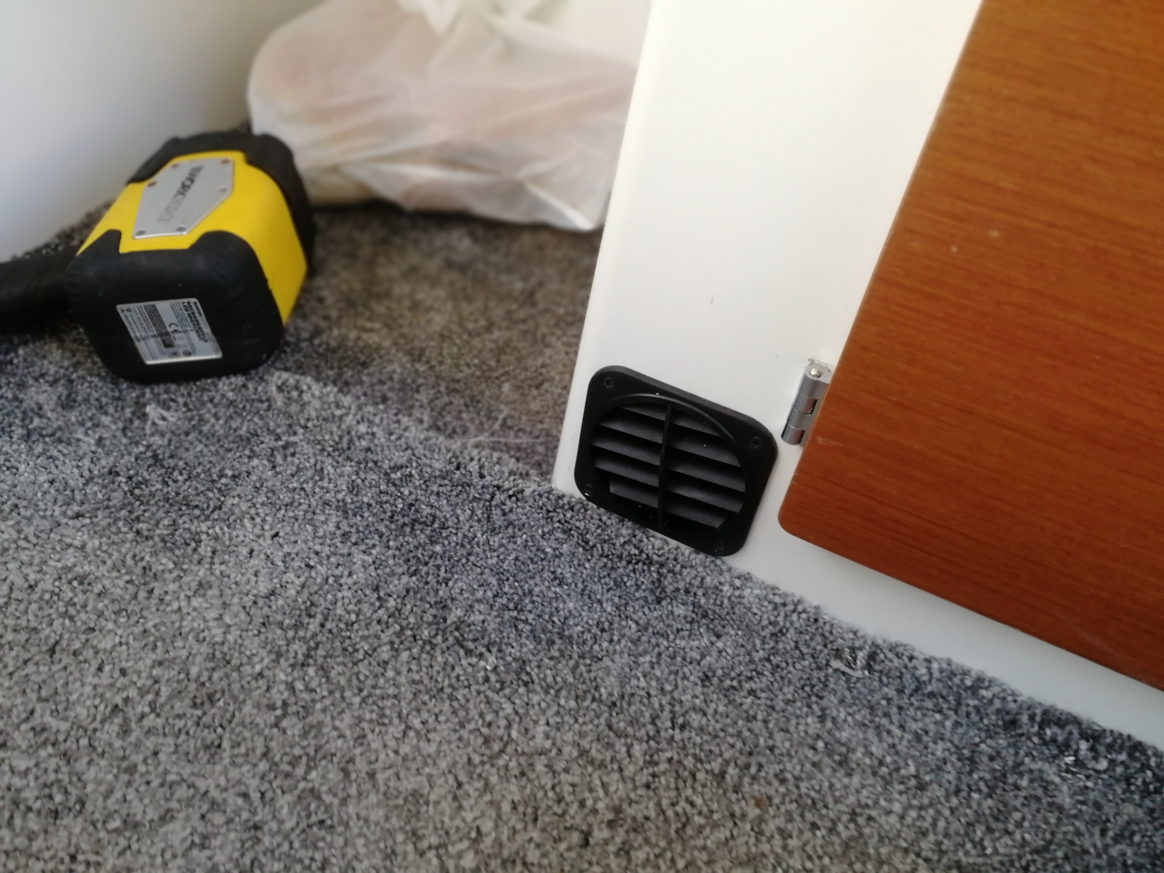

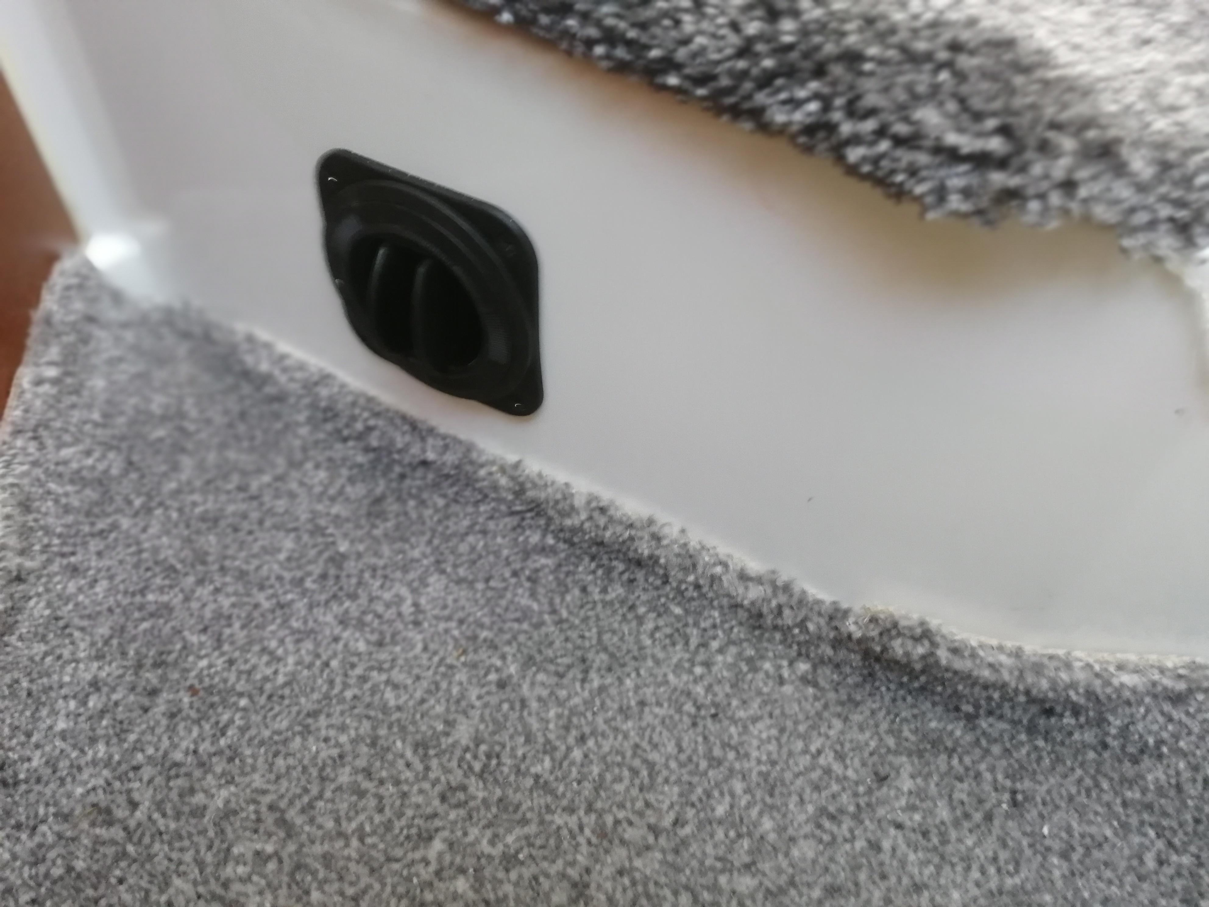

Hi folks In the end I didn't get any info re the heater from anyone. However I did make progress and managed to get one installed by a marine engineer. I am delighted with the outcome. A very neat job and took up a lot less space than I anticipated. The heater itself is a 2kw with 2 outlets, one in the main cabin andnthe outher adjustable one pointing to the sleeping quarters. The heater itself has been installed in the outside hold and the fan has 7 setttings. The higher the setting, the more power is used by the fan. So far we have had ig set at 2 or 3 in temperatures to -3. I have some photos but having trouble uploading at the moment The one concern is a general power one. The heater runs from the service battery along with the fridge, fishfinder etc. When i go fishing sometimes we can anchor up for a couple of days and this means the battery is a concern. As a result i am looking other options, one is to change the current leisure type battery with one of the new lilon type batteries that have a large capacity (see attached link) www.carplounge.de/en/loungebox-new ? Does anyone know if this is a viable option ?

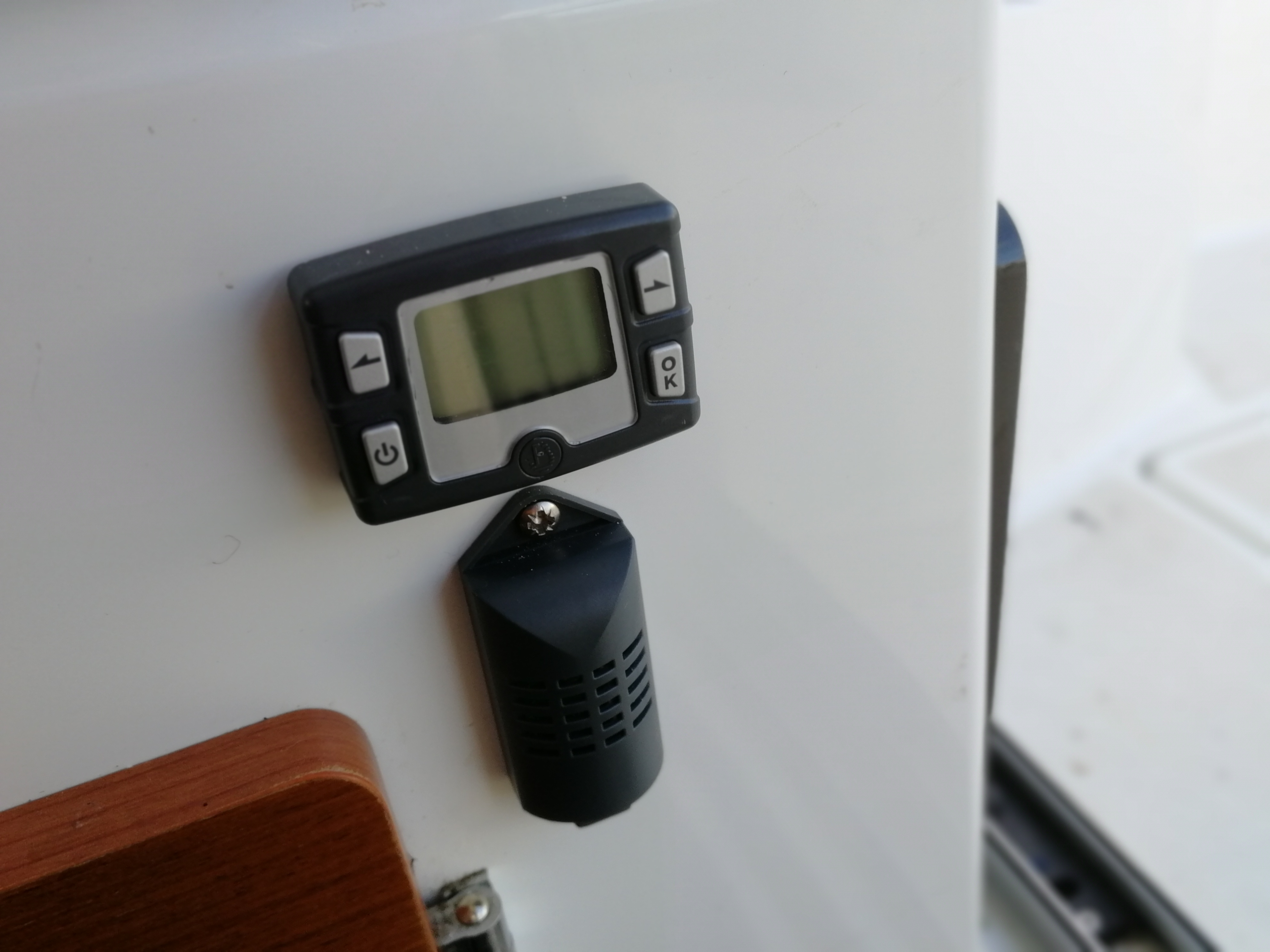

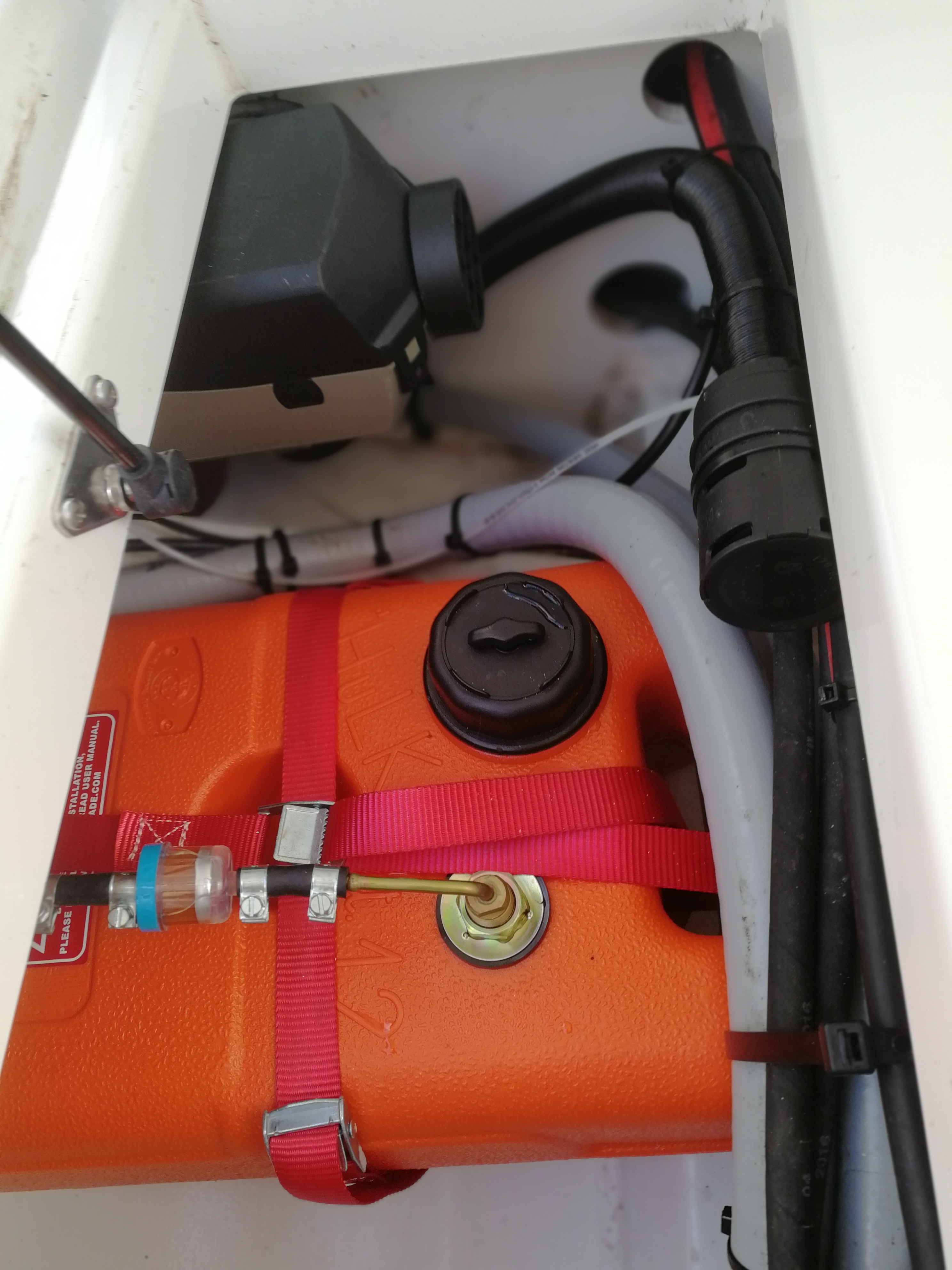

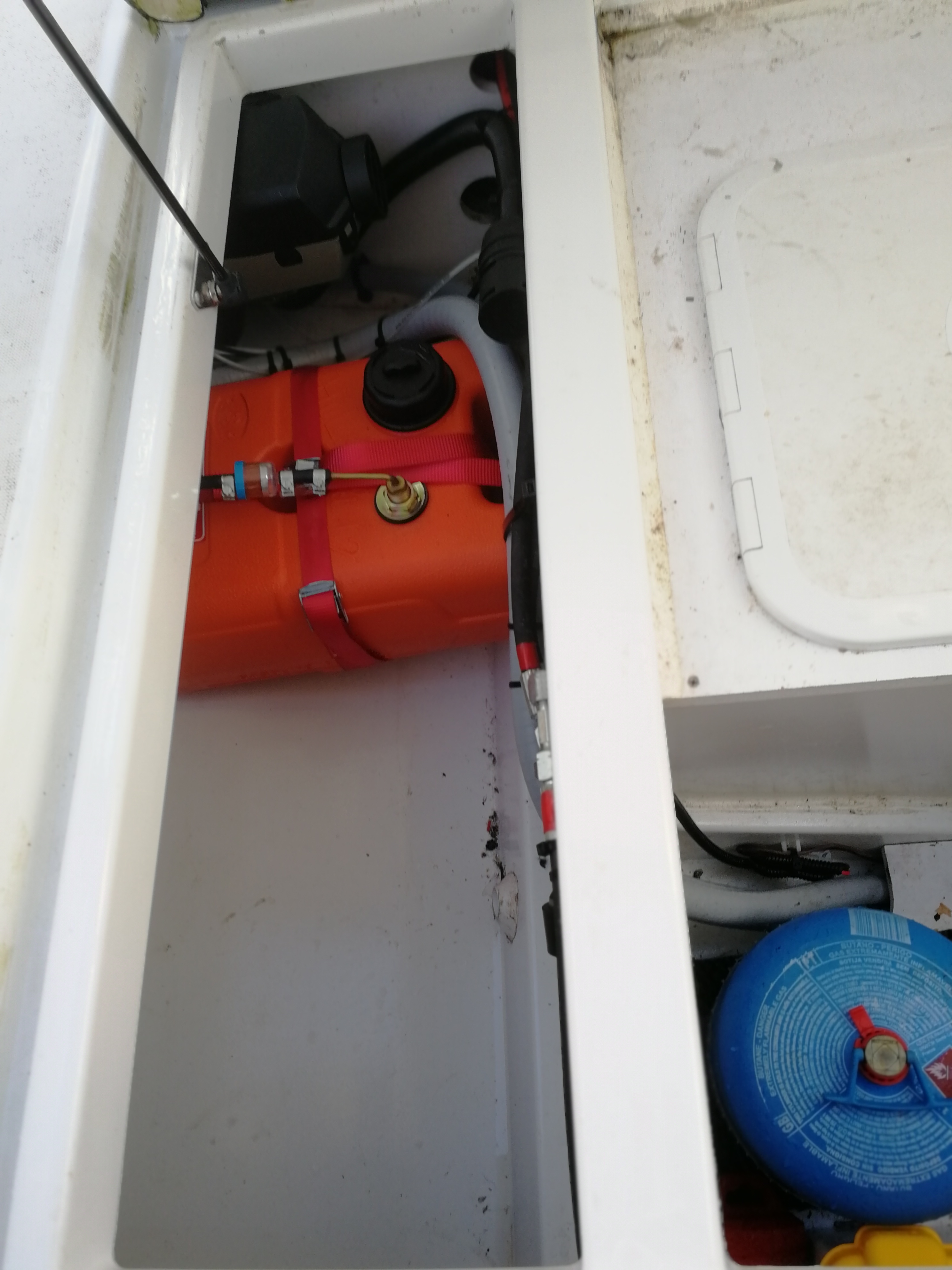

buff
Posts: 24
Post by buff on May 13, 2019 8:35:35 GMT

Hi Chris Can I ask is this the heater situated in the cupboard area under the sink on your 795? Where did you put the fuel tank for it? We are a bit nervous about putting the heater in the main cabin area because of the outside chance of CO leakage etc. We have a 755.

I have added diesel heater inside the narrower compartment adjacent to the fuel tank compartment on the starboard side of my 795. The heater is placed on a narrow flat surface found deeper near to the hull. In this way, you dont see the heater when you open the lid and save space. All you need is to prepare a U shaped piece first to mount your heater's metal attachment on. The diesel tank is placed in same compartment further to the back of the boat. The tank is from steel. It is also given a V form to the space provided. Capacity is about 18 liters.
