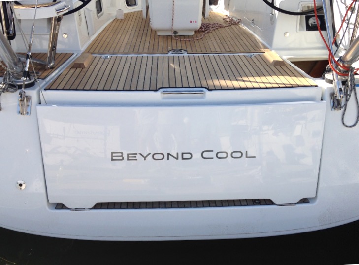

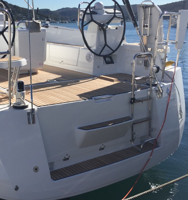

I just realized, that transom panel is just decorative cover, you can see it from the image. Hi Goody and Ania, How did you get on with the stern "cover panel" - seen here under the folded aft cockpit floor into the lowered "swim platform" position. I guess you have worked out that indeed as Ania mentions above - it is a cover panel only. I am not surprised it flexes/ cracks if you deploy the swim ladder while the terrace is still in the up position. I don't know if the Jeanneau designers thought that the ladder would be used other than when the terrace was in the fully down position (and the cover is underneath as in this photo). I can imagine cases where you might want to get in/ out of the water with the terrace up ... although I expect the ladder would be short and hardly extend into the water like it does when used in the terrace down position. When the ladder is against the cover panel with the terrace up there would be quite some leverage applied to the "legs" of the ladder in the weakest part of the cover panel - if it is to be used in the terrace up position I believe it would have to be strengthened in some way like vertical and horizontal mini fibreglass beams as the panel is only about 8mm thick gel coat and glass mat. How do I know this ??Well we decided not to go for the terrace option for a number of reasons and instead before the boat was finished I decided to buy the "panel" as a spare (these stern panels on various models are spares because people crack them by running into wharfs etc.). - We had the "cover panel" shipped out loose to Australia with the boat and we are nearly finished with the mods to the standard stern section (that you get without the terrace) so as to accommodate the addition of our rebuilt "panel" into a fold down swim platform like Hanse and Dufour have. - The panel was a shell only - very light and little strength as it was only ever meant as a cover piece. We had to build it into a platform with the strength to not distort or break with Al channel "beams" and carbon layups - we needed that level of sophisticated build because the resultant "platform" could not be more than 35mm if it was to work and align with the back of the cockpit floor. When all mods are completed I will post some pics - See BEFORE and AFTER (nearly finished) pics below. And although your panel doesn't need that level of strengthening because you wont be standing on it .... it will need some beefing up so prevent deflection and gel coat cracking if you are going to put the swim ladder "legs" against it when the terrace is in the up position. Cheers Mark www.23hq.com/MarkClement/photo/43163792/originalwww.23hq.com/MarkClement/photo/43163901/original

Hi Mark, yes that our boat before a few additions, thats Mandy and i downstairs in the video. We ordered the stem fitting afterwards from Jeanneau and it has been retro fitted, i will send photo of that and also the code 0 when we test it out in two weeks time.
