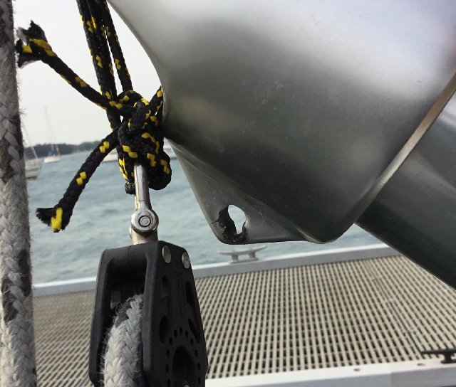

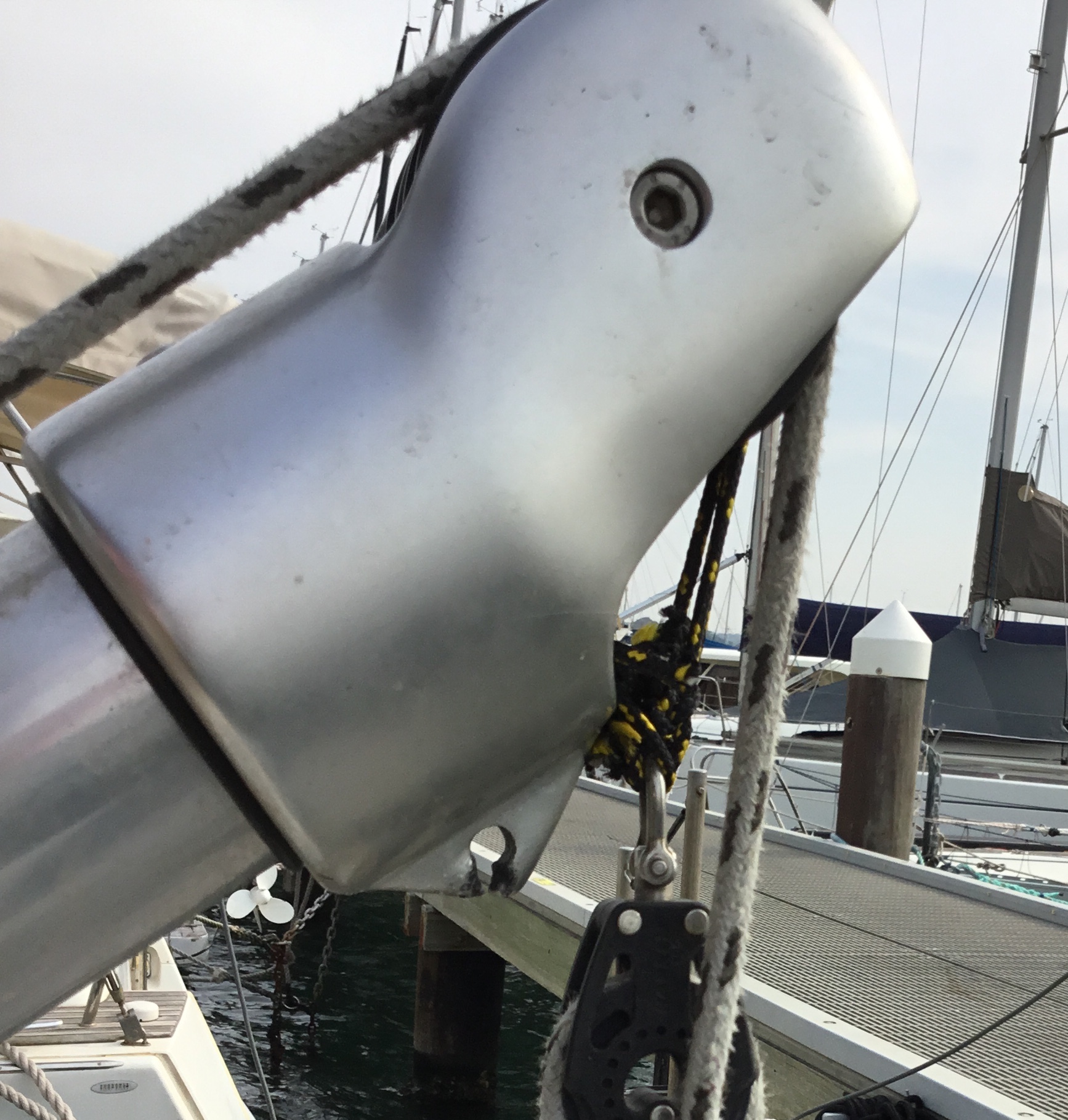

Hi all with folding davits on the J51, Just returned home after a month in Japan to find out a friend at our Yacht Club marina had to secure my inflatable when an anchor point on the davits failed on the starboard davit. I discovered the port one was also close to wearing through. - Hull #11 and has had the AB RIB on the davits since commissioning in early August 2017 - 28 months. - AB Lamina RIB 43kgs - Tohatsu 9.8 hp 2 stroke weighs 26kgs but it is only on the RIB when at our destination - est equivalent to 4 months over the time we have had the boat when the davits have carried 80kg (10kg fuel). - I installed the pulleys and lines myself as they were bundled in a plastic bag in the cockpit locker and it seemed obvious to install the pulley with the shackle into the cast “lug” that is part of the sheave head casting at the end of davit. You can see the starboard “cast lug attachment” wore completely through and dropped the AB some 70cm until the dislodged mini - block jammed into the blocks on the dinghy strop. This will obviously happen with every davit you guys have if you like me had a s/s shackle moving in a Al lug - it might take longer depending how often you have your dinghy on the davits and how much movement you get (our marina does get waves causing the dinghy to swing slightly) - but it will happen. Bit annoyed at myself - a retired metallurgist should have realised that a forged s/s shackle pin was always going to wear through a cast aluminium lug ... but then the davit manufacturer definitely and maybe Jeanneau should have also realised this failure was inevitable. Regards Mark www.23hq.com/MarkClement/photo/62478893/originalwww.23hq.com/MarkClement/photo/62478871/original
Post by rene460 on Nov 22, 2019 9:58:55 GMT
Hi Mark, it looks like that aluminium cast fitting did a good job of protecting that shackle! A bit like the electrical device that protected the fuse by blowing first that I read about once. I guess that it did not require waves, just rain water and the salt that is always in the air would do it. But always surprising how little time it takes.
Not immediately obvious how the block should have been attached to have the required insulating properties combined with the required wear resistance in that or any similar application. Tef-gel would not be much help there.
I will be interested to see your solution, but I think I would be inclined now to bend a stainless strip around the Davit end, (a bit like a hose clip with its bolt through the remainder of the hole). The lungs of the band could be long enough to be drilled to hand the shackle. All installed over a plastic tape to insulate the band and Ted-gel on the bolt. What ever it takes to provide the insulation and avoid wear between the different metals.
Good to have neighbours in the marina who will do something helpful when such things occur while you are away.

Idon't think i have this problem. I have not however inspected these anchoring points recently. Whilst in the med we tend to tow the dingy a lot without engine. Stainless steel shackles were definitely in the kit for installing pulleys rope etc. My problem is i have broken the casting just under the deck where lugs on the bottom of the telescopic part recess into the 2 operating positions. Trying to find a parts list for them is proving difficult. Jeanneau not being helpfull yet again. David

Hi Mark, thinking some more about that davit block hanger, the nearest comparable arrangements on my boat are the topping lift which attaches to the aluminium boom end fitting by a SS shackle and the pins in the gooseneck end boom fitting. I sure many other boats have similar. Come to think of it, there are similarly supports shackle arrangements on the job furler.
The main difference I can see is the black coating on the aluminium. I don’t know what it is, but it clearly provides the necessary insulation as all seem good after nearly ten years now. The load on the topping lift shackle is probably quite low compared with a dingy, as the weight of the boom is largely taken by the solid vang. I also attach the main halliard shackle to the same loop when not sailing, so the load is divided. But loads on the gooseneck pin are high, at least when sailing close hauled.
There have been the odd reports on the forum in the time I have been following of gooseneck pins showing severe wear, or was it corrosion? But it does not seem common. But perhaps it indicates a thin insulating sleeve on the shackle pin might be enough.
I suspect this topic is a common arrangement on all models. A pity to have it lost in this 51 specific thread. How do you feel about suggesting to Malcolm that we split it out to a separate topic?
Post by johannes on Nov 23, 2019 9:27:52 GMT
The anodisation on the boom fitting wears off quickly where you attach a shackle, so I don't think it provides any protection. In this case I suspect it is just different qualities of aluminium alloy. The boom end fitting being much harder and wear-resistant.
